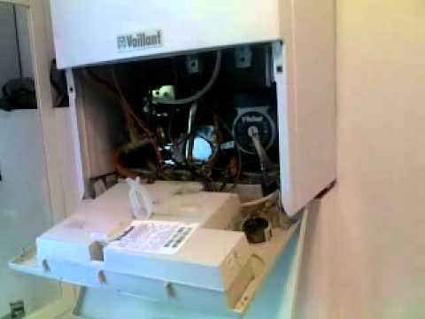

I have a Vaillant TurboMax Plus 837E & it's leaking from the connection to the pump, I have attached photos. Does anyone know how to fix it?
Here are the images: Imgur
It s leaking from the copper pipe connected to the pump.
very common auto air vent has failed

You can see the water on the top of the AAV in the posted photos.
Jazzy - tighten down the little cap on to stop the water leaking out, dry it out with a cloth to check it has stopped & then do yourself a favour & call a Vaillant boiler guy.
