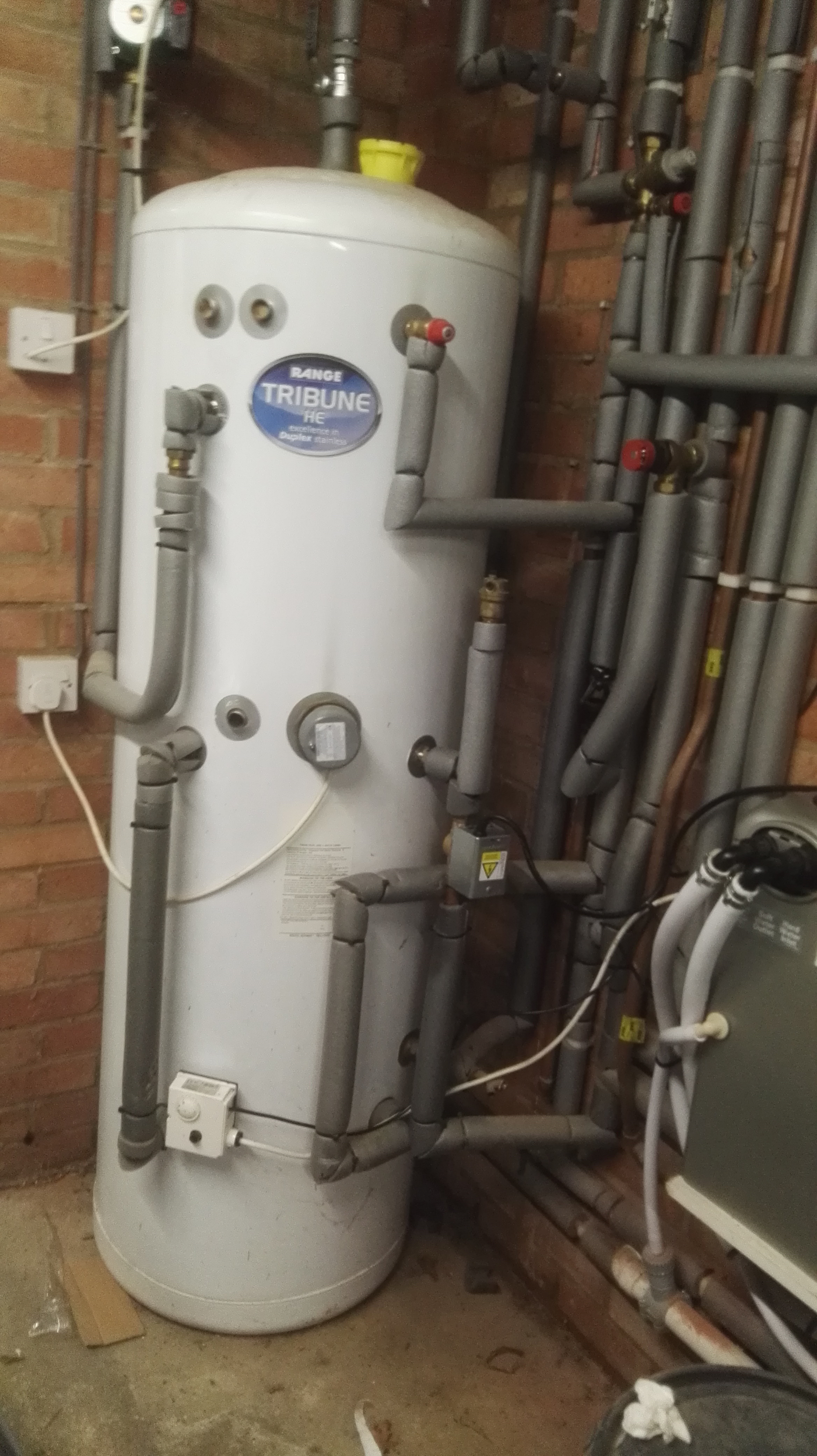

The heating system is a Worcester Bosch Greenstar 30 CDI System. The property is a bungalow with the boiler in the garage. There is a hot water storage cylinder in the garage which has a zone control valve connected to the Honeywell system.
There is no longer any zone control valve on the radiators relying on the Honeywell valves to control the water flow. There are 12 Honeywell valves. The pipes initially go down from the boiler and then up into the garage ceiling. There is an automatic bypass between the flow and return. The pipes run from the garage into the bungalow ceiling and then down through an airing cupboard into the solid floor and then are distributed to the radiators. There is a separate pair of pipes that feed the bathroom towel rails. These have never had a zone valve but the other radiators did originally have a zone valve controlled by the CH thermostat.

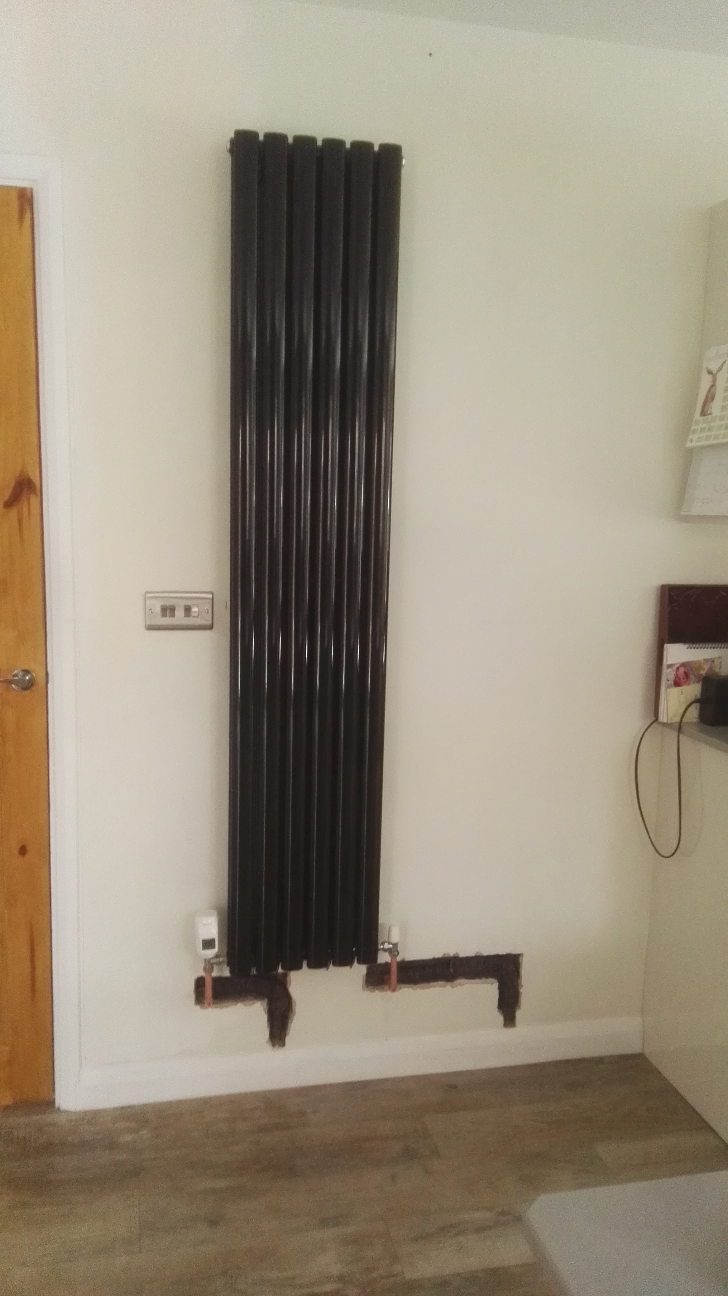

In preparation for having the kitchen refitted I have just had the kitchen radiator (last Friday) replaced with a narrow/tall one and moved about 40 cm sideways. The original TRV body was re-used but moved to the return side rather than the flow side. The system was partially drained to change the radiator. Initially no water was flowing and the installer had to close all the other radiators off to force the water to flow to the new radiator.
I now have the new radiator working properly BUT when the Evohome starts to shut down the radiator (having reached the set temperature) there is a VERY loud noise coming from the radiator and pipework. the pipes in the airing cupboard are vibrating quite violently. The same thing happens when it is opening up again. The vibration can be started and stopped by slightly adjusting the TRV. I think this mainly happens when most of the other TRVs are closed and the kitchen one is only partly open. I assume that the boiler flow is running through the automatic bypass.

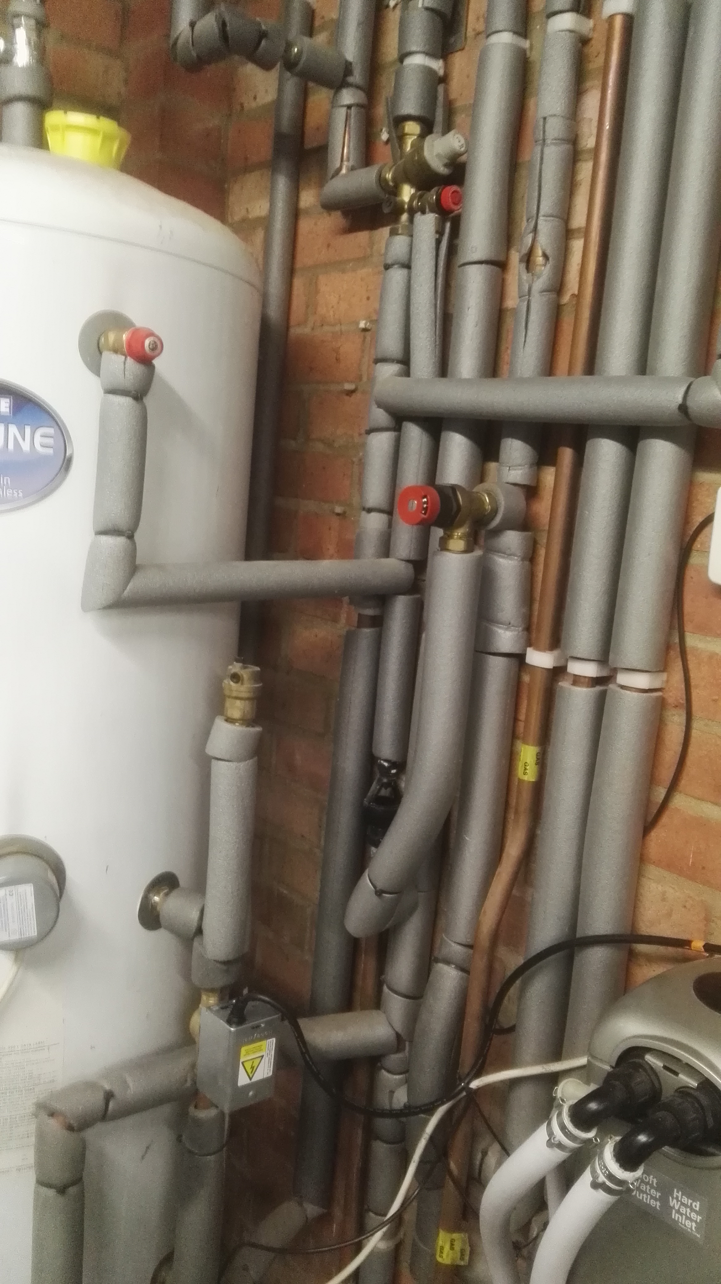

Also when those valves,were installed, an automatic bypass valve should have been fitted.
After looking at your pic. You do have a bypass valve.
So it’s probably valves fitted on the return.

I have found a diagnostic status report on the Honeywell Evohome controller which might help someone to shed some light on my problem. If I have understood the display correctly it shows how far each valve is open. On all radiators, apart from the kitchen one, if the percentage is low some water flows and this seems to increase as the percentage rises (judging by hand and estimating the difference between flow and return temperatures).
The kitchen radiator however behaves differently. There is no flow if the percentage is below around 25% to 30%. If I turn the dial, both flow and return pipes start to get hot, and then the vibration starts. If I turn it up a bit more (3-4 clicks) the percentage displayed changes to 100% and the vibration stops.
Is this a red herring or does this help to pinpoint where I have a problem?
Note that the TRV body is not new and it is not a Honeywell one - it was moved from the previous radiator but was transferred from the flow to the return to assist with the kitchen layout. I have other radiators that are behaving correctly, with the same TRV bodies, with the TRV on the return. The hall radiator for example.

I have now removed the Honeywell actuator from the TRV body and used manual control to adjust the flow. Moving the manual control from closed towards open I can start the loud vibration and continuing to open the valve it stops again. The movement on the manual control ring is about 1/8 turn.
I then tried all of the other TRVs on the heating circuit and found one other that created a noise. The others would silently move from fully closed to fully open.

The bedroom radiator that is also making a noise and causing the pipes to vibrate is already on the flow side.
I have at least one other radiator where the TRV is on the return and that is working silently.

Some TRVs are designed to fit on either flow or return indifferently. Others are designed ONLY to work on the flow and will not function properly when on the return, and a third type can be fitted to either but there's a collar you have to rotate depending on which way the water is flowing.
There was a vibration from the heating system before the kitchen radiator was changed. I believe the heating engineer probably reused the TRV body and moved it to the return rather than the flow. This was to allow more options for the new kitchen layout.
