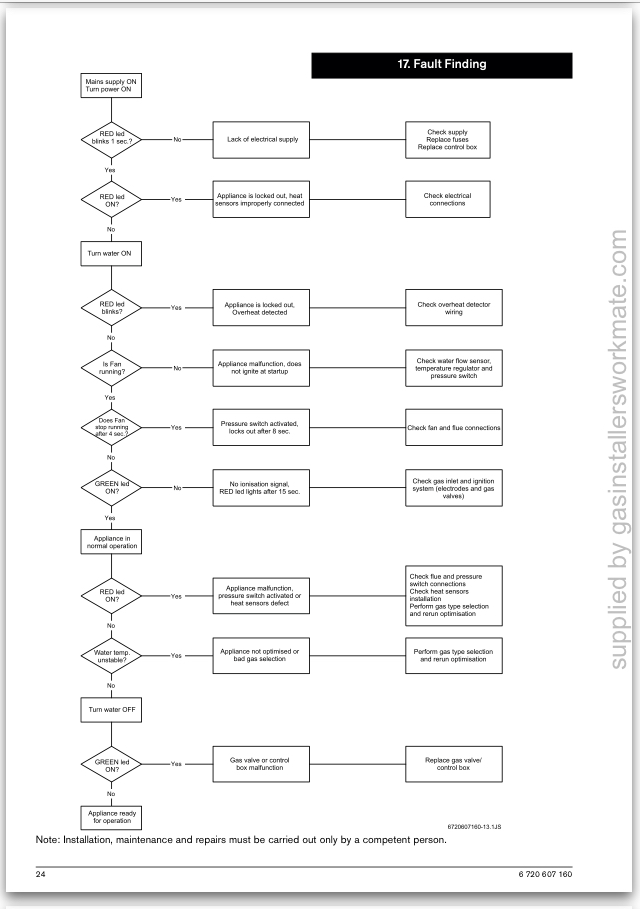

Hello All
Problem with the above named water heater.
Red light comes on every 4-5 secs. No hot water operation. When you reset the heater the green light comes on briefly and then the red light starts doing it’s thing?????
Any ideas ?
Hello All
Any ideas ?
I’ve attached the fault finding diagram for the main multipoint ff.
Using the diagram you’ll be able to sort it.
Please update us.
