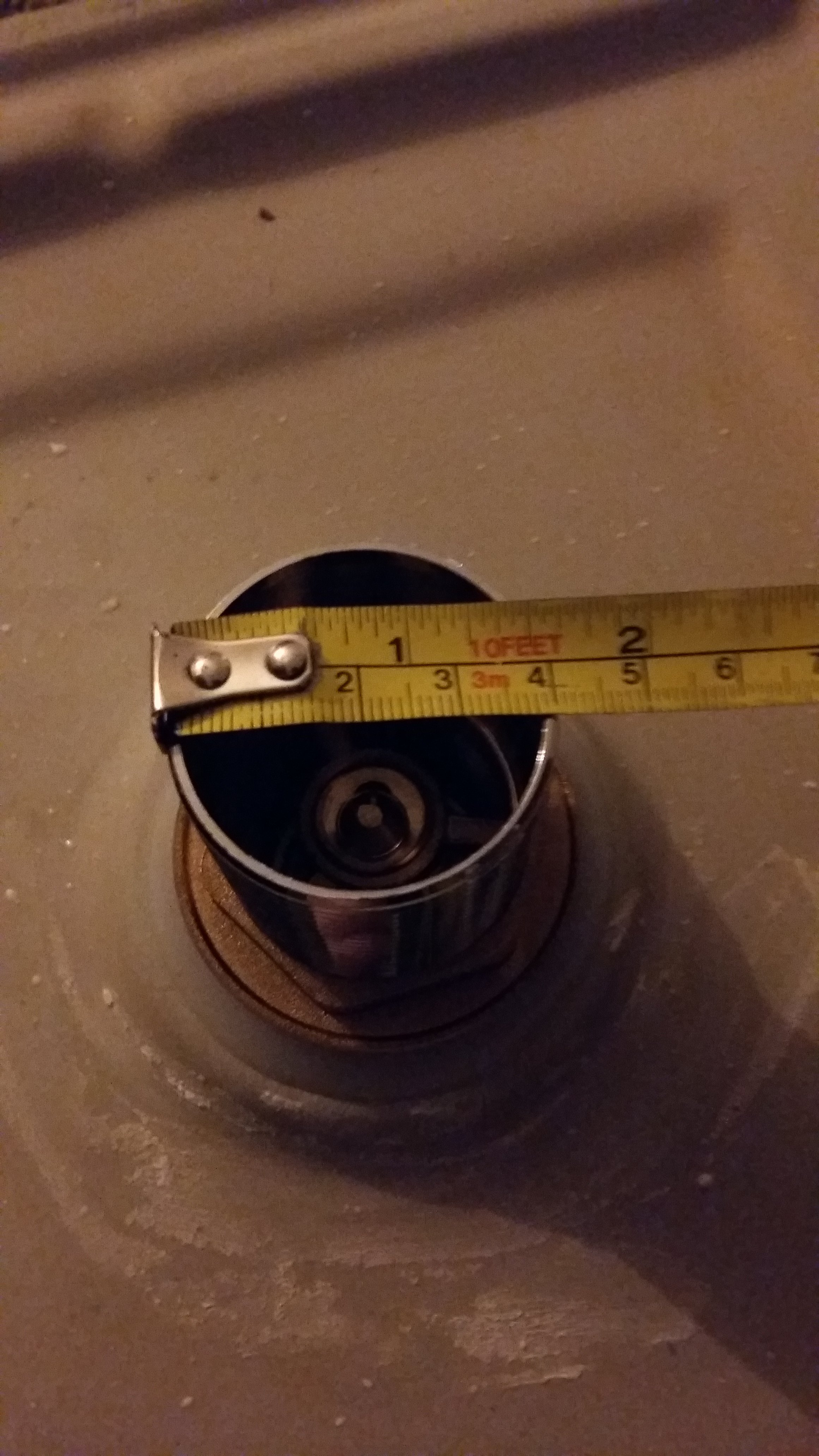

Apologiesfor the awful pic the waste is threaded so no problem there .
Unfortunately I have no other option but to share the same waste pipe as the bath , luckily it's only me and my partner so the basin and bath won't be used at the same time, thanks for all the help so far folks
I would never share the waste as my first choice, but in a retrofit, it can be done. You may need to use anti-siphon, resealing, or waterless traps if there are issues with traps being sucked dry. They may be noisy, but they do work, after all.
Now I can see the threads - just!
