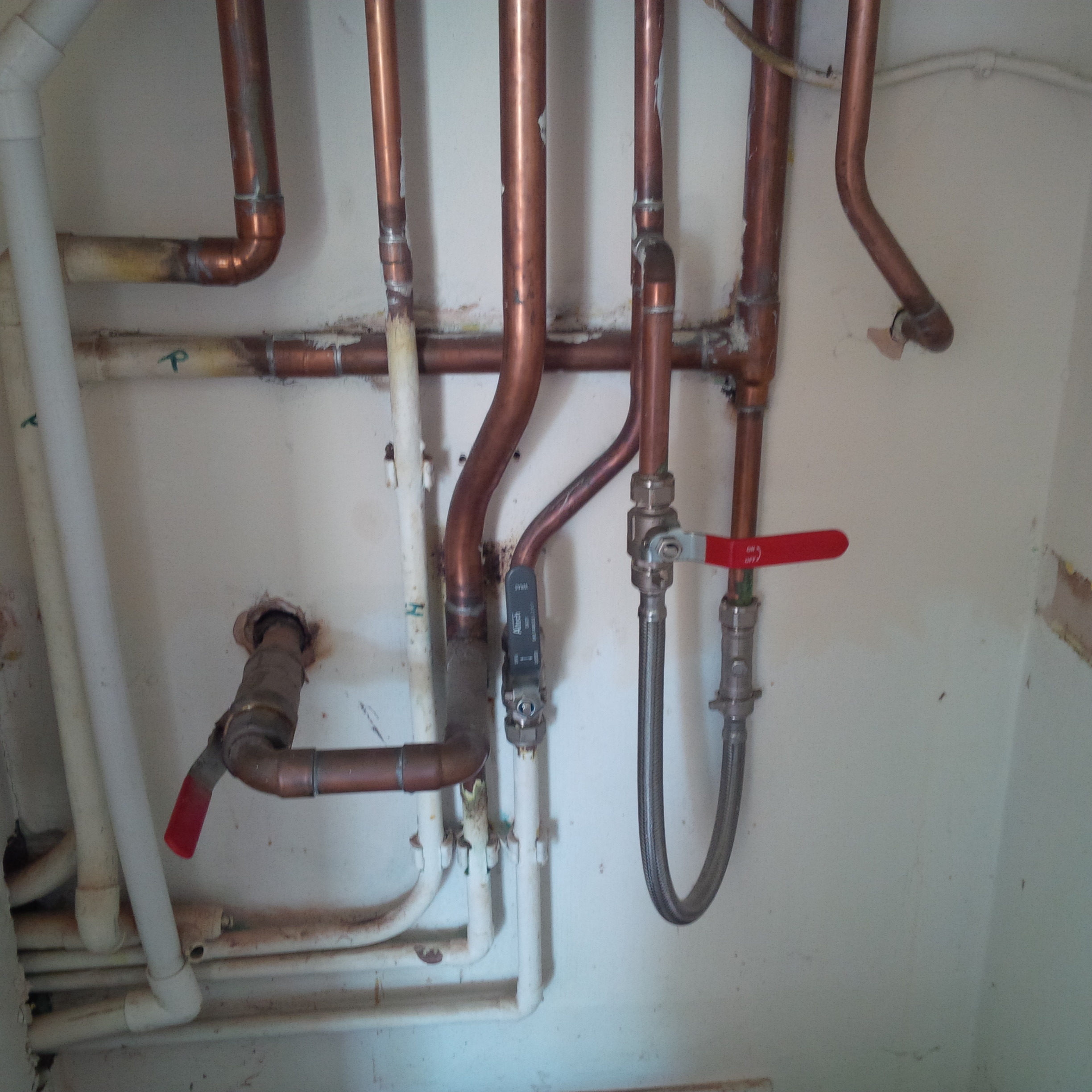

I've just bought a flat and finally after getting the electric connected, I went to fire up the boiler. The water and gas was turned off so I turned the water on at the mains and also two leavers, one red, one grey, on the water inlet pipe to the boiler which seem to be on a loop.
I can hear water rushing through and then the next thing there is water rushing out through what I'm guessing is an outside overflow pipe. I'm on the second floor so it was pretty loud. If I shut the grey leaver off the overflow stops, but then so does the water to the taps.

dont open any valve that is connected to a metal braided hose, as thats the filling loop
oh sugar, I think the grey lever was connected to a braided hose.

When I actually turned the boiler on, it was at 2-3. Looked too close to the red and with all the water gushing I turned the boiler off and turned the grey lever to off as well. One thing I noticed was if the grey lever (which is the one connected to the braided pipe) is in the off position, then there is no water coming out of the hot tap.
I will get photos and detailed notes in the morning and try and post on my phone.
turn the ones with a flexible/ braided hose off
Sounds like have left the filling loop open on the heating circuit side of the boiler so the water is going straight in the boiler and over pressuring and coming out of the saftey valve , as shaun said reduce the pressure in the system to 1bar through a drain point on a radiator , when the cold inlet valve is switched off via the valve connected to the braided hose it should allow cold water to enter only when the hot taps are turned on if not check the valve is in the right position, regards kop

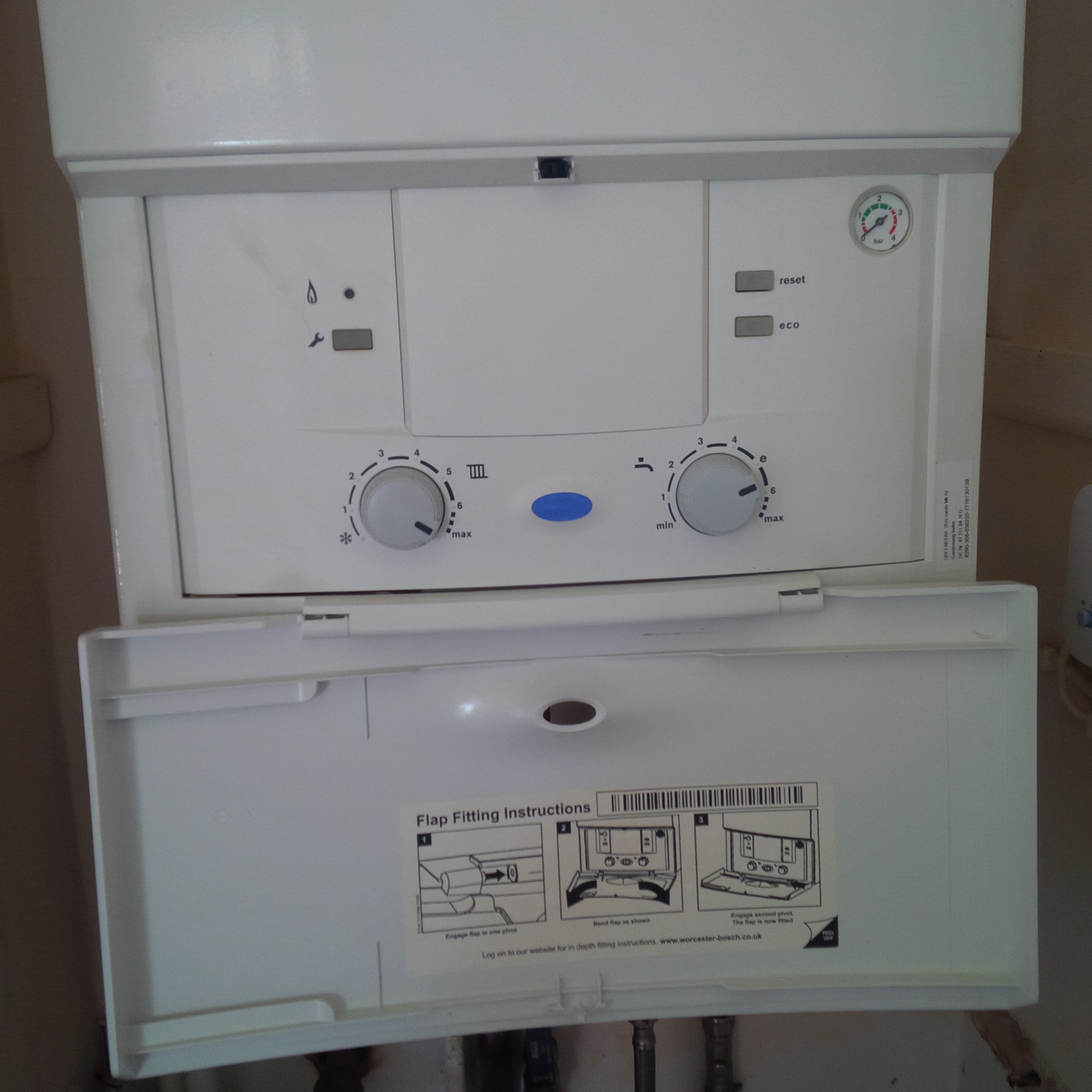

Ok so here's the update :) turned it on at the switch, pressed reset and the ignition light came on AND I had hot water (yay!). However, the gauge is reading 0 bar and in the red even when the water is running. Not sure how to work the CH (for the last 20 years it's been a log burner, so moving into the 20th century is a bit of a jump!) so maybe it's to do with that? RF Thermostat isn't working, it might need new batteries. Off to get some. IMG_20170422_112157.jpg
Any chance of a pic of the gauge as hot water shouldn't effect the position
When you open the red lever (attached to the braided hose) does the gauge rise at all ?
Yes it does. Should I open it incremental? Just opened it until it hit 1.5. Have CH on full blast and rads are warming up. Fingers crossed.
Slowly and once it's at 1-1.5 when the heating hadn't been on turn the valve off
And then look in about an hour is there a pipe dripping outside below the flue (copper pipe)
