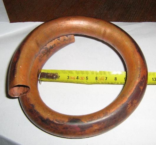

I need to bend a 22mm class I pipe into a full 360 degree turn. I need the inside diameter of the bend to be a nominal 95mm. I'm hoping to avoid making up specific tooling because of the expense and wondered if anyone had any ideas how I might do it.
I have available a standard plumbing type 15/22mm pipe bender which will produce a finished radius of about 100mm so it's a starting point at least. I also have some bending springs and the usual general workshop tools. Any thoughts greatly appreciated.

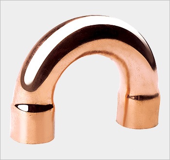

you might get a u bend but without rollers I doubt you would get a full 360 back over its self.you could call cylinder manufacturers and ask if they would make for you

I need to find a way to do it by hand really. I was considering bending it 360 first with the hand bender then annealing the pipe then packing it full of glass beads or even sand and welding the ends closed, then attempt to work it by hand into a tighter circle. Yeah, I know it's probably not the ideal plan hence my quest for advice.
It's a component for a coffee roaster I'm making by the way. It will be visible so I need it to look half decent once I've finished bending it.

Anneal it, fill with water, freeze it, bend around somthing the diameter you need. Then reform the shape with hammers. Or force 1/2 ball bearings through to reform.
Interested to know if the annealing and bending works on that tight diameter without it kinking.
If not make up a copper spigot and solder two halves, polished up the solder line will hardly be noticeable.
Unfortunately I don't have tooling for pipes as small as 22mm and I'd rather make it without a joint if I can for better aesthetics.
I'm going to try the ice trick tomorrow, I have plenty of pipe to play with so I'm not worried if it's a learning curve (no pun intended) with some attempts going in the scrap bin.
I just had a dry run by hand. I made a 360 with the hand bender and with a bending spring inserted which was straight forward then annealed the pipe with the spring still in it and worked it by hand down to about 90mm. It just started to ripple on the internal surface at that diameter. The whole process took about 30 minutes then another hour and a half to get the spring back out :(.
I'll have another go with ice when I have the time and see if the results are any better.
