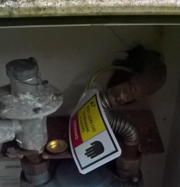

So my mum has splurged on getting a yearly check from British Gas as she's not that *handy* and they told her that the pipe going through from the meter outside needs to be sealed around the ingress hole.
They said it wasn't a big thing, that I could do it and pretty much any sealant would work so just asking here for recommendations/ procedures.
I read that *some* sealants shouldn't be used around pipes due to them being acidic, and maybe others wouldn't be suitable for other reasons... So gel, silicone, expanding foam - what makes/brands... any ideas? - I just want them to be able to tick off this issue the next time they come.

Also would like to know why it's got a do not use label on it and been capped lately
Do you need me to find out any more information on this?
As I said, he just told me that the hole needed to be sealed, stating that as the box is closed on the outside, that if there were a leak from that unit, the hole would allow the gas to pass inside the house cavity. So he told us to seal it with *any* sealant (and he did say pretty much ANY would do!).
Just been reading that that's not entirely true... that some sealants are unsuitable for metal pipes...

What do you mean by that? It's a key-locked box on the side of the house with a meter and the pipe running through the wall (albeit not a sealed ingress point).
What's wrong with the setup and what do you advise? - is it really not simply a case of just sealing the hole and why not?
