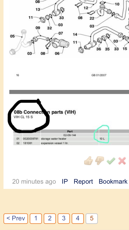

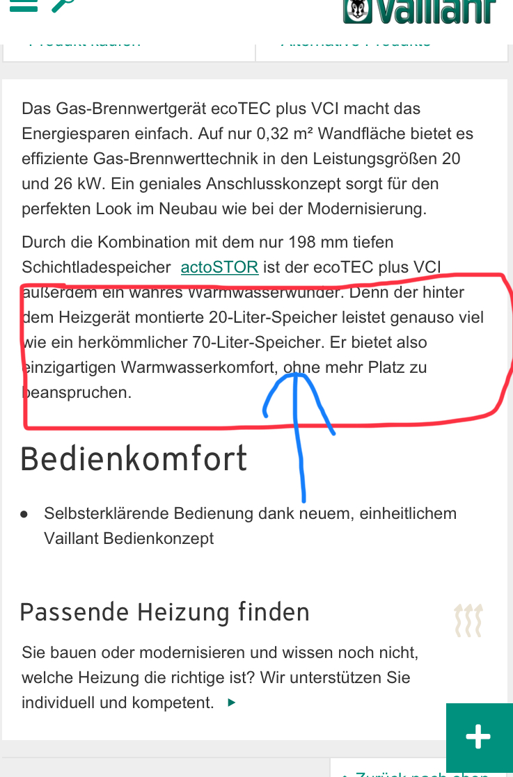

Because the mounted 20-liter storage behind the initial boiler makes as much as a conventional 70-liter storage cylinder therefore I’m thinking it should be well enough
I believe you to be miss informed here mate.

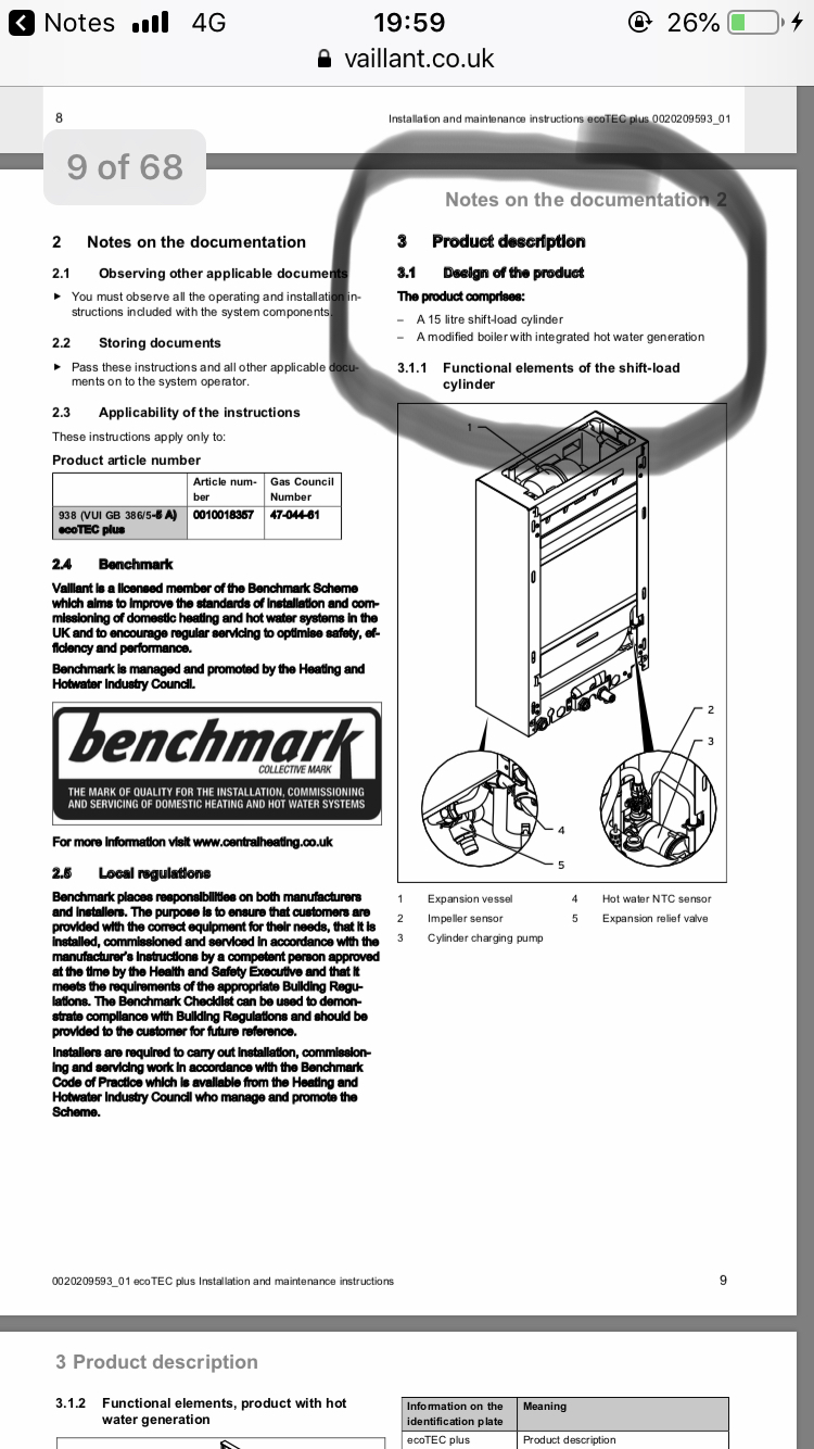

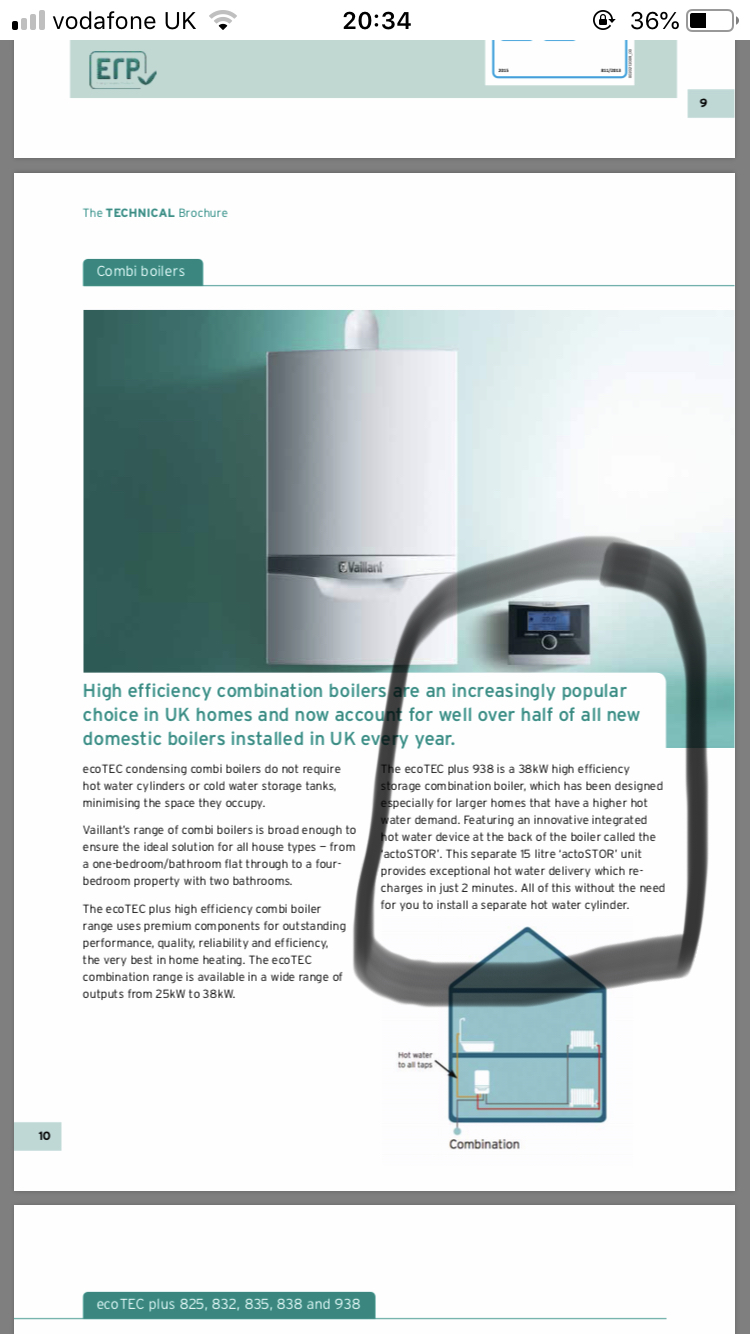

I spoke to Vaillant a few times back in Germany and we have the same boiler but with less kw. If you scroll down you will see in the description there is clearly written what the boiler is capable off.
Wandheizgerät ecoTEC plus VCI - Produktinfos | Vaillant

But that isn’t what you said mate. You referenced to the storage vessels. They are not 20 litres. They are 15 between them. The 20ltrs refers to the possible flow rate.
