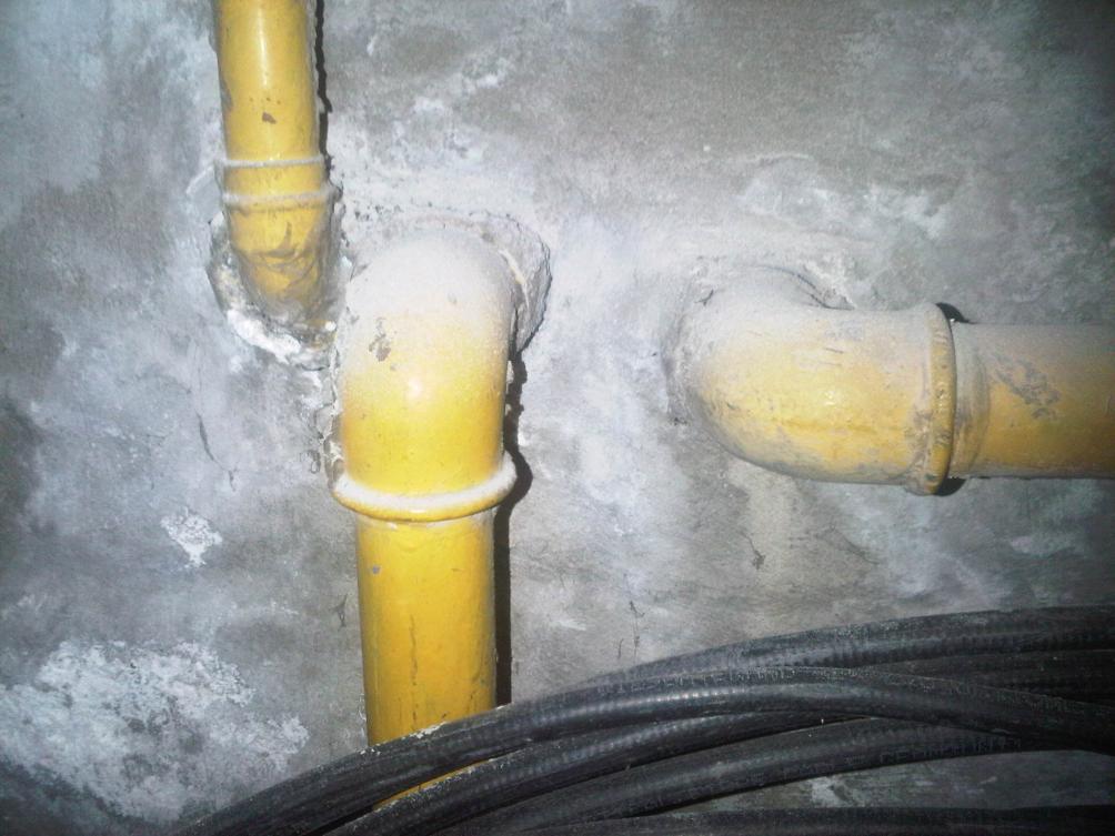

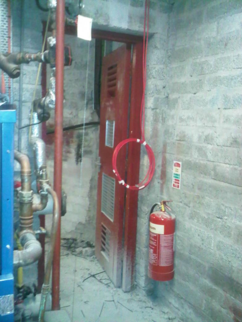

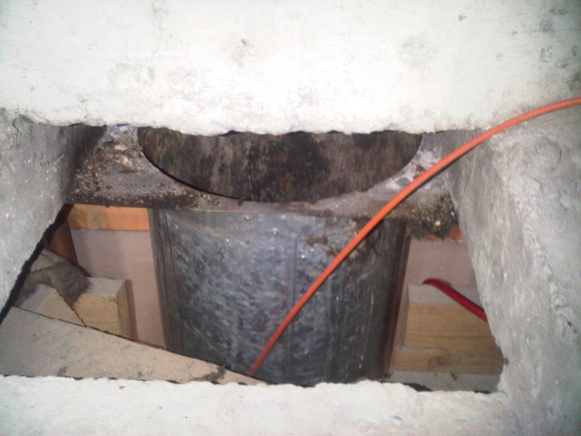

Contract manager asked me to take a butchers at a wee site in Belfast this morning because he thought it might be "Bloody dangerous John!"
He had a point, 2 ID's, 12 AR's and and 1 NCS! Bit churlish that last one! Lol!
Cultra 01.jpgCultra 02.jpgCultra 03.jpgCultra 04.jpgCultra 05.jpgCultra 06.jpgCultra 07.jpgCultra 08.jpgCultra 09.jpgCultra 10.jpgCultra 11.jpgCultra 12.jpg
Where to begin?

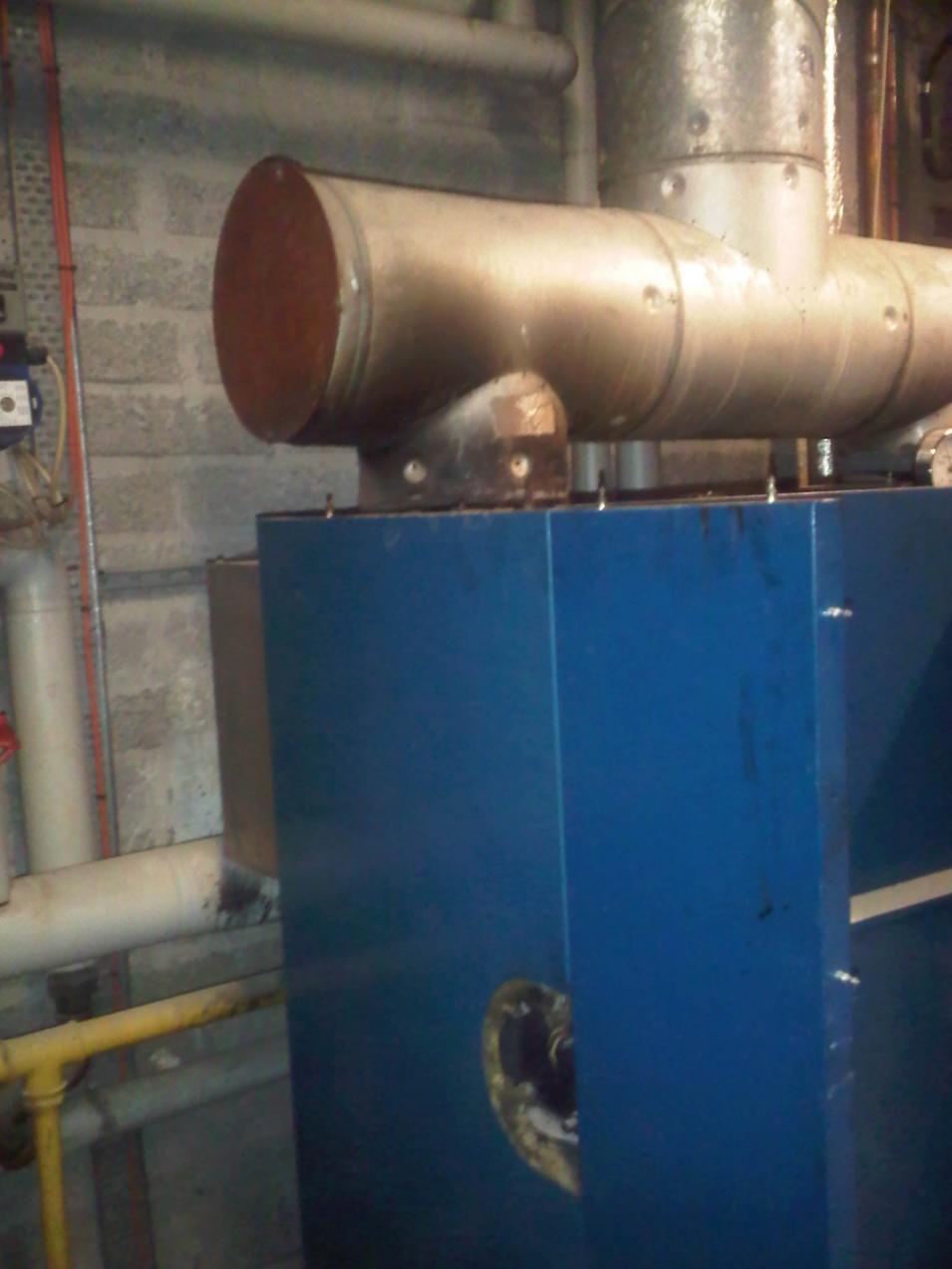

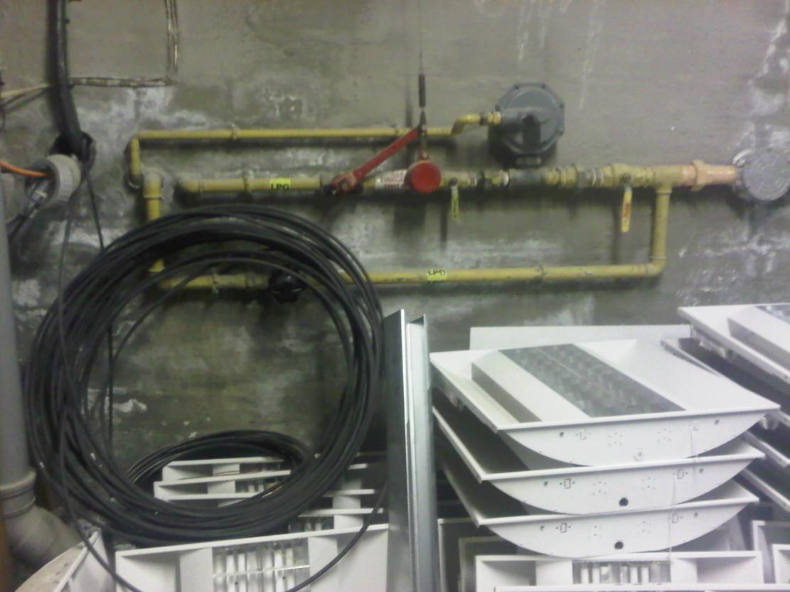

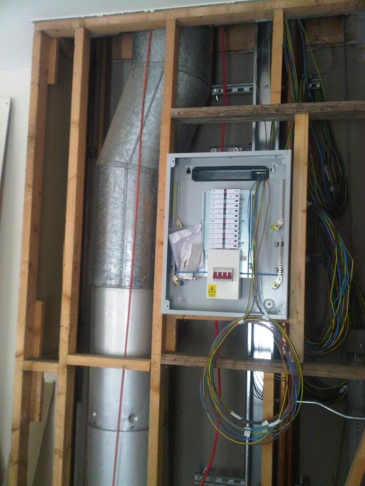

LPG installation in basement, ventilation is through 2 rooms and 3 sets of louvered doors, 1 flue end cap missing, the other is a jerry rig, the flue rises 2 floors in a sealed void and terminates in the roof space 3" short of the chimney stack, which is unlined. No boiler data plates, MI's or information!
The gas service pipework enters the building below the base of the load bearing wall, no ECV immediately on entry, service pipework at 750mbar, no gas detection, the regulator vent discharges into the well under the grating......
I got bored of writing at that point and just condemned the installation.
And surprise surprise! No one knows who's been servicing the things! Because I would be RIDDORing him! There's only so much you can forgive someone for a lack of education for!
This is in residential building for kids and adults staying over while on training courses and what have you!
The flue was being ripped out as I left and we're recommending new wall hung boilers be installed at or near the entrance door with the flues coming out above the door (plenty of room to achieve the required distances!)
