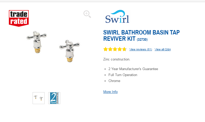

b) Tap Revivers kit should be ok? See second attachment for detail

Yup, only issue is when the physical size of the revivers are different to the existing guts, have found that they can bottom out or not screw in far enough. Keep the receipt if coming from screwfix, keep em clean and take them back if no good. Don;t forget to check the seating of the tap body, if this is pitted you'll need a tap reseating tool too
