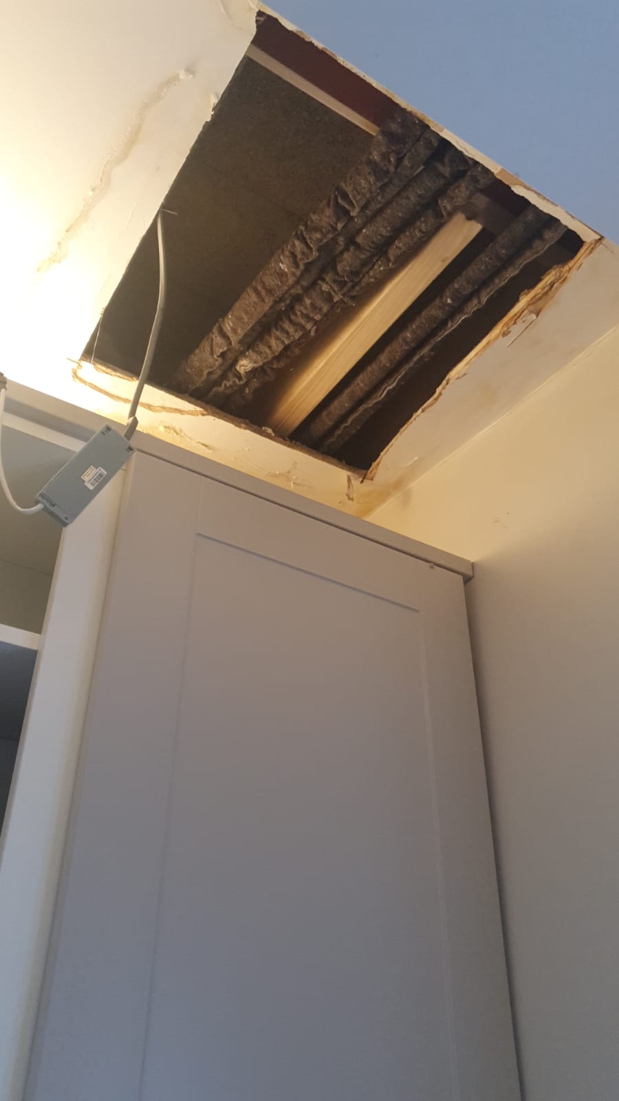

I ended up taking a multi-tool and cutting out the ceiling myself because they just kept on skirting around the problem, guessing when they could've had a proper look instead

it has three RSJ's holding it up and it was constructed with block and brick. Weight was definitely factored in.
Can you see the bottom of the waste system from your hole if so add a pic
Can you cut a bit more of the ceiling out to gain access?
That is NOT a suitable waste for that situation. End of.
