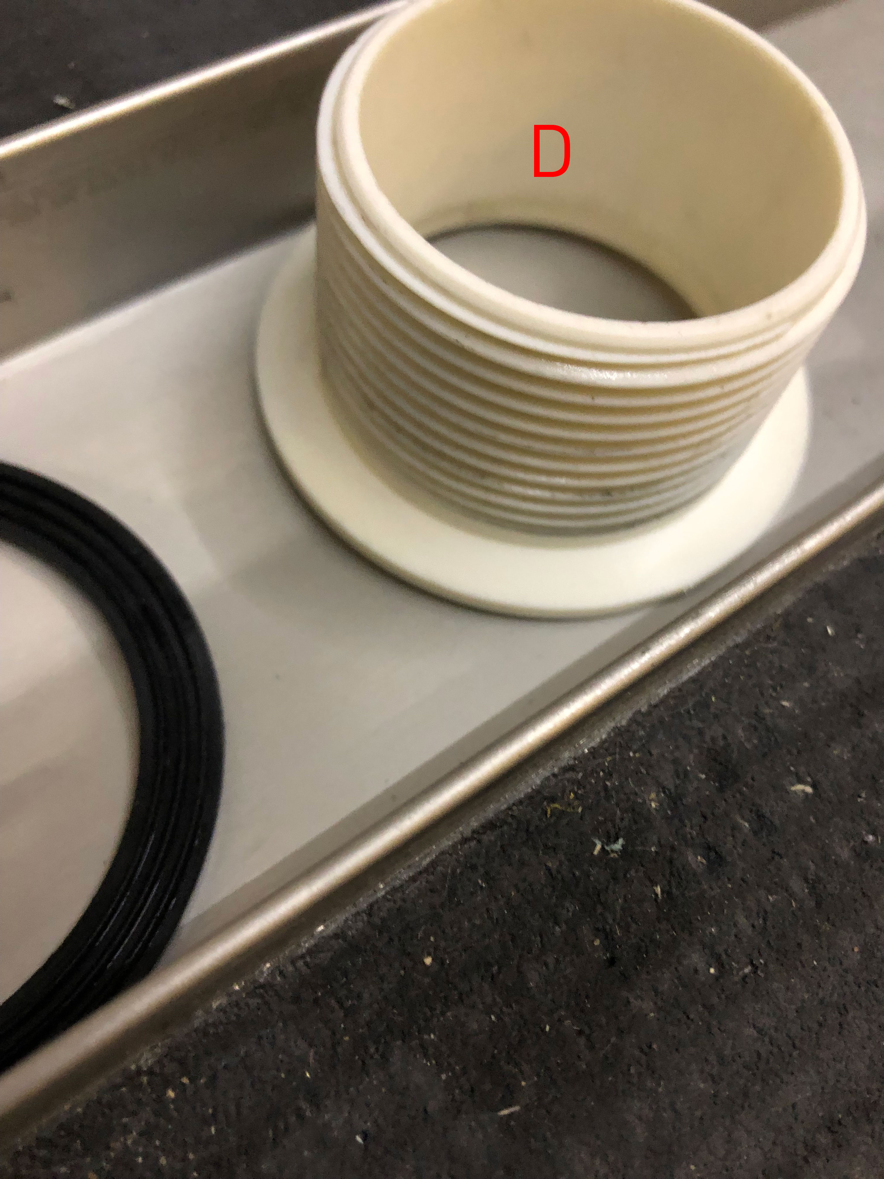

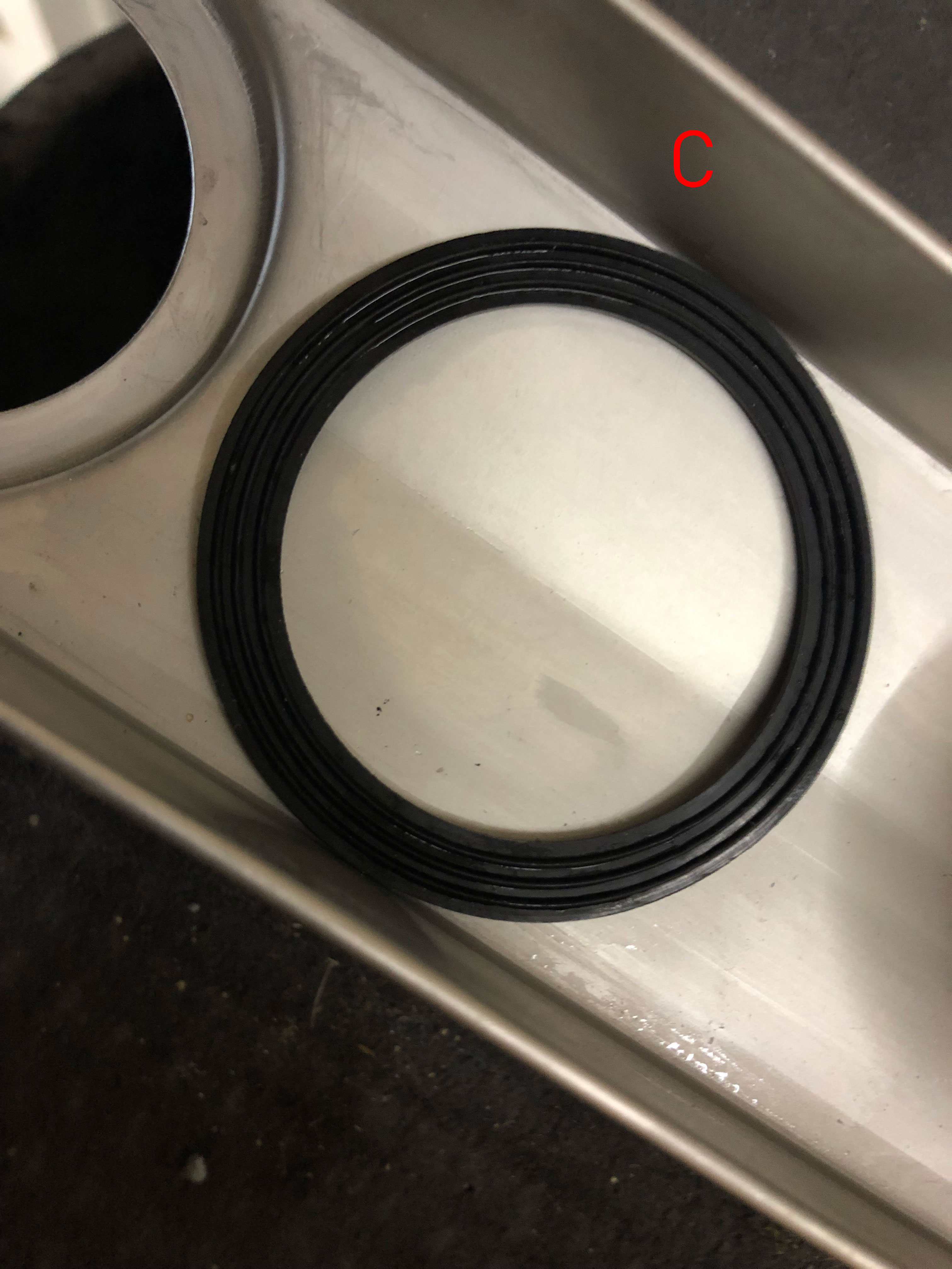

I have a shower tray waste I'm putting together. Unfortunately the waste came with no instructions as to which seal goes where and as my first attempt resulted in a leak I thought I would get some professional advice ;).
A is the drain slot in the shower tray.
B is a rubber seal with grooves
C is a smooth rubber seal
D is the top of the waste that screws into the bottom part (E). E also has a grooved seal built into it.
Could anyone tell me the correct order in which the seals should be mounted and if sealant should be used anywhere?
Thanks,
Mark
c on e
b ontop of a
d through all of the above into e
