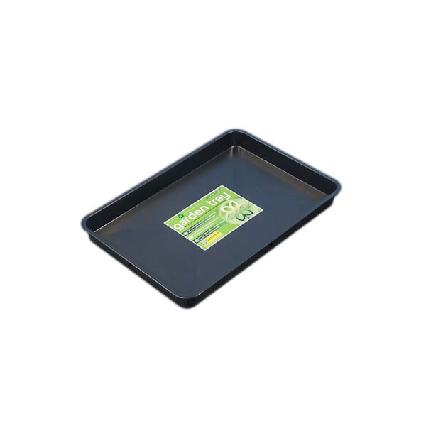

Can’t actually seem to buy them in the UK though. Have to ship it from the US at vast expense relative to the cost of the product. Unless anyone knows a UK supplier?
No word of a lie, my old boss tried producing the product. Just simple square plastic trays with a connection for overflow pipe, also for properties with central tanks He had an alarm system that would go off if water entered the tray. He couldn't get a patent on it due to similar items overseas but he did spend a few thousand getting some samples made. He spoke to loads of merchants like plumb centre, Travis Perkins etc. He even contacted home insurers to to see if it would be something they would push on homeowner in the event of a tank leak. And no one was interested in selling the product.
Shame there’s no interest. I’m sure leaks are rare, but a £20 tray like this would have saved me £££ in cleanup, dehumidifying, carpets, ceilings....

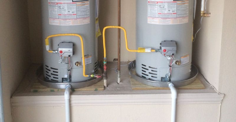

I think the reason they would be popular in the US and Canada is because many hot water cylinders are just mild steel tanks with a flame at the bottom and a tube up the middle which connects to the flue. They run until they start to leak, which is usually about 10 years, if you remember to change the sacrificial anode regularly.
I guess the unvented manufacturers don’t push it because it would imply their products might fail. In the US the aluminium trays see to be the way instead of plastic because they can take the tank weight and don’t warp when hot water actually fills them during a leak.
