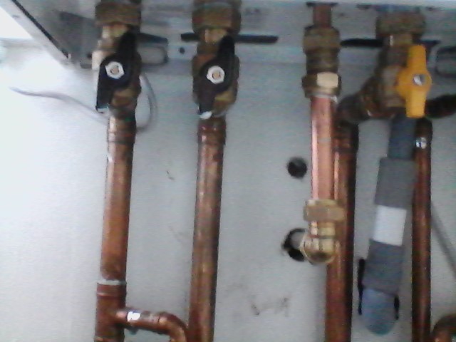

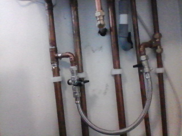

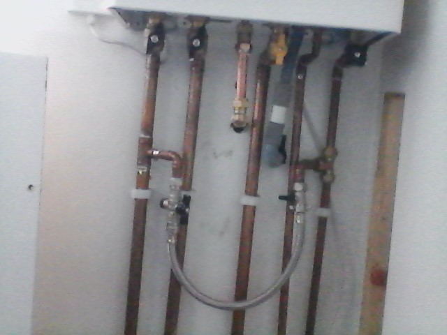

I took off the wooden panel which was covering the pipes and was inspecting the pipes and valves with the boilers' instruction manual and which way is the filling loop meant be facing such as the valves? There are two black levers at each side and I was reading something about a non return valve could this be something to look at all as they are both facing clockwise.

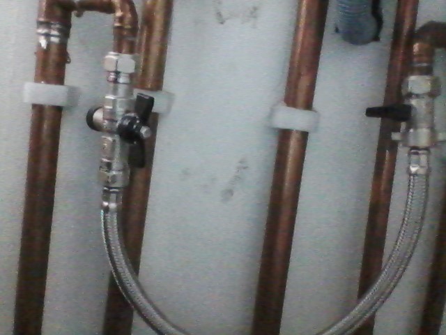

We need photos of that pipework. There will be an arrow on one or both of those valves on the filling loop. Close-ups showing the valves and arrows would be particularly helpful.

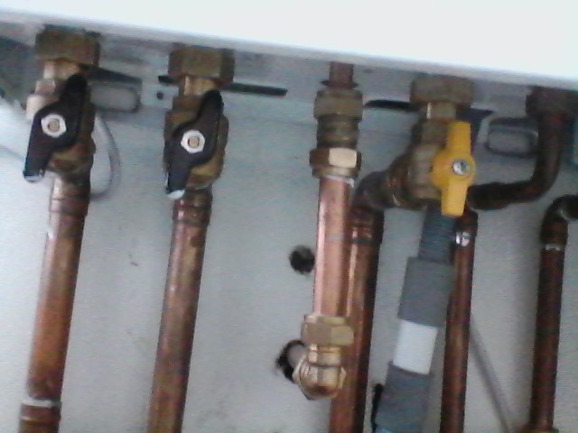

Okay so I have taken some photos of the filling loop and valves (sorry they aren't exactly the best). On the black lever on the right side of the filling loop there is an arrow pointing upwards yet the black valve is facing another direction. With the black valve on the left side of the filling loop I can't see an arrow pointing anywhere on the valve. Any further clarification on this thank you.

The position of the black valve handle on the right is fine - it shows that the valve is closed. The handle on the right shows the valve is open, and it should not be. Actually, to comply with water regs it must not be, and the braided hose must be removed from between the two valves unless filling the system.
The right-hand valve is facing the wrong way but that is not the non return valve, the left hand one is, and there will be an arrow on there somewhere. Please have another look and post the photo..

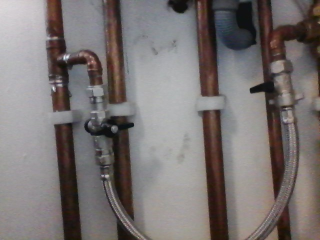

No I haven't touched the filling loop but adjusted the cold water inlet stopcock. How does the filling loop seem, as I am not sure if the left side of it is turned the right way because the black lever is turned fully anti-clockwise and I am not sure if should be turned clockwise or not (see previous pic) I will take another picture.
You need to turn the left hand valve of the filling loop to the off position - ie crosswise to the valve body. It should turn 90 degrees clockwise.

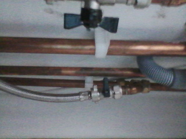

I have now turned the left hand valve of the filling loop to the off position (fully clockwise) I took a picture of what it looks like now does it seem okay because before it was turned fully anti-clockwise.

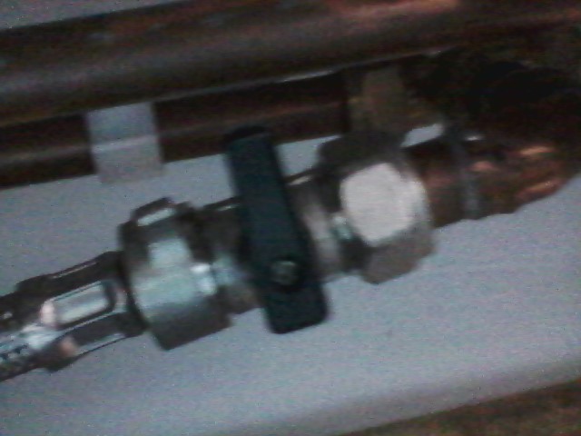

Yes that is correct but we still need to see the arrow on that valve. It contains a check valve, so it can only be fitted in one direction.
I looked at it and at the back of it there is a arrow pointing upwards how does that seem? In fact both of the black levers on filling loop on the left and right side have arrows pointing upwards, thanks
I looked at it and at the back of it there is a arrow pointing upwards how does that seem? Thanks
Pointing upwards is correct - it's allowing water into the system from the mains but not back the other way. If my theory is correct about contamination, the non return valve could be stuck. There is a way of checking but I'm reluctant to suggest it as it could cause a bit of a flood. Remove the braided hose (the U-shaped silver pipe that sits between the two valves), making sure that both valves are closed, and that there are no drips from either of them. Whether your rash clears up or not will prove or disprove my theory. In any case, it will mean you're complying with water regs...

The braided hose should come off easily enough - it's the two nuts with "wings" on them that you need to undo. Should only be finger tight...
