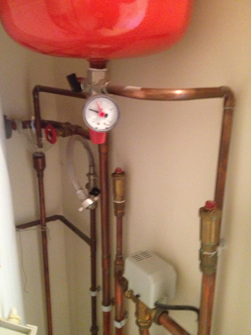

Any chance of some pics of the airing cupboard Nigel?

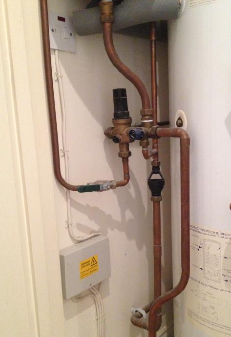

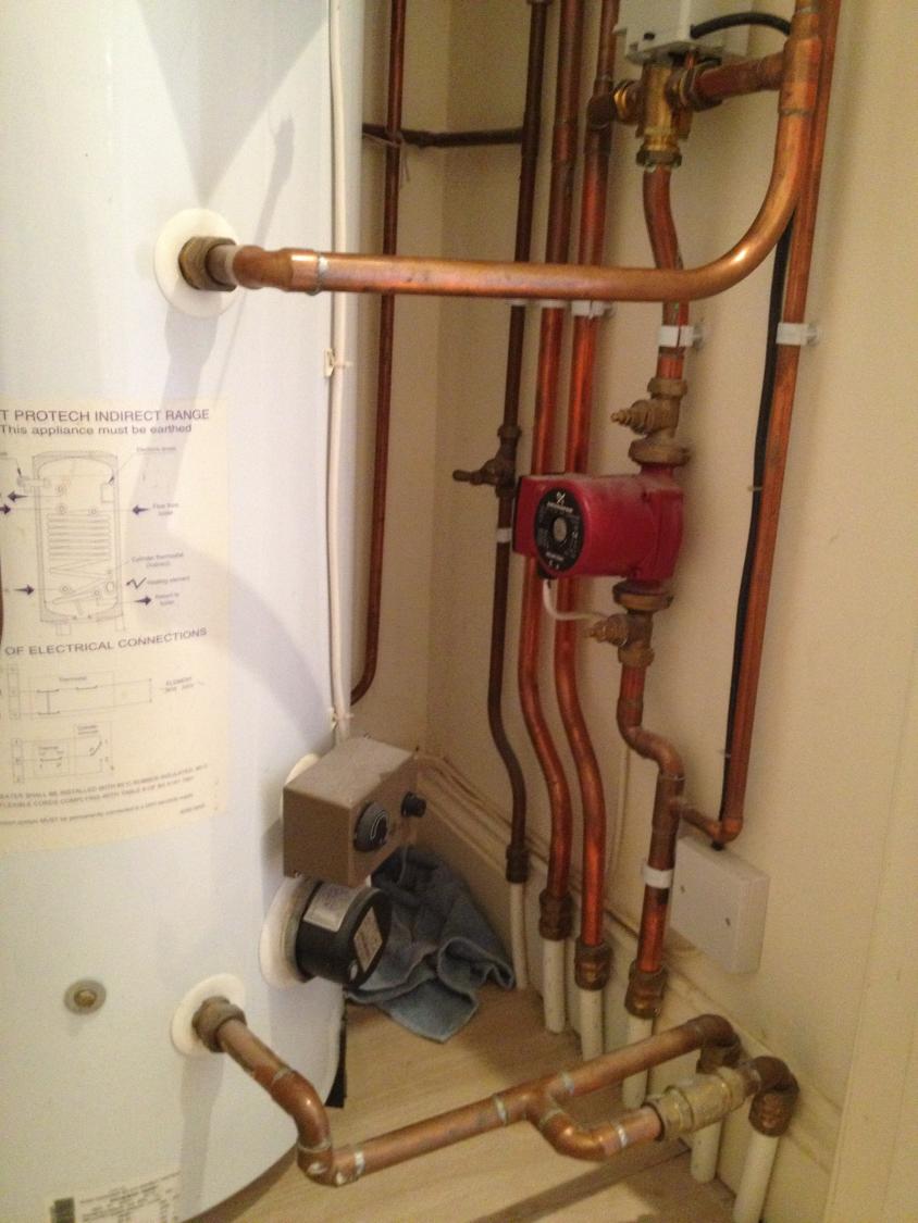

Wouldnt mind seeing the rest of the cylinder.
3 port on an unvented, your missing some essential safety features, as Mr Cropp states, get someone in to sort out that set up asap.

You've got a fairly important safety valve missing that would cut off the primary flow in the event of the cylinder temperature overshooting its setpoint.
There's other issues but that's the main one.
if it is a split coil, which it may not be then you need at least 2 other bits replace/installed urgently to make things work safely again, which are manufacturers parts. These need installing by a qualified (G3 regulated) plumber. If the coil is split then a new cyl is needed anyhow and the completed cyl inc safety devices will be installed by the plumber. Because of the risks involved in doing it wrong, this site wont offer the actual answers as folk may be tempted to give it a go themselves with poor results.
