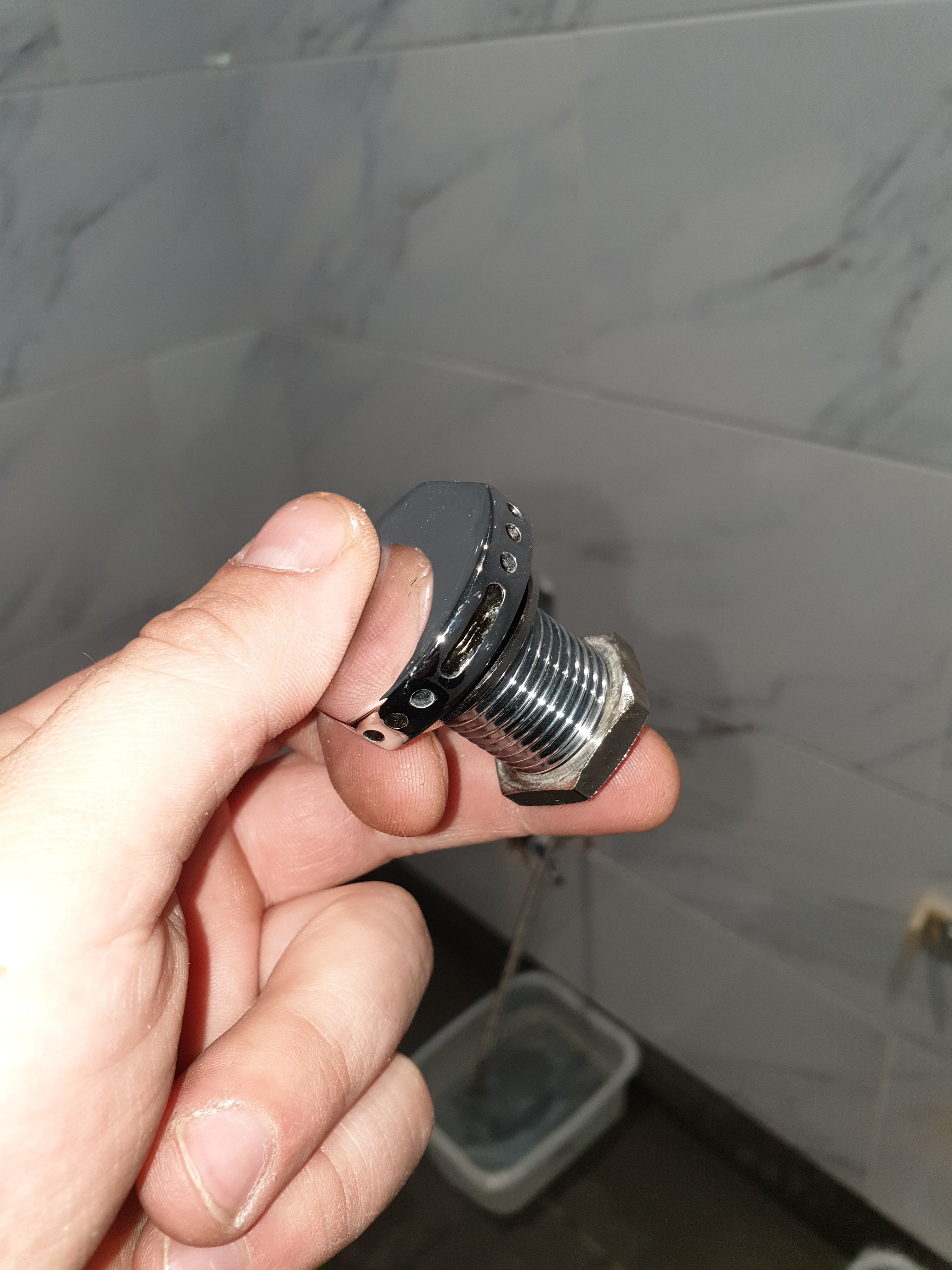

That didn't work! I've now taken the urinals off the wall & gonna test the pipework into buckets rather than the urinals,if that works fine then maybe the spreaders could be the issue ie holes too small?if it doesnt work then looks like ink have to take tiles off & change the supply pipework to 22mm right up to the spreader.Nightmare.

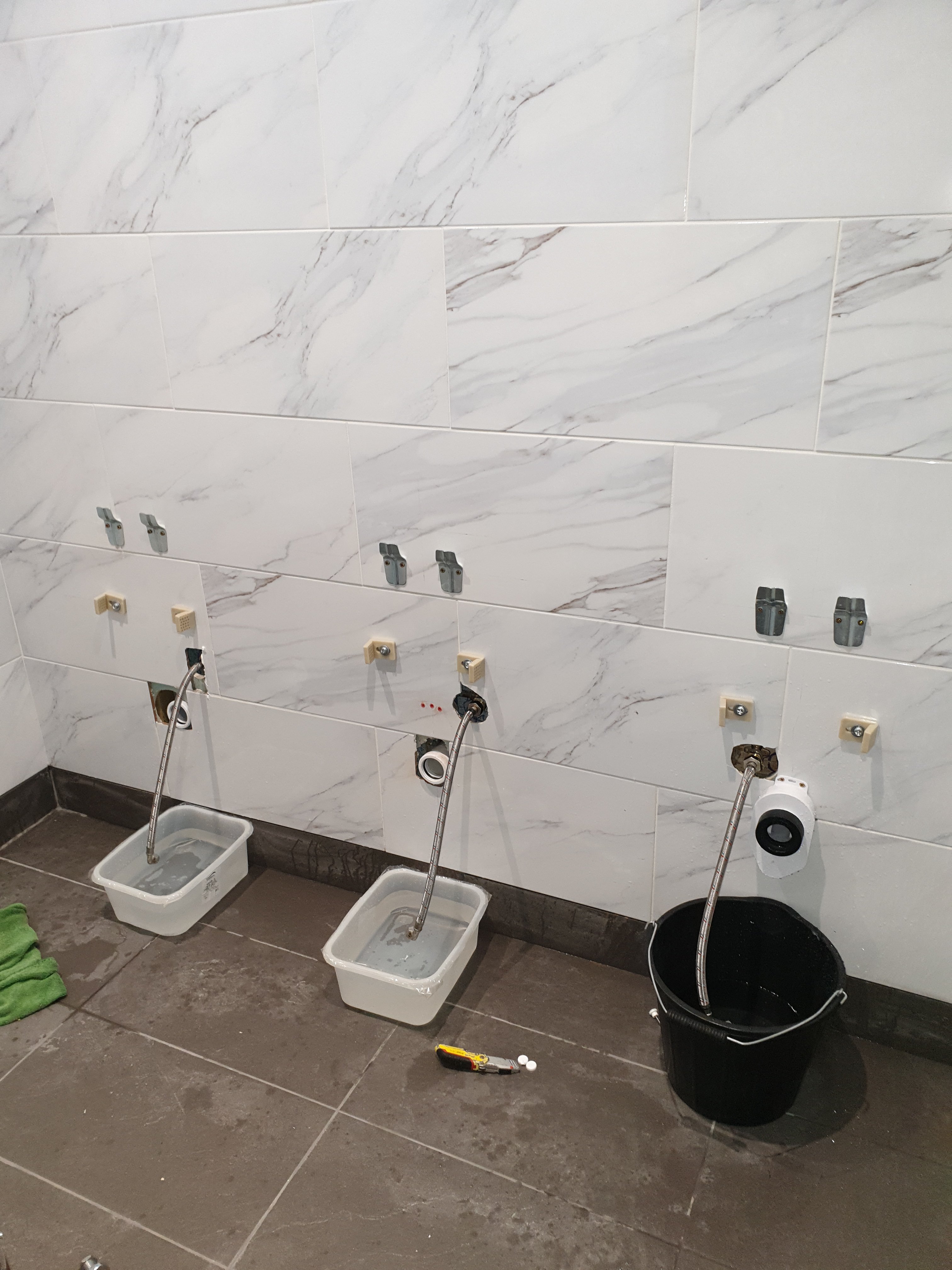

Picture of the pipework arrangement, filled the cistern with the flexis into buckets & everything worked fine.maybe a problem with the spreader?holes are very small but there is a bigger slot in the middle.
I haven't worked on these for many years but every one I fitted the pipework dropped straight down to the spreader. It looks as though in your case it would drop down and then go back up to the spreader? I wonder if this could be the cause of the problem?
Flex kinked ?
Thanks for the reply, yeah that could be the case I suppose,certainly in the case of top entry spreaders.I followed the instructions that came with the urinals for the outlet height etc,the flexis were in with the urinals too. There must be some sort of restriction somewhere & it may be where you said.
cheers
Lift the flexis up where there connecting onto roughly height wise and test again
Looks from your picture that the pipework where the hoses are connected are too low unless I'm missing something ...can you post up a picture of one of the urinals...regards Turnpin:)
