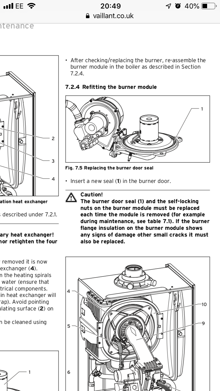

thought I would continue this here instead of the other thread
When I went in the Ecotec training day a few years ago I was told to open the heat exchanger up every 5 years unless FGA reading say otherwise
Every time you open the heat exchanger you should replace the seal
Am I wrong? Or has it changed?
Bloke on vaillant course said to renew every year but when I went on a fault finding course a different tutor said every it's unnecessary.
View attachment 37958 thought I would continue this here instead of the other thread

Where does it say in the Vaillant manual to flush main heat exchanger, replace electrodes or any seal. Electrodes last quite a while and don’t need doing on a yearly basis, renew if necessary..... usually warped. So if you do this on every service, you’re effectively charging customers for work that doesn’t need doing.... lining your pockets in a long drawn out service and making money on the parts you sell.

Changing electrodes every year is definitely not necessary...they will easy last 5 years give or take. As for seals. If the customer won't change the seal I simply wouldn't service the boiler. Because you ain't servicing...just saftey checking it.

And to be fair there is some truth in the whole not servicing in line with MIs electrodes do not need to be done annually

Vaillant Premium Service
The premium maintenance is a comprehensive cleaning and verification of your gas boiler
Removal and cleaning of the burner
Removal and cleaning of the heat exchanger
including fins
Flush main heat exchanger after cleaning
Thorough cleaning of the boiler interior
Checking the settings
Optimization of the settings
Checking the expansion vessel
Cleaning the siphon
Replacement of worn parts, such as ignition electrodes, seals or damaged parts
