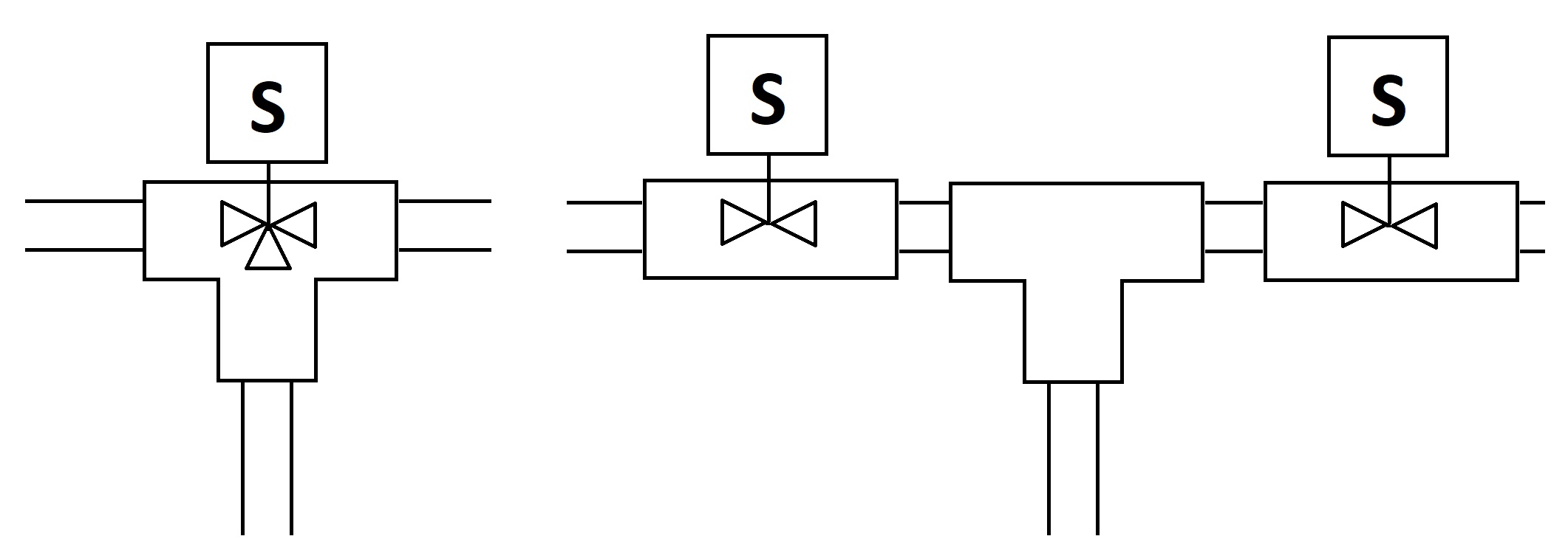

Hi all! as I am attempting my first plumbing project and the stakes are high, I would greatly appreciate picking your experienced brains regarding valves. I am building an overland truck/motorhome and since I will be traveling to remote areas and underdeveloped countries I'd like my plumbing choices and parts to be as reliable as possible. Not only can a leak be catastrophic in a motorhome but also I rather not have to carry too many spares of everything with me.
I gather from online sources that using 1/2 - 3/4 inch PEX-A is the preferred type of pipe for what I am trying to do.
1- If I you were to choose one way to divert water flow with a solenoid valve and trust it to last long and without problems, how would your setup be? Perhaps one 3-way solenoid valve, or two 2-way solenoid valves and a tee, or something else?
2- What solenoid/motorized valve brands do you trust most (inside the 1/2 - 3/4 inch range of products)? How about manual valves?
3- I can find manual valves with Uponor/wirsbo type fittings, but not on the solenoid valves.
So I should assume everyone uses these threaded male adapters right?
Truly grateful for any tips and advice guys, I am quite out of my depth with this stuff!

A good quality ball valve / lever valve and just manually switch it over etc
Indeed, why opt for an electro-mechanical solution which can fail rather than one that is completely manual in a mission critical environment.
What's the water transfer system for anyhow, switching tanks for general purpose use or potable?
Thanks a lot Shaun and gmartine. I get from your responses that you don't trust a solenoid valve to be reliable enough. That's in itself a very useful answer to me. I did imagine that any manual valve would be better than any motorized one, and I do intend to keep everything quite manual, but as it is a system that would have several modes of operation and several valves need to be opened or closed to switch modes, the convenience of having some automations, prevent any oversight like leaving something open when it shouldn't, and perhaps include some timers too, was quite tempting.

I think you guys are probably right about insisting on keeping things more simple than I previously intended. I am now leaning more towards keeping it manual after having received such one sided views on this from people that has a lot more experience than me. Regarding the electrical side, the valves would have been 24v, sorry if the pictures were confusing, I used some random ones from google images.
If you are going the electrically operated valve route, you need to be using solenoid valves not the pictured Domestic Electrically operated valves.
They're designed for a stable environment, they'll fail before you get to the end of the first road.
Presumably you'll be using an inverter to get 240v, if not 12v or 24v dc solenoids are available, probably more 24v than 12v
My bad, seems like I used the wrong pictures up there but the plan was to use 24v as you had guessed. Most of my appliances will work on 24v, except for a few 12v and AC units like the kitchen stove for which I need an inverter indeed. Sorry for the confusing pictures, they were just meant to be examples about the fittings styles.
Thanks all for your advise! I am currently leaning more towards installing only manual valves, it'll increase the reliability of the system but it'll also increase the pipe length and number of fittings because I'll have to bring some pipes closer to where they are accessible and into a perhaps uglier than I expected control hub. But these seem like sacrifices worth making.
