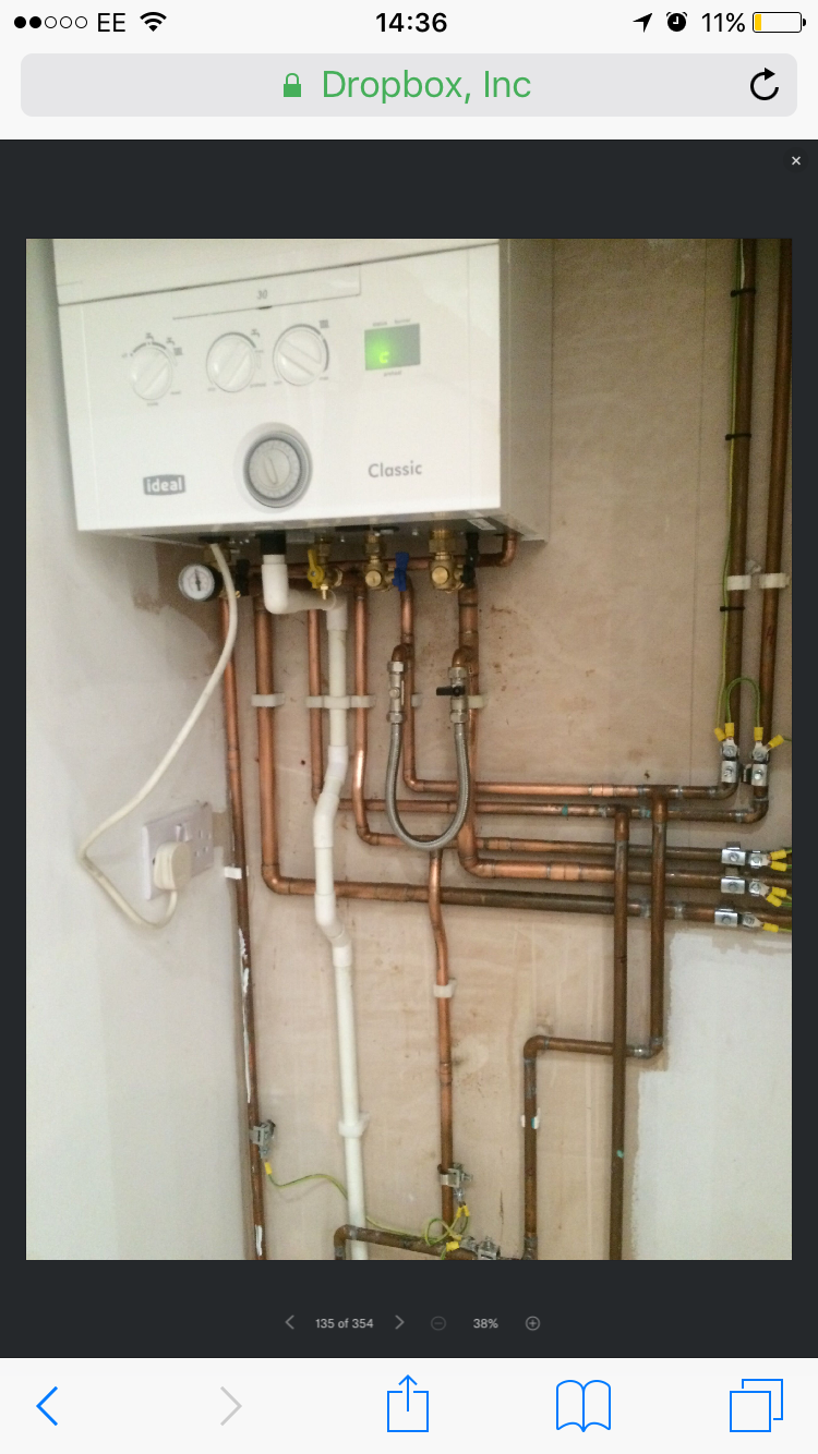

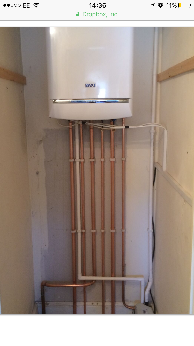

don't put yourself down mate there's plenty out there that will do that for you just bear in mind you cannot please everyone all the time seems to me your lacking confidence a bit you have got your qualifications so your no fool , it takes years to become fully skilled 3 tips I would give you work clean and tidy dust sheet up where you work and clean up after yourself , communicate well , turn out quality work recommendations from customers is what you want to achieve. take pride in your work and your confidence will grow. I have been doing this nearly 40 years and I am still learning things every week chin up bud post a couple of picture up of a install you have completed lets have a look all the best kop.

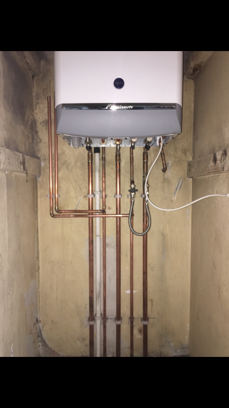

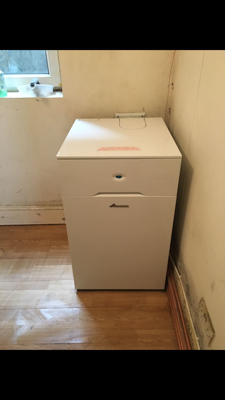

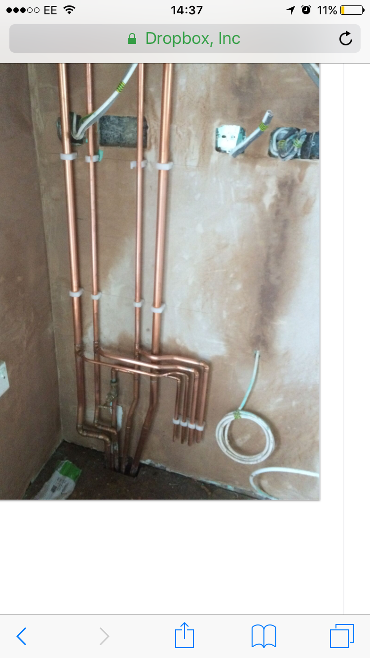

Just a few I've done. I'm getting Afro off this builder we do work for and he's also someone who contributed to me being sacked from my previous employer. (Previous employer was a tool but still' I do lack confidence but o suppose that's down to what happened with my apprenticeship
think about layout and plan your route
looks good tho bet the sparky liked you on the last pic
no mag filter on return ?
pipe work looks great
nice bends / passovers
you got no worries bud nice clean tidy work there its their loss theres always someone who will take the Sod we all have knocks in life keep turning out work like that you will be just fine only one comment maybe space the pipework a bit so you can get the insulation on all the best kop.

Haha the sparky messed up on the plan from what I remember. No mag on the return because the customer didn't want one (extra cost) if it was up to me I'd put them in on every install, class things.

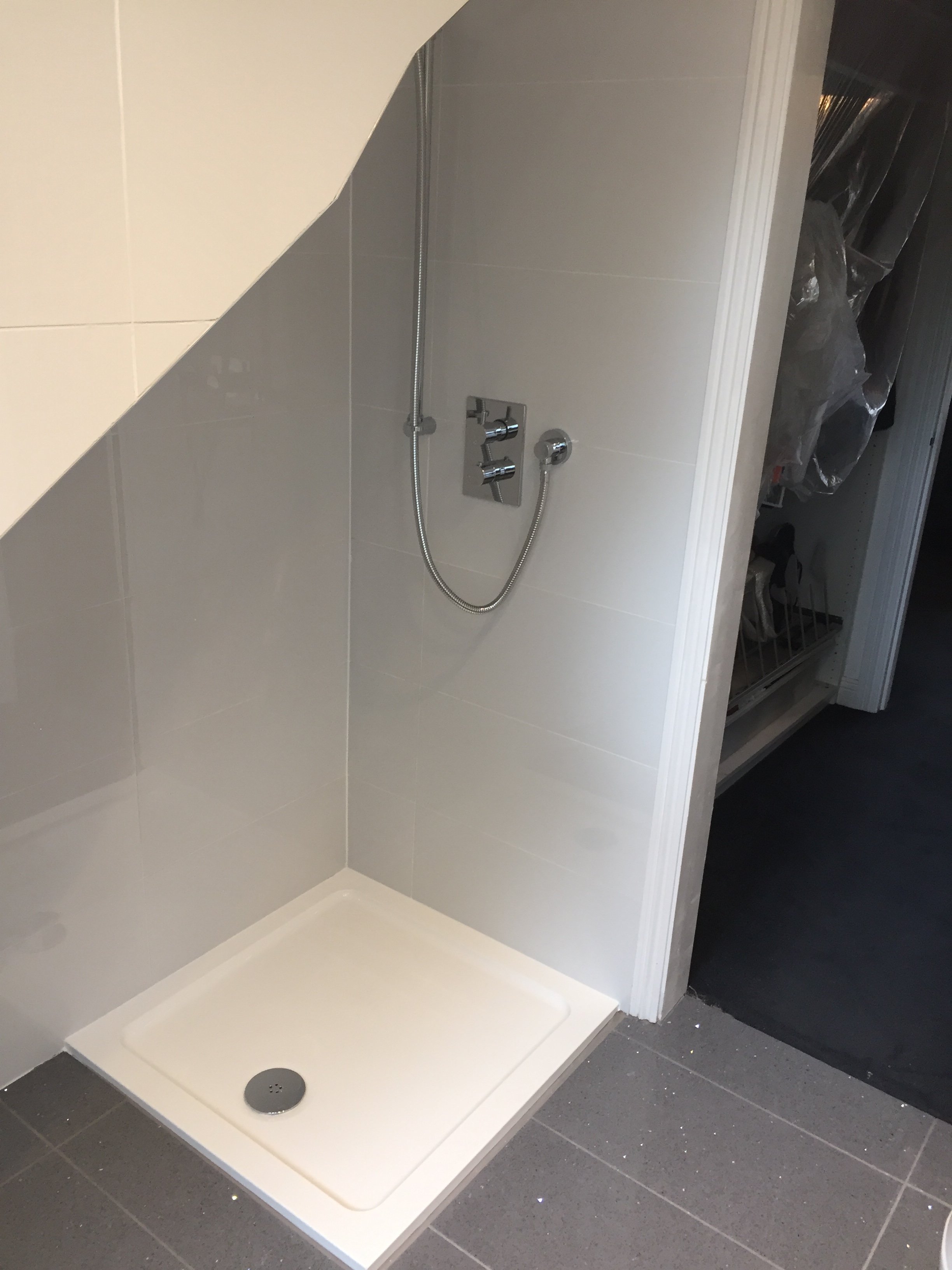

Dont beat yourself up about it bud we all have them jobs working for builders it is always a problem they often work in a muddle themselves and expect you to attend their job as soon as they call , i have had a nightmare job myself this past 10 days a compleate bathroom revamp multi paneled walls for the shower all the other walls and floor. are fully tiled with porcelain tiles and a limestone boarder , which weigh a absolute ton these tiles need to be supported and the adhesives to fully dry before you can grout up , new shower mixer and fittings tray and sliding doors, new toilet and basin fancy towel rail pipework chopped in the wall and made good , soil stack boxed, pipework boxed all takes time the customer expected it done in 7 days when i had said 2 weeks , nearly walked on tuesday after a few snide comments they made and a slagging off text but got it sorted and am now back on track so we all get em mate , i tend to plan my days work and pick up materials am for that day but often have to go get bits grrrr all the bests kop.

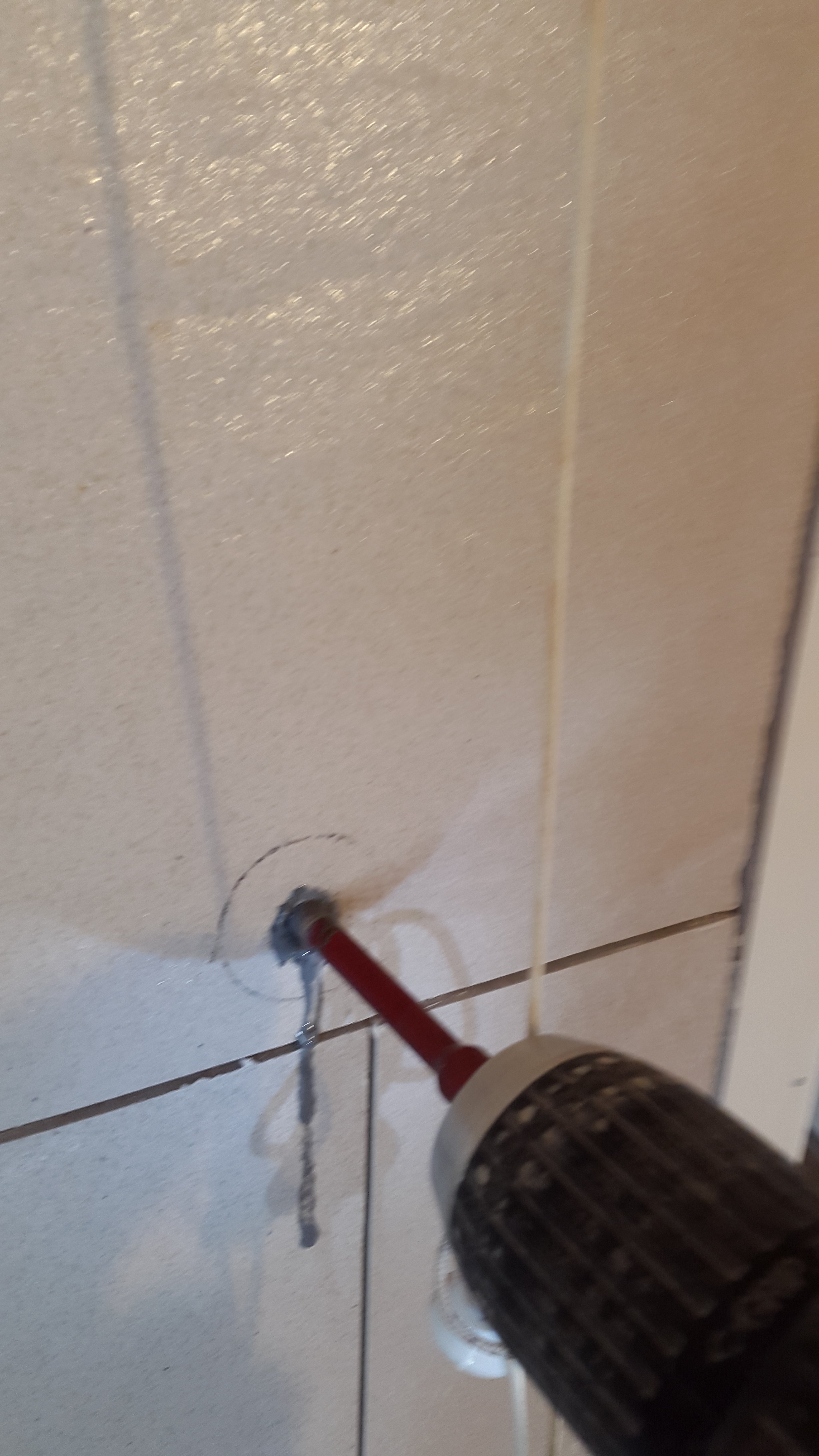

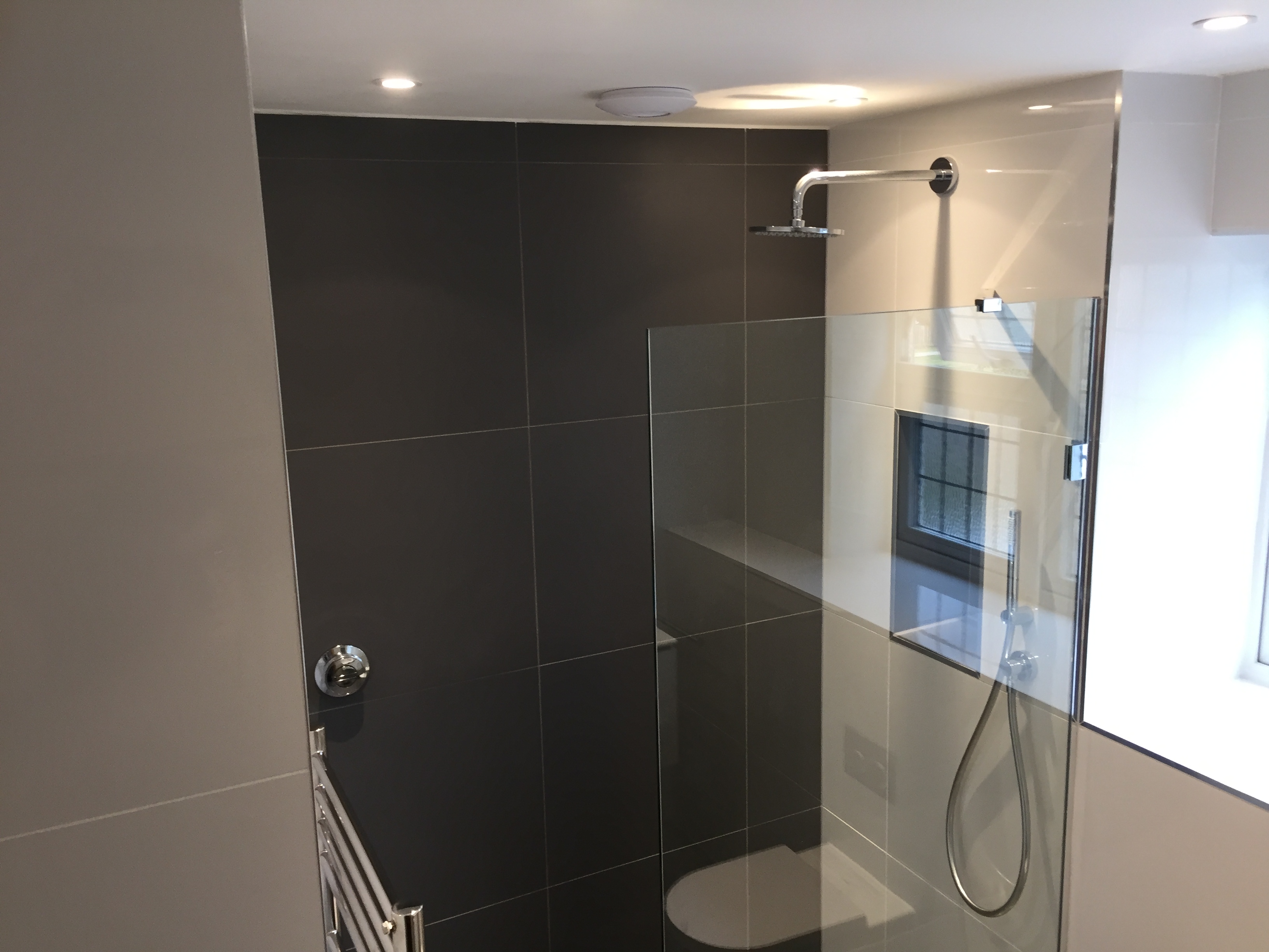

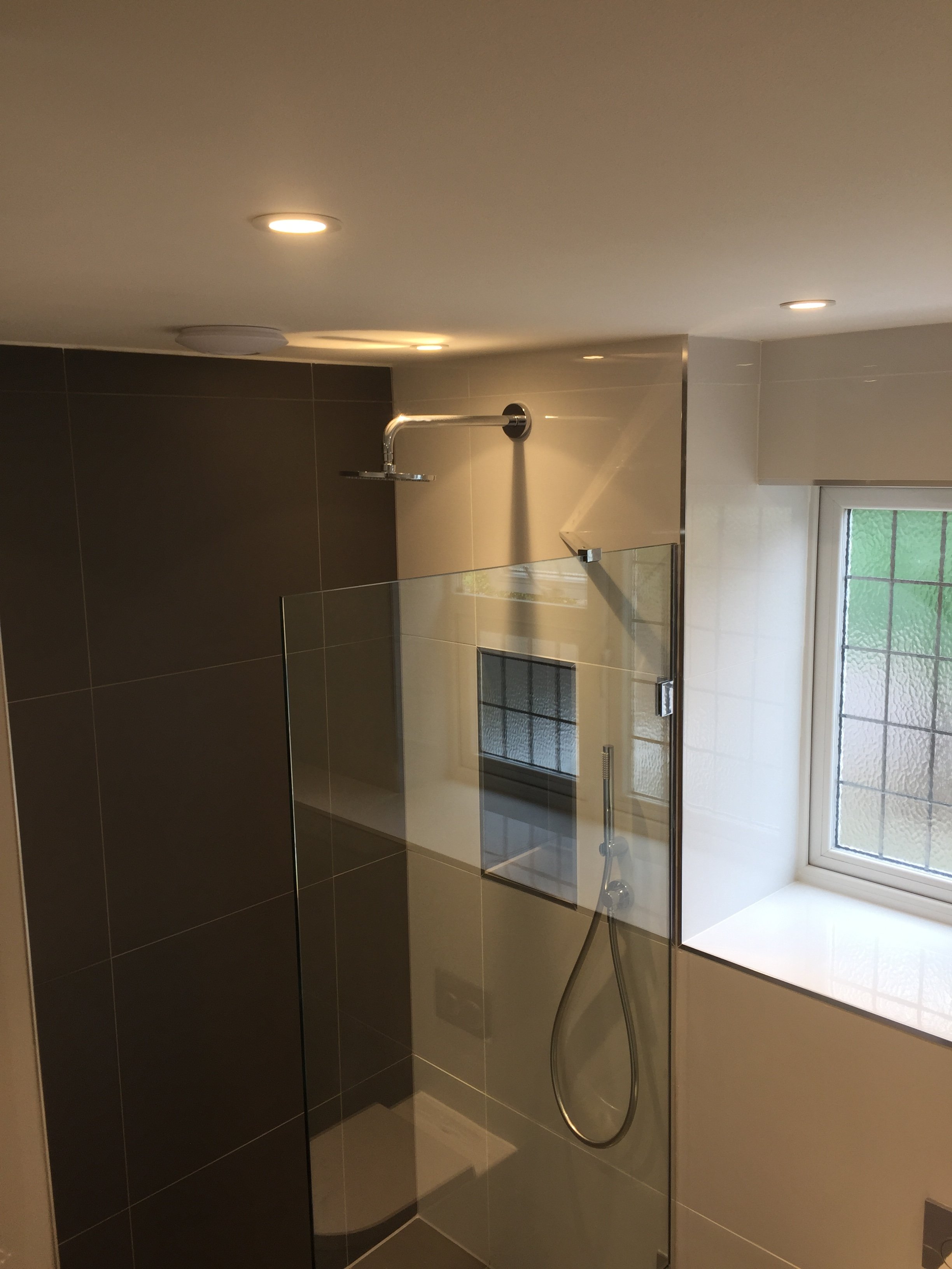

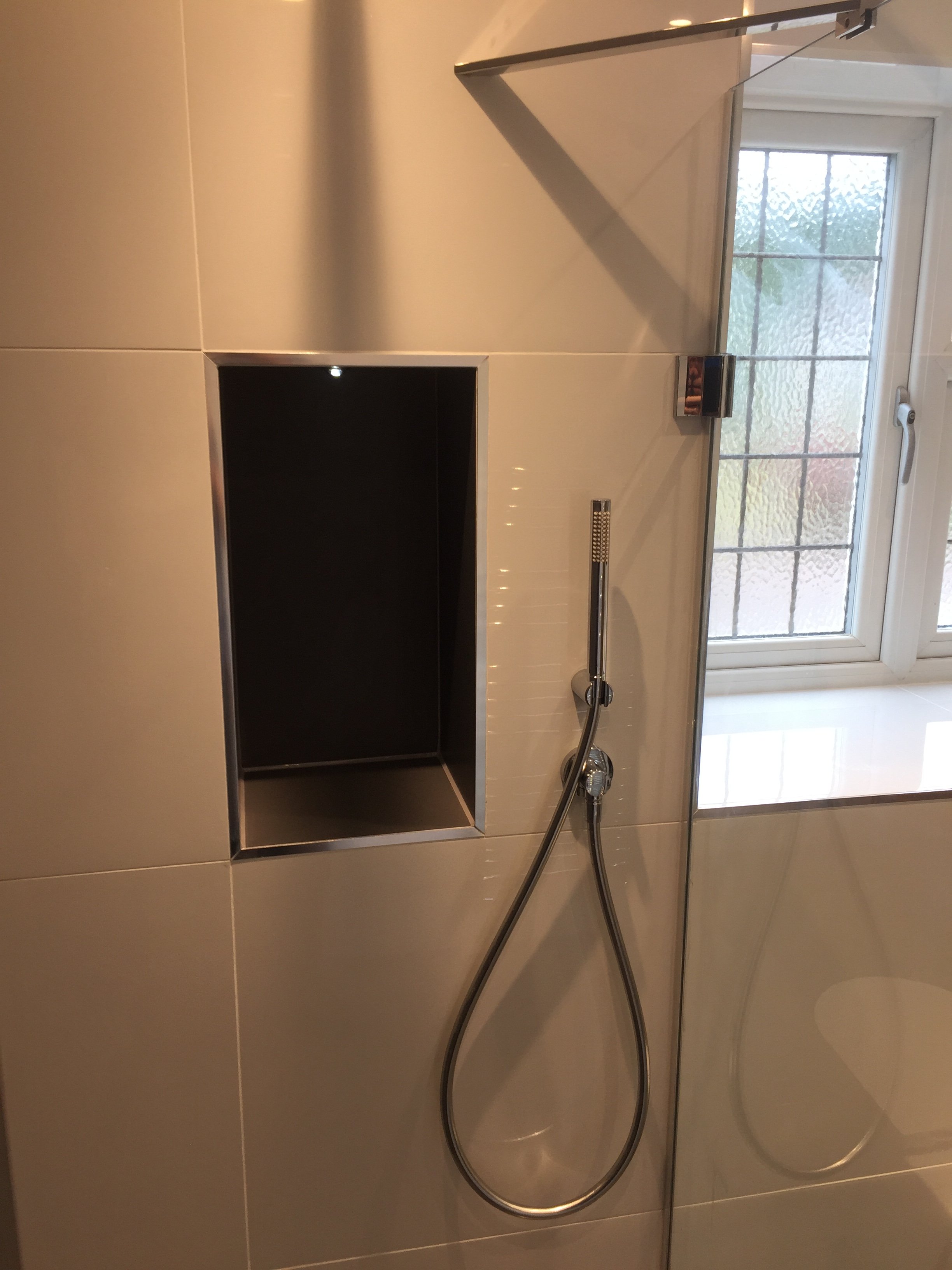

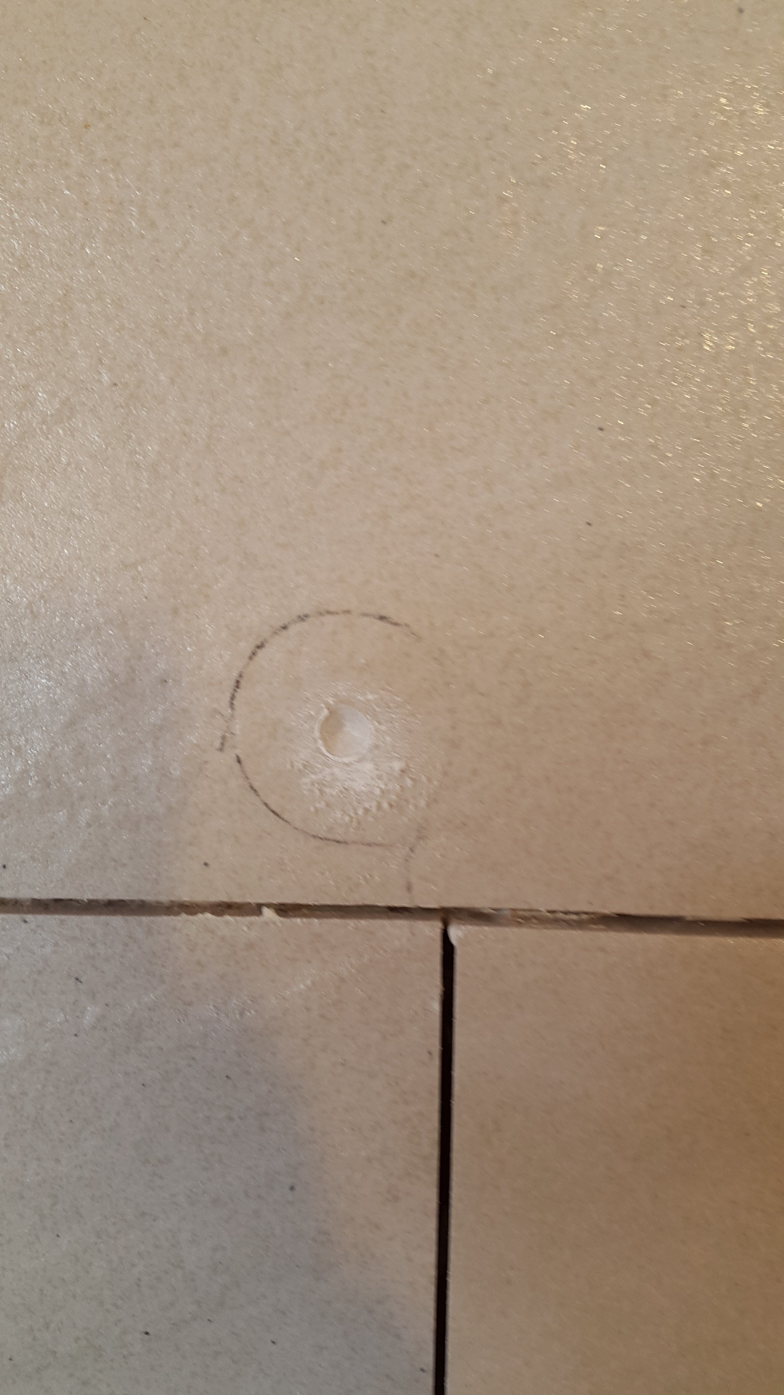

I'm just coming to the end of installaing a wet room and separate ensuite to first floor in a beautifully finished occupied home... can't move outside the spaces for risk of damaging something! The tiles are 600x600 polished flats on walls and floor with 1mm grout joints... they are the toughest porcelain I've had to drill through and the Aqua Lisa outlets and controls all require 4 fixing points very close to the pipe stubs - what a nightmare 35 holes in the wet room and 20 in the ensuite all taking about 10-15 mins each and numerous bits... aaaggghhh!
Feel for you bud i have the same problem invested in some marcrist drill bits , and the bosch blue bits to start em off keep wetting the bit and you gradually get there good luck kop .
The best ones I've found to date- believe it or not, are the wickes triple pack of glass tile bits for £5.99 they are arrow-headed and can deal with a wide range of materials. Great VFM too - but it's still a pain. Cheers d.
Edit: which marcrist bits and Bosch blues do you use?

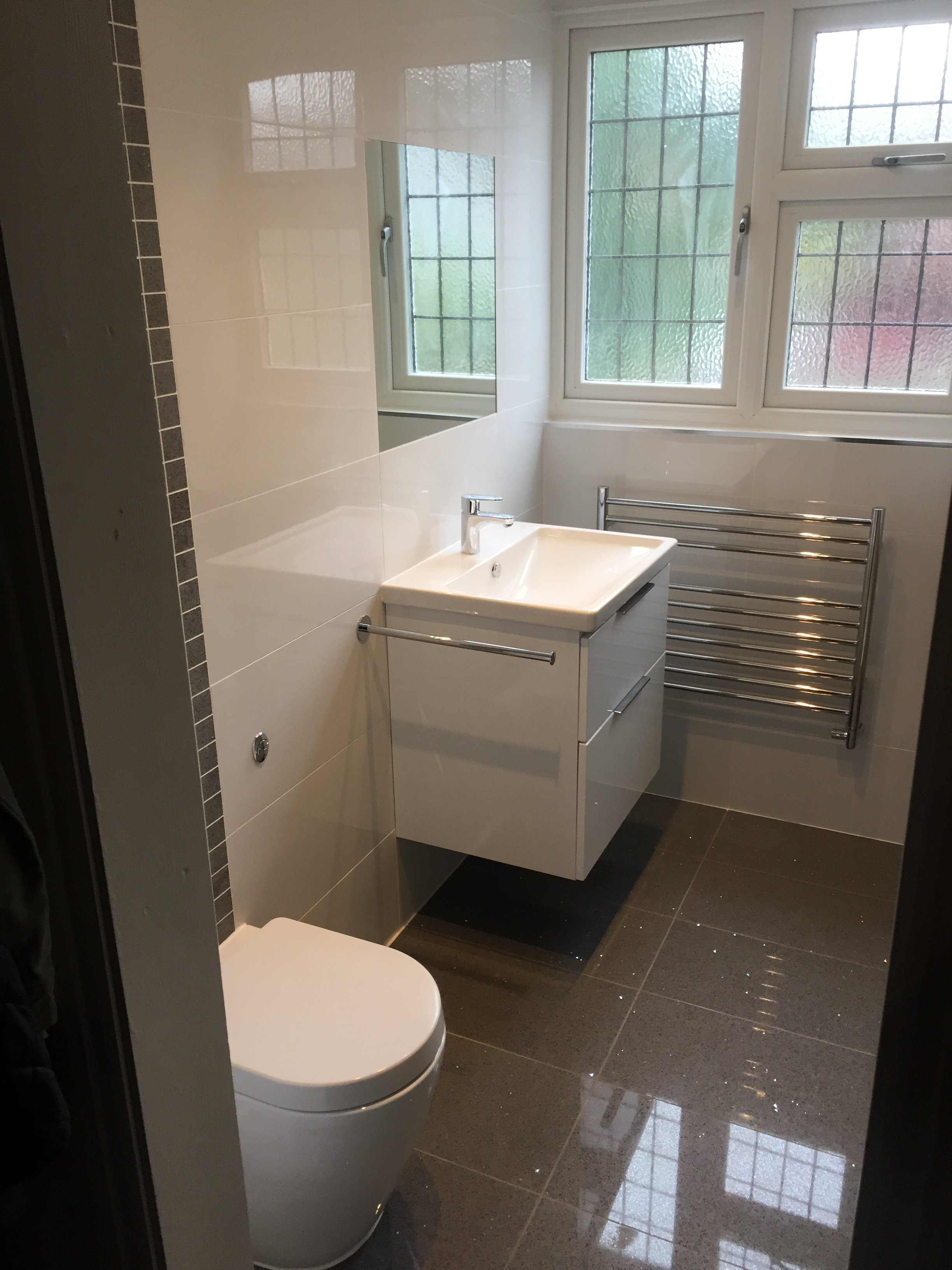

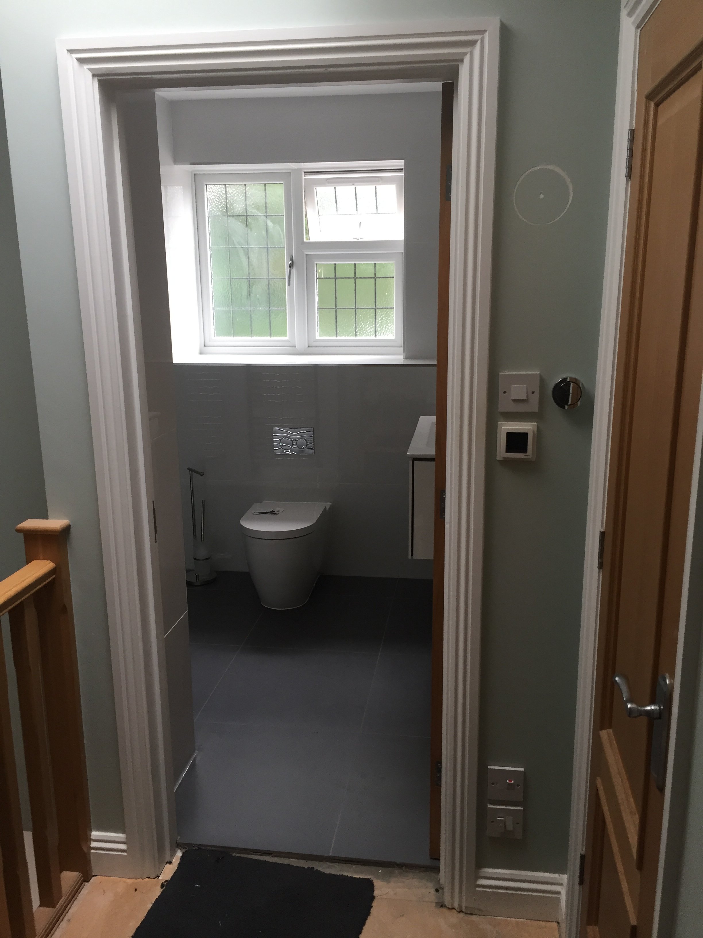

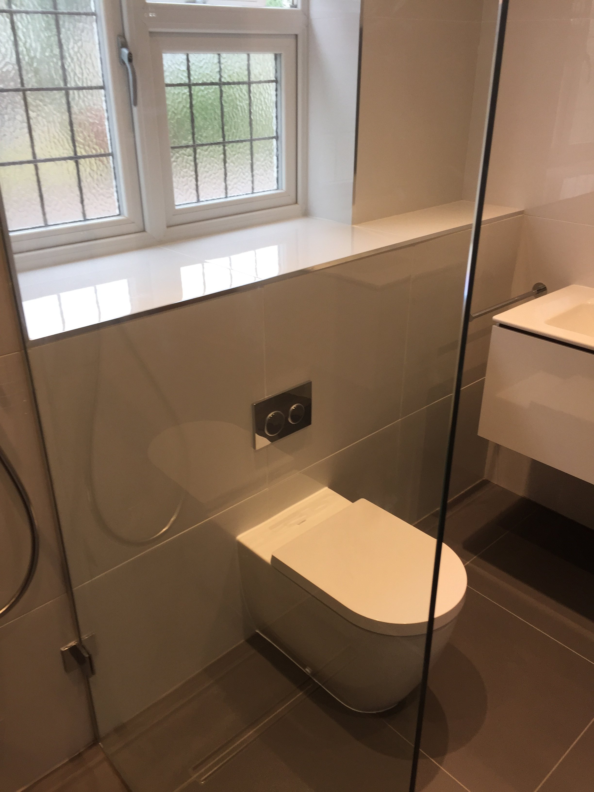

60 holes later , all finished apart from special order screen for ensuite which is being delivered in 12 weeks :mad:
How do you access the toilet cistern if something goes wrong in there?
Will be access from behind in the other room
Through the flush / button plate
It's a Geberit concealed cistern - you can get everything serviced/replaced through the push plate.
Edit: and the one in the ensuite has a cupboard behind the wall that the btw pan meets - cistern is boxed in and accessible there.
Damn, the things I learn here.
There is one toilet in the picture with just a tiny flush button embedded in the tiles. I don't think that one would be a Geberit?
Neat as hell Dilalio. Wish I could do bathrooms to that standard!
Thanks. Wish I'd taken photos of the original rooms before the works. Quite a difference - basins and wc's were in different locations and were just close-coupled and basins on pedestals, the family room had a bath in it with a standard shower cubicle in the opposite corner.
Nice job Dilalio i bet that took some sorting out you should be proud of that one thanks for sharing it with us .

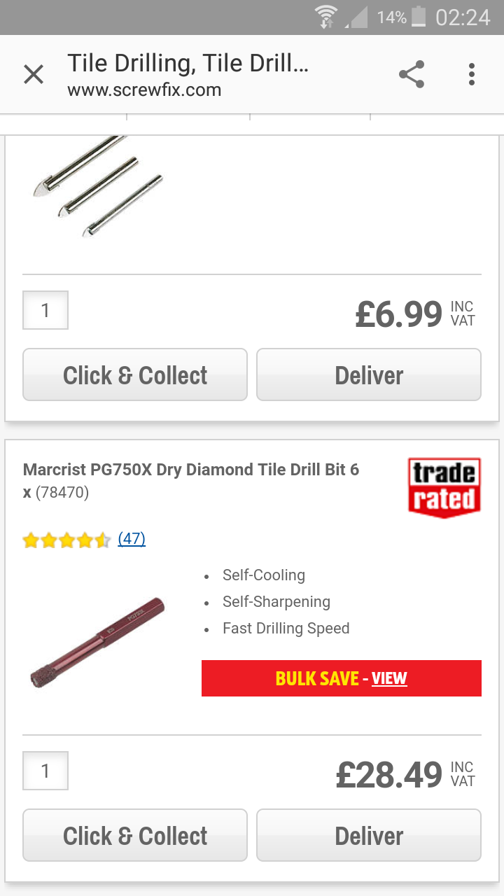

Here is some info on the drill bits that maybe of some help to you screwfix do quite a range all the best regards kop .

I think it helps here that the bathroom is large. It's hard to make a cramped bathroom look nice like this.

Cheers KOP,
I bought one of those PG750X's and yes, they are good - only problem with them is that it takes longer to get the crap out of the core than it takes to drill a hole :mad:;)
I have a set of dentist tools that I use for intricate work on shower valves/boilers etc which helped with this but still a pain.
I wanted to get the 6&8mm double ended one but my local screwfix didn't have them in stock :(

I always think there's more work in a small washroom because you can't move and need another room for your tools and set-up.
With the right design, planning and products they can look just as effective though! The main wetroom in this job was very cramped when it had the bath in it - creating a wetroom helps make it look bigger and this is true for smaller rooms too as you don't have to have a clunky, fully sealed screen setup.

My pleasure bud i just keep plenty of water on it and keep flushing it out keep up the good work cheers kop.
