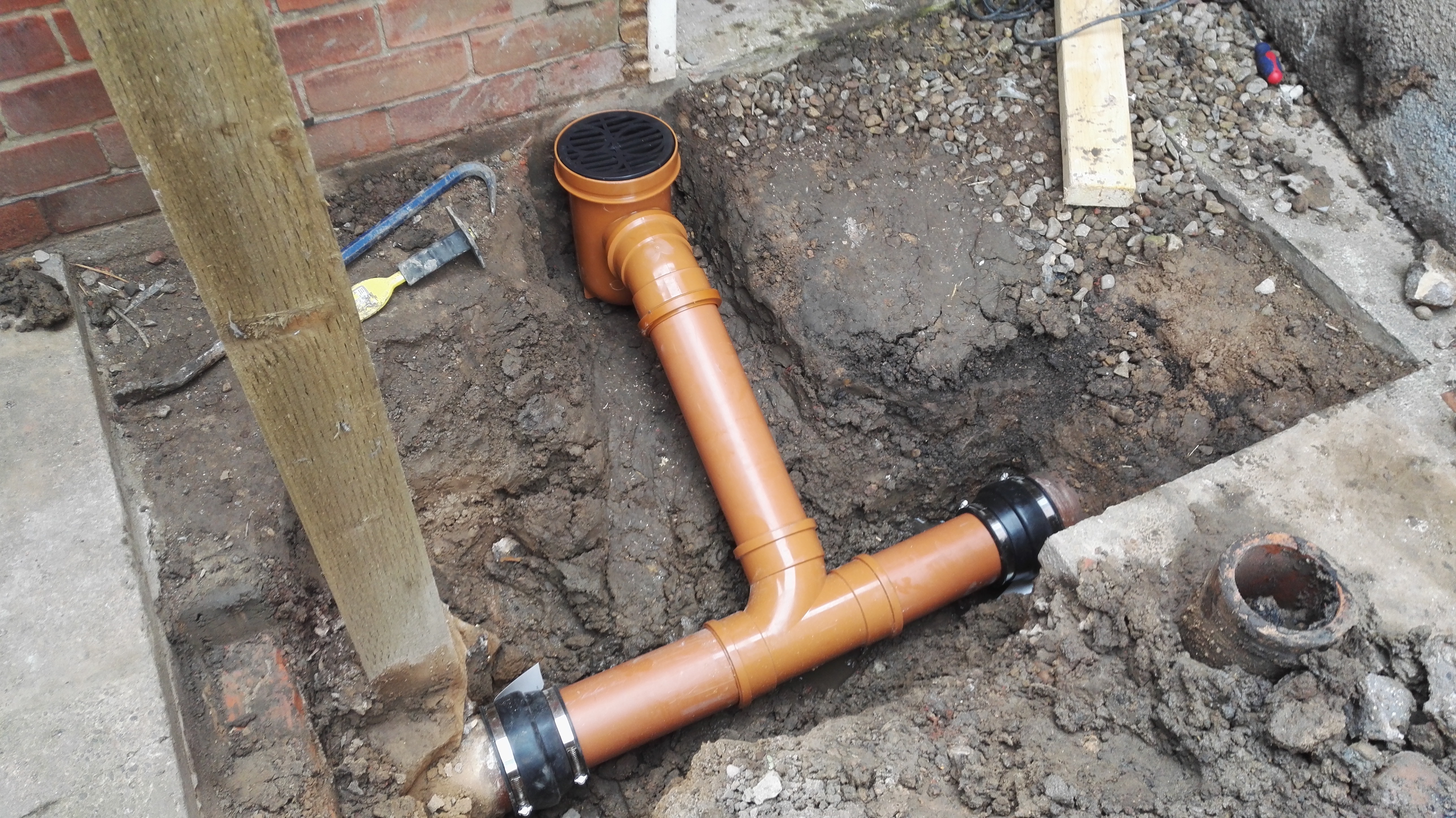

Dare I play devils advocate and ask where the waste of the washing machine is running to

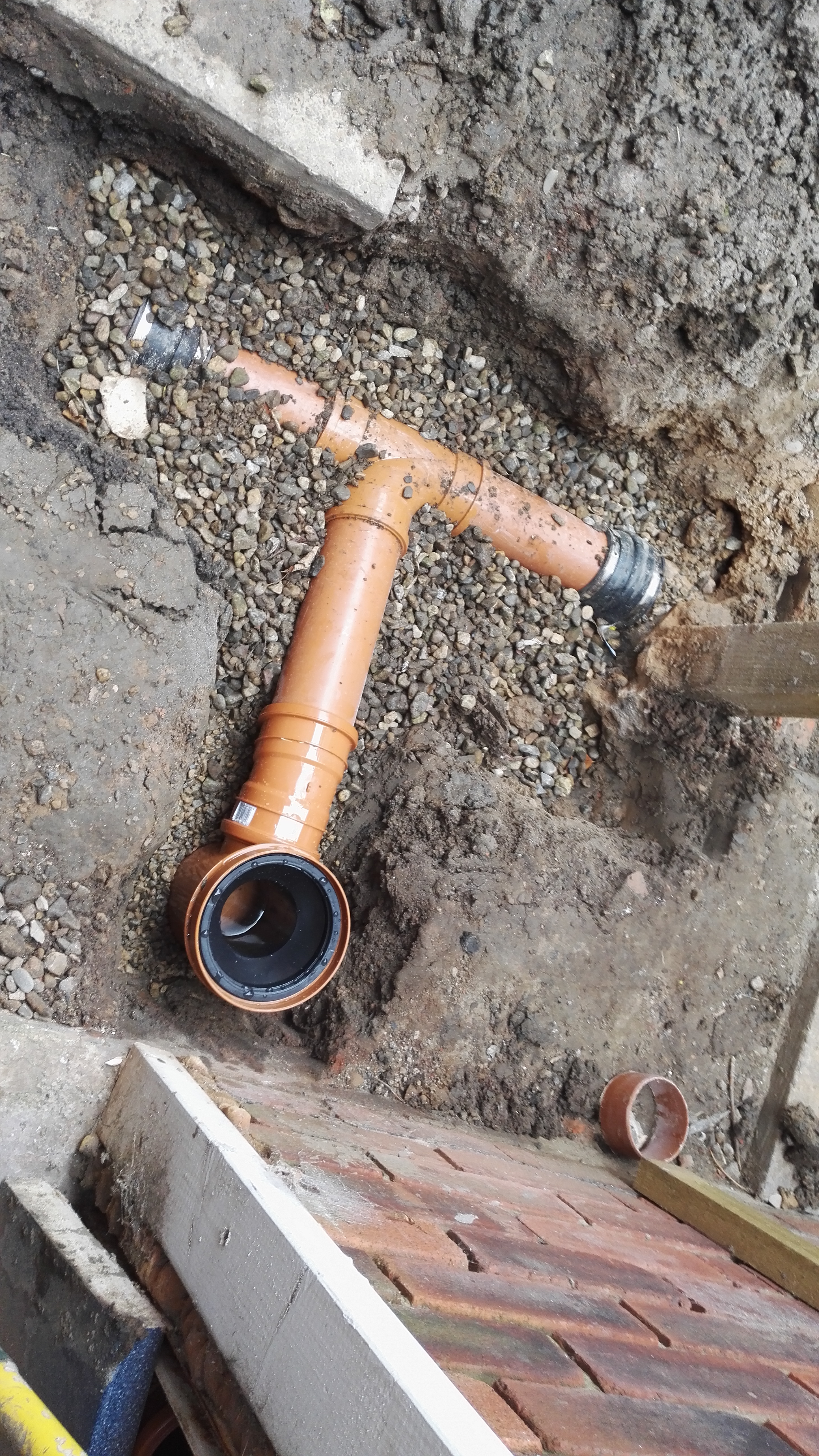

Ive put a bottle gully in just outside of the outhouse connected to the main drain running to the manhole
Please take this as constructive criticism, your 110 pipe should not be straight on top of the soil / clay , it should be on compacted gravel . But tell the missis lol .
Would recommend you didn’t it protects from weight of traffic above too
No before the pipe was laid lol .
But honestly is ok , most builders I know would nt bother
