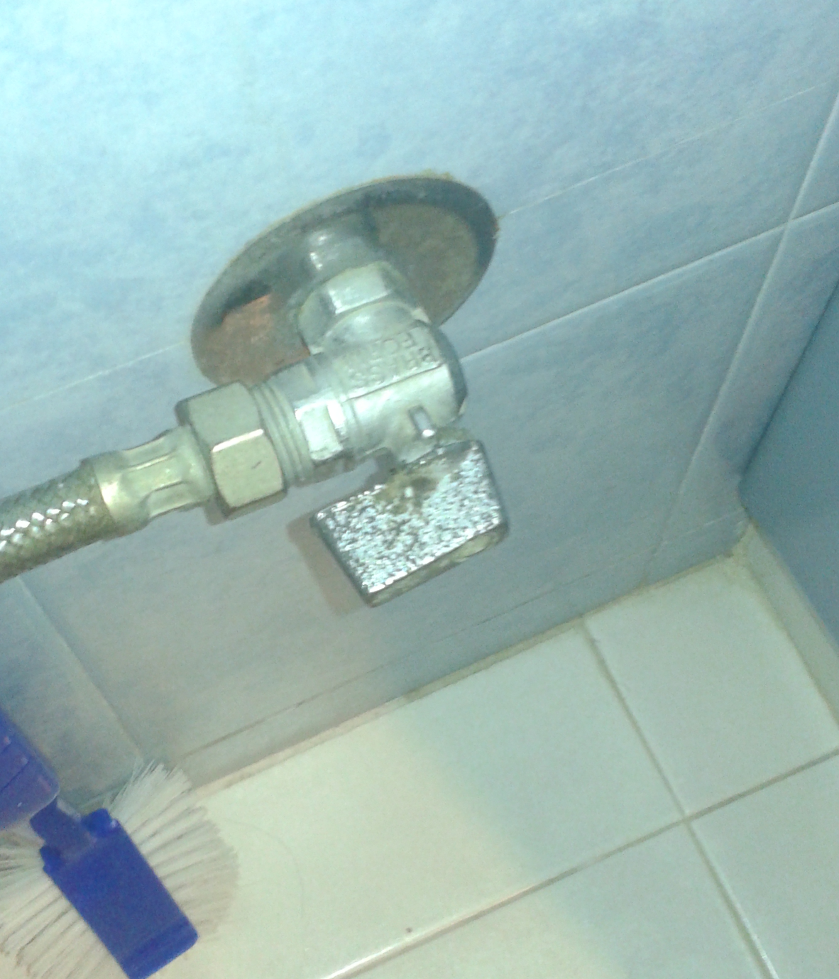

The relationship between pressure and volume regards liquids is often mis.understoodView attachment 40795
I have this valve. I can reduce the pressure by turning it half way closed. Will that hurt the valve over the long run? Thank you.
A partially open isolator might also, depending on the details of the case, generate turbulence which is both noisy and may eventually lead to premature failure the pipework.A better solution is add a flow restrictor in the fitting don't leave the isolating valve 1/2 open it will become siezed and when you need it to shut off it won't . Kop
