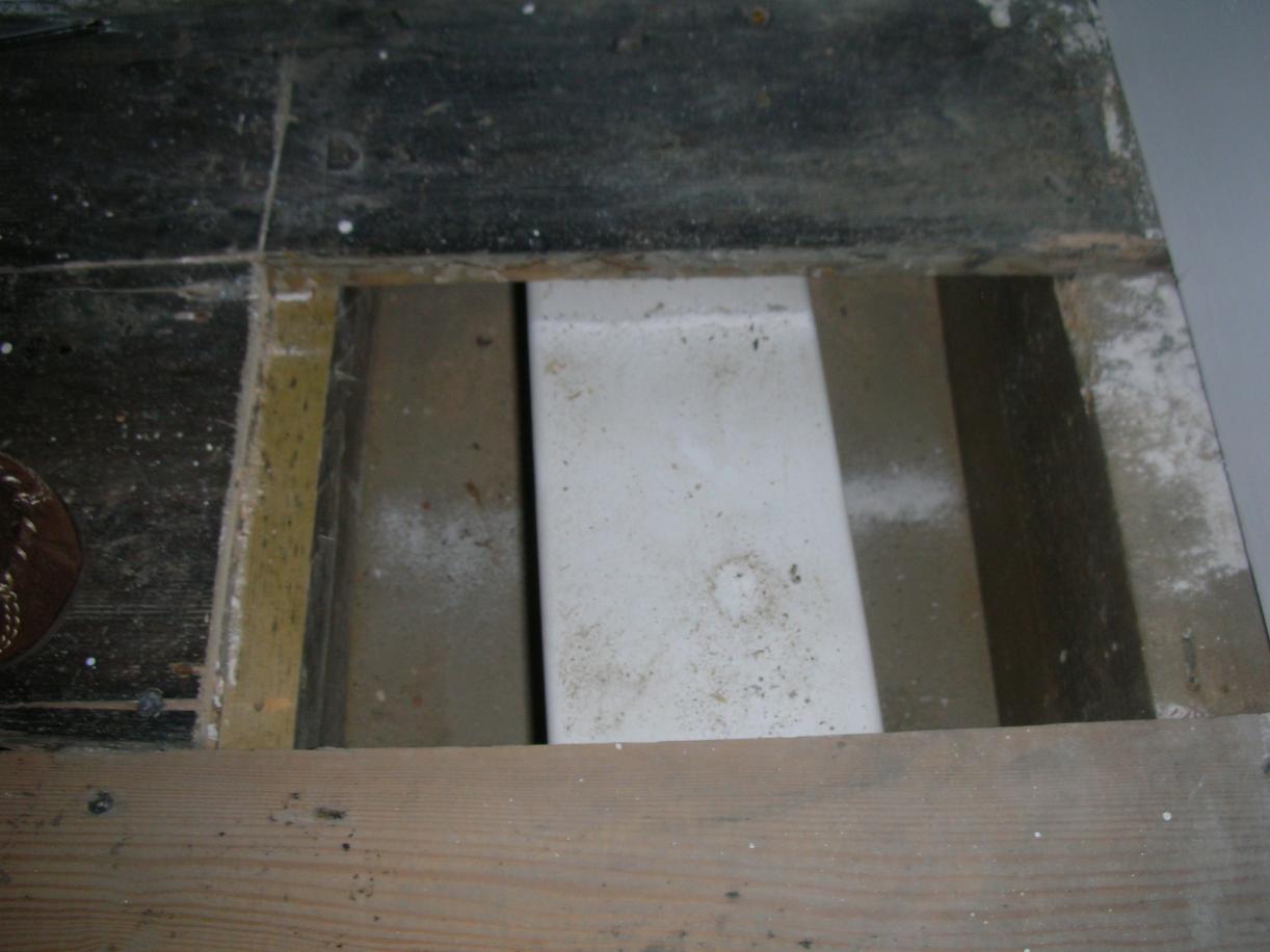

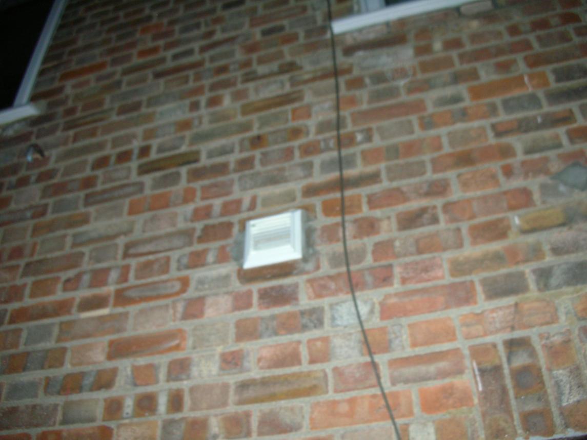

Got a call from a prospective client (i'd done an estimate for them a while back, unrelated works) saying that they had had the chimney upstairs removed and replaced with a new duct within the floor by a local builder (alarm bells are ringing in my head at this point). Trouble is now when they use the gas fire below they can smell burning plastic! 'SWITCH IT OFF' I politely requested, I'm on my way
Turns out that the removed chimney had been substituted with a 4 x 2 wc type plastic extract duct terminating on the outside wall with a 4" plastic louvred vent. I counted 4 NCS's, 1 AR, and an ID as I considered the smell to be evidence of distress
View attachment 4168View attachment 4169

not sure, the job was in Essex but I've since discovered that the builder's name is registered in coventry, I suspect (but don't know for sure) that it's a bogus company trading off of someone elses good reputation, it'll be down to the client and hse to pursue

no one likes a grass (if that's what you're driving at) but these are peoples lives we're talking about and I couldn't give two iotas whether submitting a RIDDOR makes me unpopular with anyone on or off this forum, these people are my clients and I owe them my very best abilities, there's a little more going on with the works that the builder has done but this is no place to discuss it.
As far as the individual elements that made me submit the RIDDOR I've only cited the count for the ammusement value, to the forum members and my fellow independent traders. I'm sorry that this has upset you but when you work all day on your tod sometimes it's nice to share your experiences with others in a similar position.

...well I'm a bit of soft touch, these very decent people were proper done over! I know what you mean, there's always risk in giving free advice and customer care but the good news is I start the remedials on their plumbing on Tuesday, their heating on Wednesday then they want a quote on re-fluing the fire, so in this case it turns out ok
