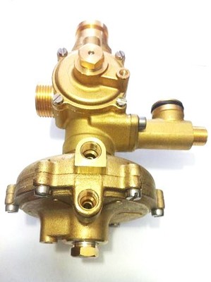

apparently this is what i need the 6 screws are at the front of the picture (can only see 4 of em though)
if you see what i mean:confused5:
can you indicate where its leaking from ? if it's from the bit at the bottom with 2 washers on it this bit only can be replaced
Its actually leaking where from where the front plate screws on (held on by the 6 screws) thats why im thinking this front plate surely must unscrew why have screws if they cant be undone? waited a week for guy to come cos he is only one around that will do lpg
get a second opinion as most parts can be obtained for these valves but you should be prepared incase the repair kit does not work - sometimes replacing the complete part is the best answer (e.g your a diesel fitter would you repair a starter motor or replace it ?) same sinario the choice is yours at the end of the day.labour does seem a little steep but depends what area you are in
i fit a new diaphram to that very boiler earlier today.. i dont think he is being very truthful if he is saying its sealed for life.. get someone else who isnt after ripping you off round..
just get a diaphragm repair kit, universal ones available, and get a new engineer, 1 hour to muck about an replace, if that fails then a new unit may be needed, not needed in most cases.
