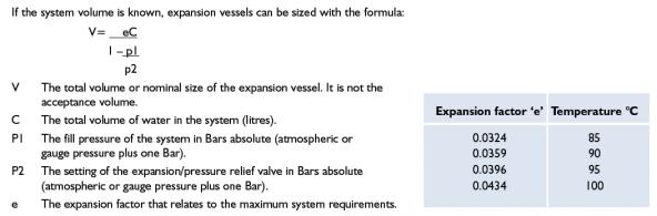

How we can be saying with some certainty that 12L vessel will do, is a worry, how big is the system? i.e. what is the water content ? Where is the boiler / expansion vessel to be located ? What is the cold fill water pressure going to be ? What is the selected vessel charge ?
These are the things that a heating engineer would be considering when selecting the right size & set-up for a replacement external expansion vessel.
It is this knowledge that you would (should) be paying for if you employed one Vic !!
Happy to help you fix your own but please find out the whole story otherwise things can & do go very wrong.
