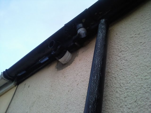

A picture would be a great help large 100 mm pipe is the flue which vents to atmosphere but there are strict rules on positioning Small 15mm pipe is saftey valve which also just goes out to a safe position this pipe can release boiling water Medium pipe usually white plastic 22mm is condensate this must go to a drain soil or rainwater pipe

here's the pictures
the flexi pipe runs down the roof for about 200mm.
this roof is on the kitchen and there are a pair of patio doors directly underneath where these pipes are

safety discharge pipe needs altering(copper pipe sticking out of wall)
condensation pipe should run to a drain, may need running into 1 1/2 waste pipe(stop it freezing)also cleanser needs a minium of 2hours (sentinol x400)yours would be a very dirty system so would have been better with power flush.
flue looks to close to gutter(look in installer instructions for min distances)
also check benchmark been filled in.your house insurance will be invalid if there is a claim with anything to do with boiler ie explosion,leak etc.aslo if not installed by a gas-safe engineer,also your warrenty on boiler will be invalid if benchmark not filled in,boiler registered with building control

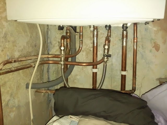

Also looks to me the DCV is not first off the mains in and the filling loop is also connected to the flow and not the return.
just checked the online installation guide and it has been connected to the flow.... what does that mean??
Very bad practice.Cold water shock on a flow pipe is greater on the flow as it leaves the boiler hotter than the return,returns to the boiler if that makes sense.
the vaillants go into the flow

the blow off is ridiculous guess what 3 bar plus of scalding hot water will do from that pipe
condense definatly looks suspect and a bad spot to leave the blow out what amazes me is how much of a mess some people can make of a straight forward install
did he leave his horse tied to your gate? that flue looks way to close to the gutter. hard to tell from the pic but it still looks close, and the blow off and condensate. not how it should be done me thinks, is that condensate being run off in hep? pretty sure that aint allowed either.
highly unlikely that this has been installed to spec and by a gas safe engineer
you sure i thought it went into the right hand pipe which is the return
no the ecotec 831/824 it comes off the cold inlet using integrated valve and goes into the left hand pipe as you look from front so into the flow..i thought it was strange but hey ho
back to this one the prv is wrong the location of flue in relation to soffit is wrong the condensate looks wrong i bet a pound to a pinch of poo this was done illegally
Should not leave flexi connected. Should be removed and blanks put on each end. Can void your flood insurance cover if it isn't done.

from the look of it the boilers a main/baxi or potterton flue can go as little as 25mm from eaves ,prv is wrong,and loop should be on return the whole install looks a mess and condensate not installed to building regs
looks like a right bodge job sorry to say so, im only nvq2 but fit boilers under the watchful eye of my boss and if i left an install like that i would be sacked. very ropey install
