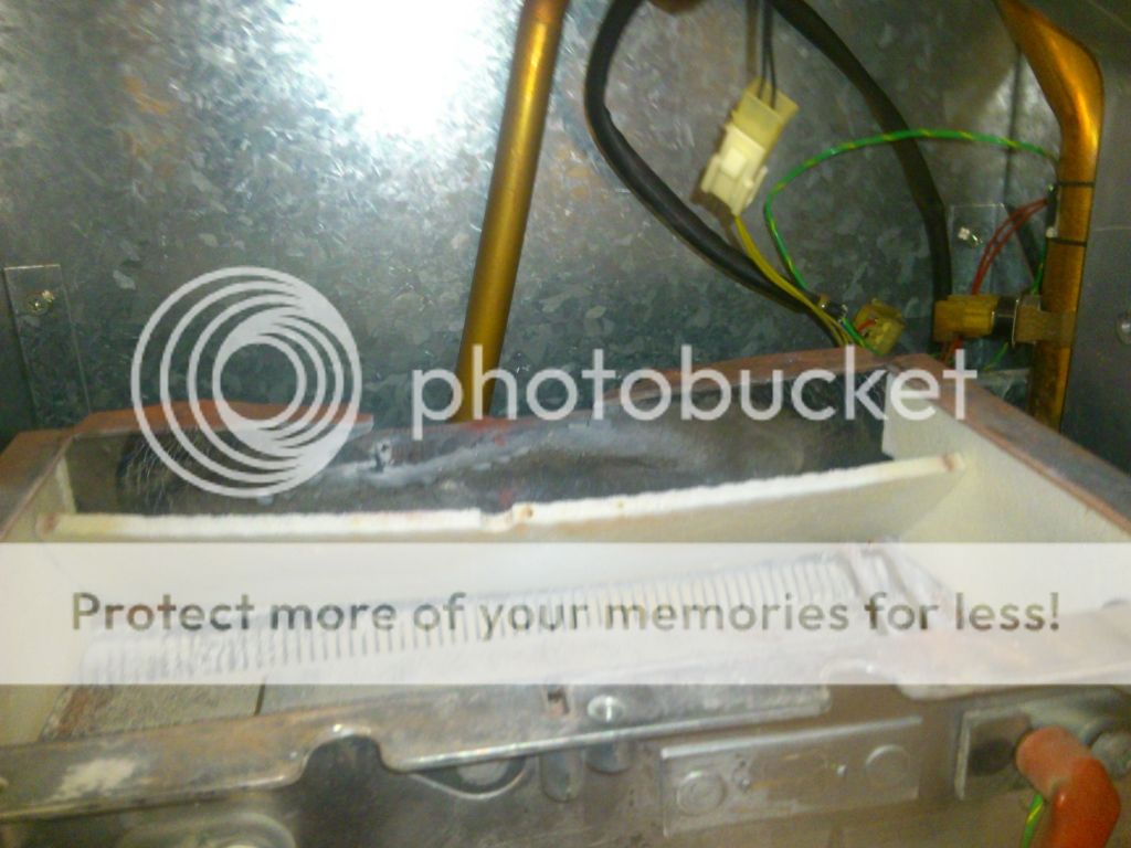

My supervisor sent me and another engineer to fit a fan he diagnosed to an M series ICOS earlier on. Fitted the new fan and BANG! Blew the board. So I checked with Parts Centre to make sure I had the right fan, which was wrong. The engineer I was working with had one on the van, so we swapped it over and put another board on it. It fired up and then BANG!
Switched it off and it wouldn't fire up again. I'd already checked the continuity between the wires and there wasn't 140v DC at the fan, so I thought the wrong fan had blown the board. So I began looking further and tested continuity between each wire with another. Bingo! Continuity between 2 wires. So the wiring loom is at fault. But why? Oh, here's why!
As you can see, the insulation pad has fallen, causing the downward fire to deflect to the alu combustion chamber, melting it in to a hole and then melting the wiring loom! The alu was actually soft, I could crumble it with my fingers. To look at it, you wouldn't have seen any of this due to it being at the rear, it was only when I took the burner off I found it. I've heard of this happening before, but have never seen it and I have been checking them every time I do something more than topping up the pressure.
The cause is the earth pins, which also act to retain the insulation pads. On the M series and early HE boiler, the pads were squared off, so easily fell in after time.
This is a serious situation, the things could easily melt completely and the copper gas pipe sits behind it. I recommend that EVERY time you work on one of these boilers, you take the fan and burner off and inspect them. Any kind problem, AR them and get the replacement parts (which have now been redesigned).

May I also draw your attention to TB108!
Just read it, all the ICOS's I work on have the ignition/detection probes in the corner. So they're the modified burner, so this will be less of a problem. Don't think I've come across one yet (pre 2003) which has them in the front like pictured in the TB. I will start checking the insulation boards as a matter of course all the same.

Ok, so last week I A.R.'d 6 Icos/Isar and I.D.'d this one. The one had got a snapped/sheared off hex bolt at the back of the burner. The other was seized in position and I snapped it. The insulation pad at the back had started to move, causing the alu to get hot and the bolt to seize.
I came across another with the center bolt seized. I applied some WD40 and worked it backwards and forwards and it came out. Same thing, pad falling down. Plate heat ex was also blocked up. A.R.'d boiler and ordered in the new pads, earth pins and a heat ex.

These pins should be checked everytime you work on these boilers even if its only a small job. I cant believe the amount of boilers serviced regularly that have still not had the new pins put in and then they warp out of shape aswell so need replacing aswell.
Done loads of these on local authority contract,best tool for removing the pins is a Bosch 3.6v driver with a right angled attachment fitted and an 8mm socket,sometimes the pins snap off then your in big trouble.All m series boilers require probes replacing,some don't have any in at all as they have dropped through the heat exchanger into the sump.Later boilers require probes checking to see if they are ok,this can be done by removing the front 3pins from the burner and levering the burner up slightly with a screwdriver just enough to see the pins,the ones nearest to you can be checked with a small inspection mirror.
Something I forgot to add in my previous post if you find one of the pins at the back of the burner seizes up when trying to remove it,rather than force it and snap it off,the burner can usually be lifted enough to replace the rear probe without having to fully remove burner,sometimes long nose pliers have to be used
