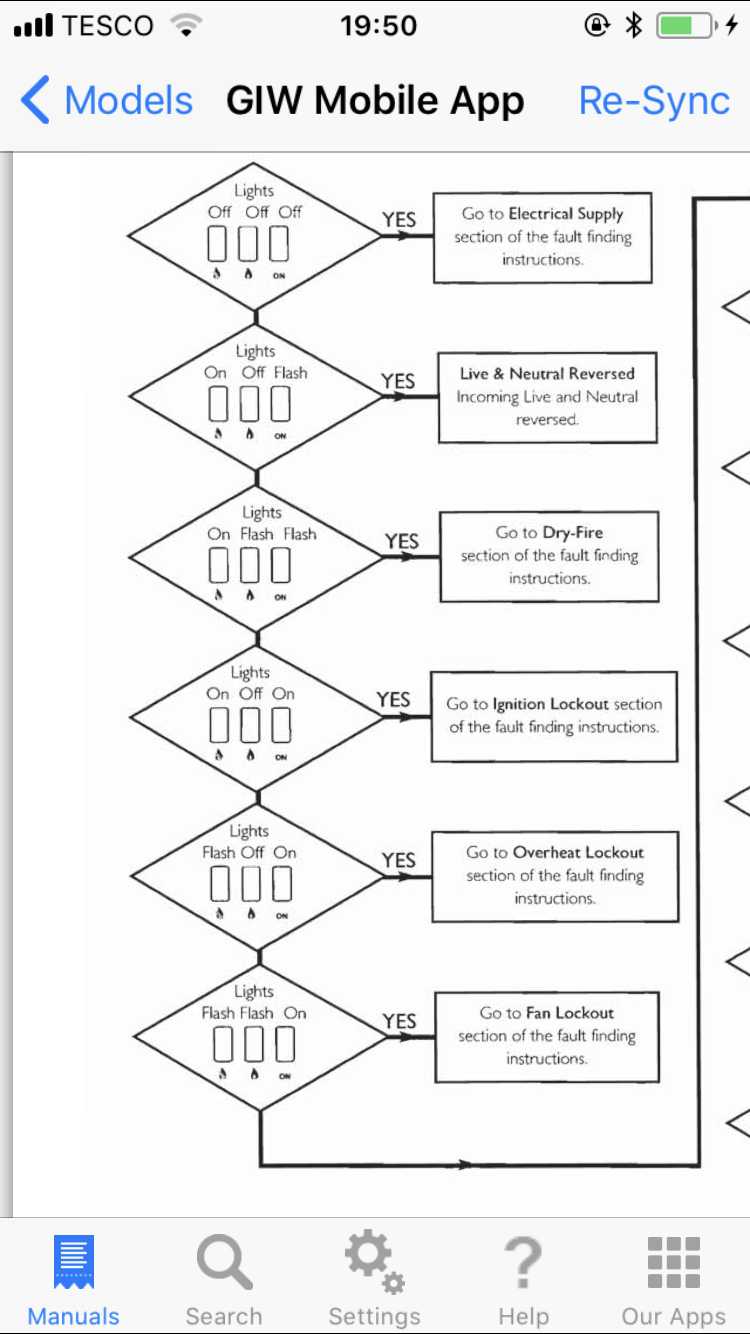

Yeh I randomly come across it one night an got to admit find myself referring to it all time
It should do mate once it’s actually locked out,that’s from the MI’s the sequence of lights on pcb once locked out indicate roughly why it has locked out
