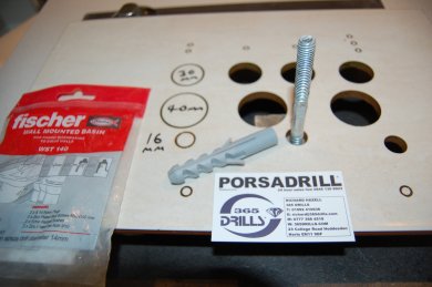

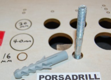

To fit that basin you will be best off using that Fisher fixing kit.
Just drill a 12mm hole into the masonary. And fit the peg.
Sorry about the image but this is from a set of pics where we show people how to drill holes through a tile to fit a fischer fixing kit
http://www.*********.com/jpgs/drillingtiles2.jpg
The tile is drilled with a 16mm hole and a 30mm hole with PORSADRILL diamond tile drills
Thanks for that - yes, I've fitted the Fisher bolts (14mm hole for plugs according to package).
