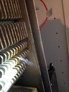

Been to a boiler this afternoon, Baxi solo, same as a promax?
fixed the initial fault but noticed water in combustion chamber and staining down the outside casing where the manifold bolts throughout the case. It looks like the hex is leaking out of a round recess on the right side of the hex, dripping onto gas pipe from gas valve to fan etc. it's hard to tell as there is only a 5mm gap between this and the combustion chamber side panel.
Is this a common fault, and will it require a complete hex replacement if so? If anyone has done this is it feasible or is the boiler a write off?

I went to one the other day with the same problem.
Sadly it's an insurance job so I'm back there tomorrow with a new heat engine and fan.
Happy days.
Hx above the burner, burner above the fan.
Hx leaks into the burner which floods the fan.
Had one for a friend the other day. Got a one off payment fix in the end from baxi as it was cheaper than we could buy the hex, I think it was about £275 maybe plus vat.
Had one end of last year, as above got curt to take fixed cost repair, they nearly had a new boiler by the time all was done. (£250ish IIRC)
Phoned Baxi this morning, definitely knackered heat exchanger. Quoted £274 +vat for a replacement plus whatever else was needed once you get stuck in.
Passed on to Baxi for a fixed fee repair.
