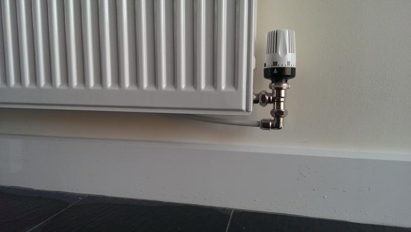

Hi All,
I'm decorating one of our bedrooms. I want to hide the radiator pipes behind the plasterboard.
I've bought some plastic pipe and speedfit connections etc. What's the best way to actually do it?
I'm assuming I'll need an outlet plate for the pipes to come from the wall (behind the radiator). In terms of the actual pipework can it just be threaded behind the board and connected? How much of a bend can the pipes take?
Also, what is the best way to connect the pipes to the radiator... Ideally I want them to connect to the valve from the side. So would I need an 1/2 (or 3/4) inch female elbow to 10mm compression?
Thanks all 🙂
Any advice/links/photos would be appreciated.

Ahhh... okay, I see. So it's a 10mm pushfit and at 15mm compression the other end? Is that right?
Great - that makes a lot of sense now! Thank you so much!
Also, if you don't mind... is there a 'best practice' way of running the pipes behind the plasterboard? i.e. will I need pushfit elbows or can the pipe bend enough to run from the floorboards, straight up and down into the rad.
you will need elbows at the top where it exits the box/wall as it wont bend that tight
slow curve you will be fine but it wont do anything sharp
hope this makes sense
Thanks Shaun.
Just been thinking about how I'm going to do it. At the minute the copper 10mm pipework is under the floorboard. This itself is not an issue as I can just cut the pipe and connect the plastic pipe with a pushfit. I was then planning on feeding the plastic pipe up (vertically) behind the plasterboard and out a dry wall back box and from there feeding it to the radiator values.
I can't see how to get the angel right, even with an elbow. I can see how it would work if the pipework was coming DOWN the plasterboard. I could just connect an elbow and that would flow nicely into the radiator from there. Come up from behind the plasterboard I think I'll need two elbows for each pipe.... to get the right angle... is that right?
Sorry for the essay!!
Thanks Shaun.
yes use two elbows (like a u shape) so thats 4 elbows in total per rad
blue are elbows, red pipe
left is face on right is side view
