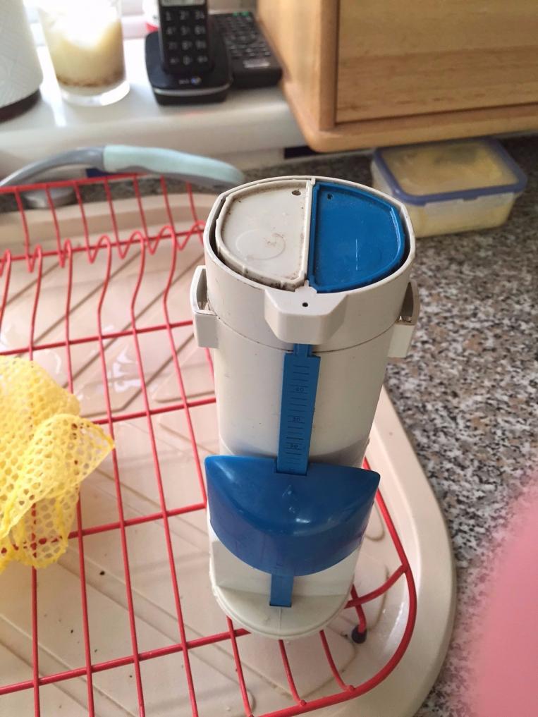

Can anyone identify this syphon type please and where I might get one. One of the lugs on the syphon where it locates on the fixed part in the cistern has snapped off. If I can't get a new part I will probably have to change the toilet as the retaining nut is located under the cistern inside the toilet and is inaccessible. To remove the cistern would undoubtedly break it. I live near Thetford in Norfolk.
Attached is a better photo of flush valve part I need

Not sure someone on here might know or email photo to toiletspares.co.uk and see if they can identify it.

Before now, when faced with an unknown flush valve, I've taken the old valve to a merchants to see if it fits the cradle of anything else, turns out that a good few of them are interchangeable. Might be worth a try.
That does look like an old Geberit valve, if I remember correctly, a fluidmaster valve fits the cradle nicely.

I'll take your advice and not use them but I only put a block in this week as a friend gave me them. The flush valve packed up before that and I probably broke the retaining lug myself. One part of the valve had broken inside which I removed, it still works on one button. At the moment it's sort of ok have it secured to the overflow pipe to hold it steady.Will do as you suggest and check out plumbing merchants for a suitable replacement, regards
