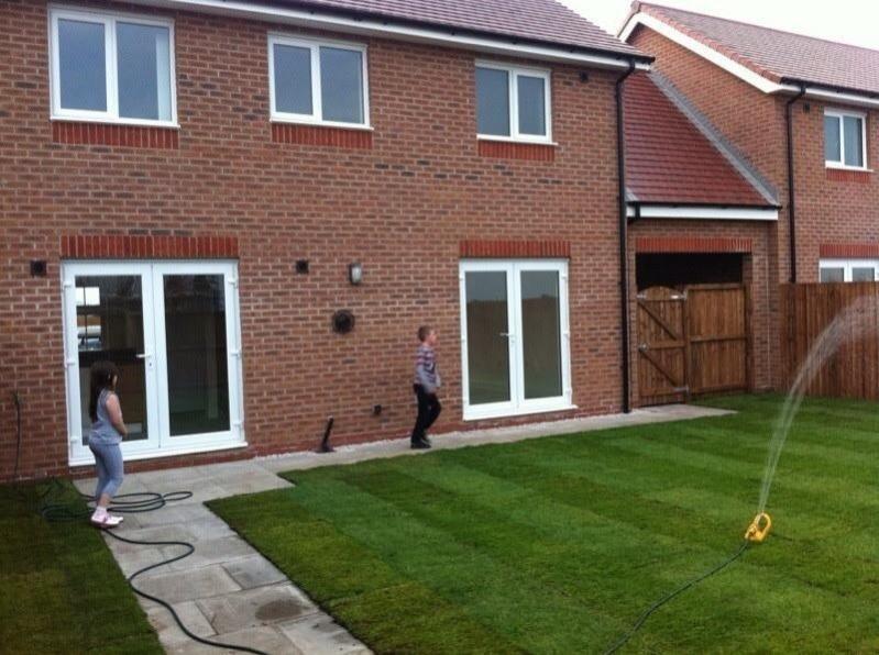

image.jpgFlue is black dot in the middle of centre wall. Quote to extend up was from corgi engineer. 300mm above conny roof and 500 below window. Saying pipe is not allowed was Anglian sales saying it was the law.
if anglian wont put in your conservatory then youll have to go elsewhere or take their advice. I assume they have had their fingers burnt in the past and just say this now to save themselves any hassle
I know. But they did their homework and said that build reg state that it's not allowed. :disappointed:
Maybe they should get someone to interpret the regs for the hard of thinking. Btw your first advice was wrong too.
