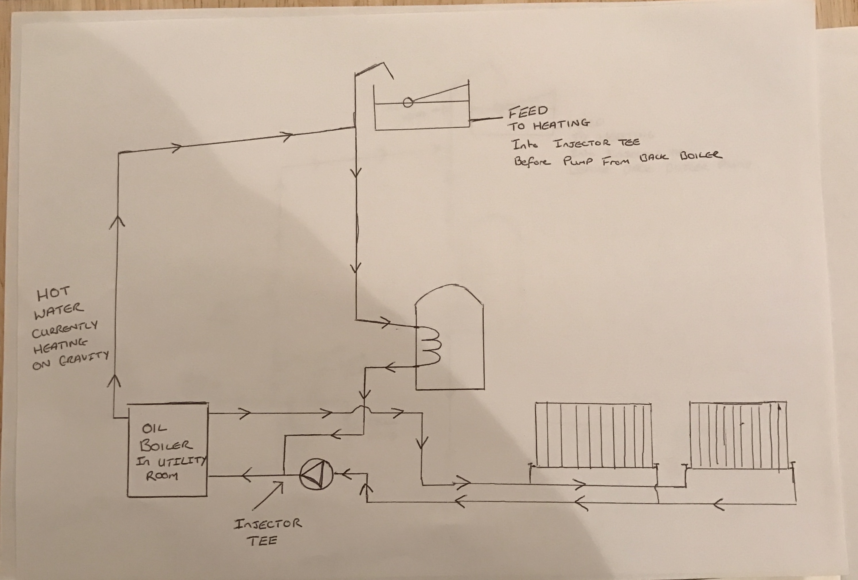

Hi all first timer here...I need a bit of advice on a central heating job..the job is for a relitive who gave me a call wondering if I could move an oil boiler from the utility room of his house to the corner of the garden he wanted to buy a new condensing oil boiler that can be fitted externally for this..I thought this would be a straight forward job but when I went to look at it I realised that the flow to the hot water was separate and on a gravity circuit..and now I'm worried if I fit the pump at the boiler will it pump water out the vent and into the f and e tank..I thought I could seal the system but realised there is a back boiler in the house and this is not a solution to the problem..I will add some pictures to try show what a mean one being the way the system is currently and one of my proposed way to plumb and a couple from the house...excuse the quick drawings any advice would be greatly appreciated..Scotty

Is this drawing correct SimonG..just disconnect and cap the feed to the back boiler because I have a new feed before the pump..and leave everything else to do with the back boiler alone..then fit a magnaclean on the return to the boiler..the auto air vent then in the attic at highest point to clear air from the coil thanks scotty
It's going to be staying it is lit occasionally the cylinder is a twin coil and heats it on gravity from the fire plus there is a pump to pump it around the rads it is vented to above the f and e at highest point..I'm I right to say the feed is ok to cap off because the system will still fill from the new feed thanks scotty
Nope. Not just a case of twinning together.
Need to look at a Neutraliser, h2 panel from heating innovations or thermal store (wouldn't use this for minimal use of fire).
Probably best to remove back boiler and fit new fire back. Not supposed to just disconnect and drill obsolete back boilers.
Did one earlier this year. They had a company in to connect up oil with their stove. They used a twin coil cylinder and screwed it royally. I fitted a Neutraliser, corrected the piping and it ran a treat.
do you think it would work if I just left the back boiler as is with its feed still connected plus put in another feed before the pump like we talked about..I think he will want to keep the back boiler..thanks scotty
