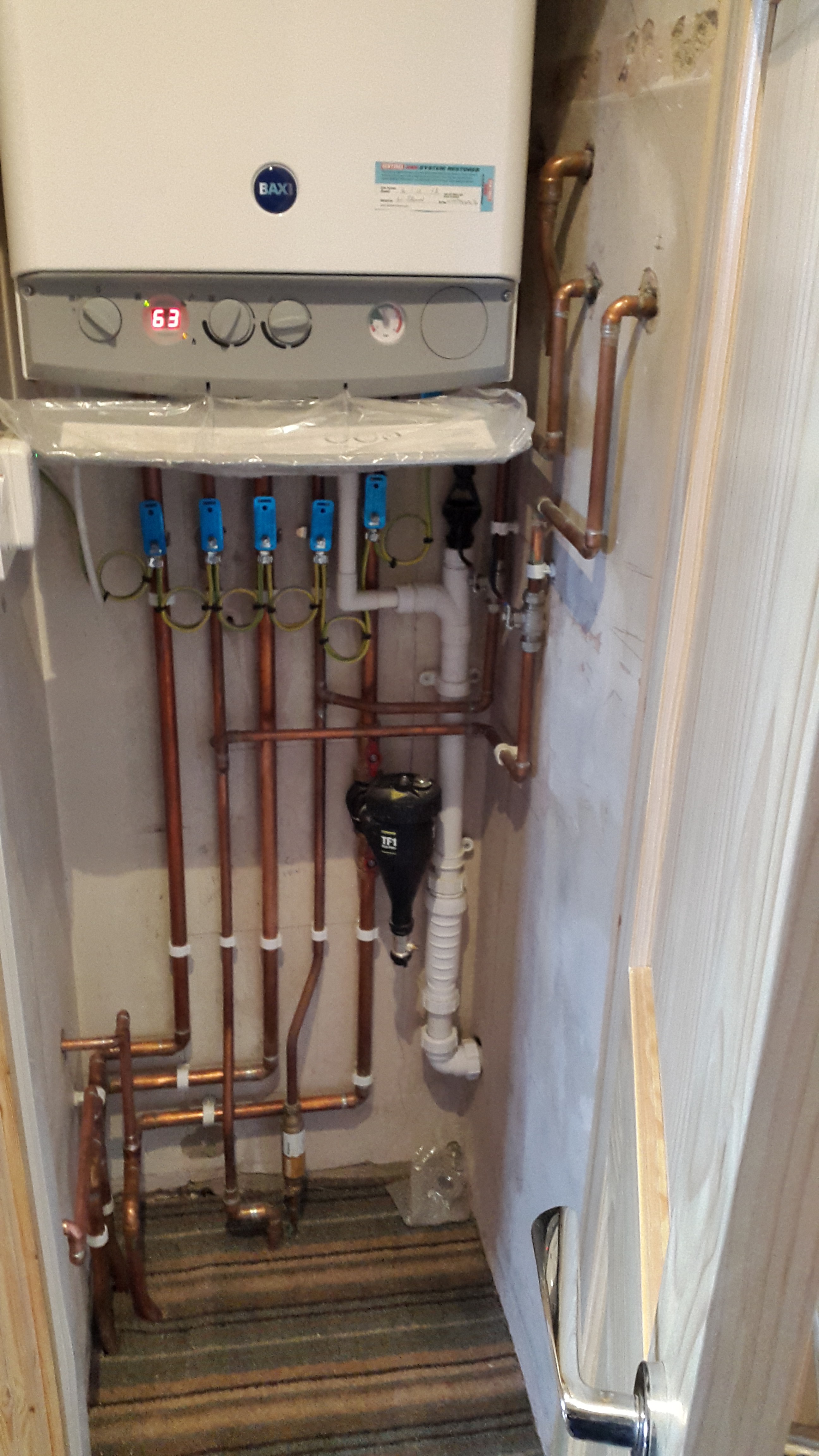

84.6cm wide it is.
Plenty of room there, many are serviced/maintained from through front panel these days anyway, well the ones I mainly fit are. Vaillant Baxi Ideal
Will fit in there nicely I would say these were in cupboards as you can see . Kop
