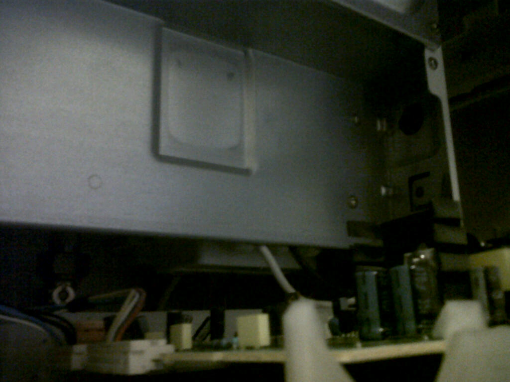

The pic shows the cover removed and main PCB flipped down. The internal fuse is fine, tested with a multimeter today. There is a white box with electrical connections, which you can see at the back just above the PCB with one white and one black cable coming out of it. Is it possible there's a fuse in there too? The box has the flex cable from the spur going into it, and cables coming out. It must be a junction box but I don't want to take anything else apart. Just curious! The PCB is easily accessible but I'm not going any further.
