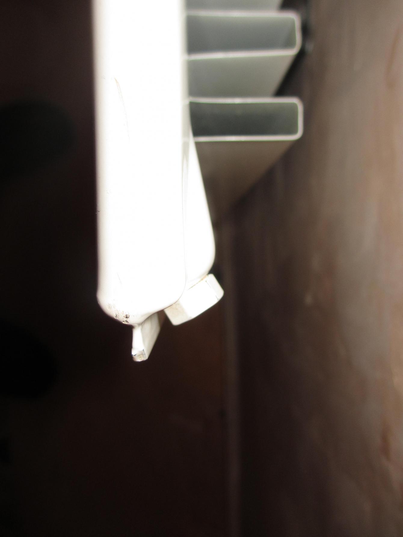

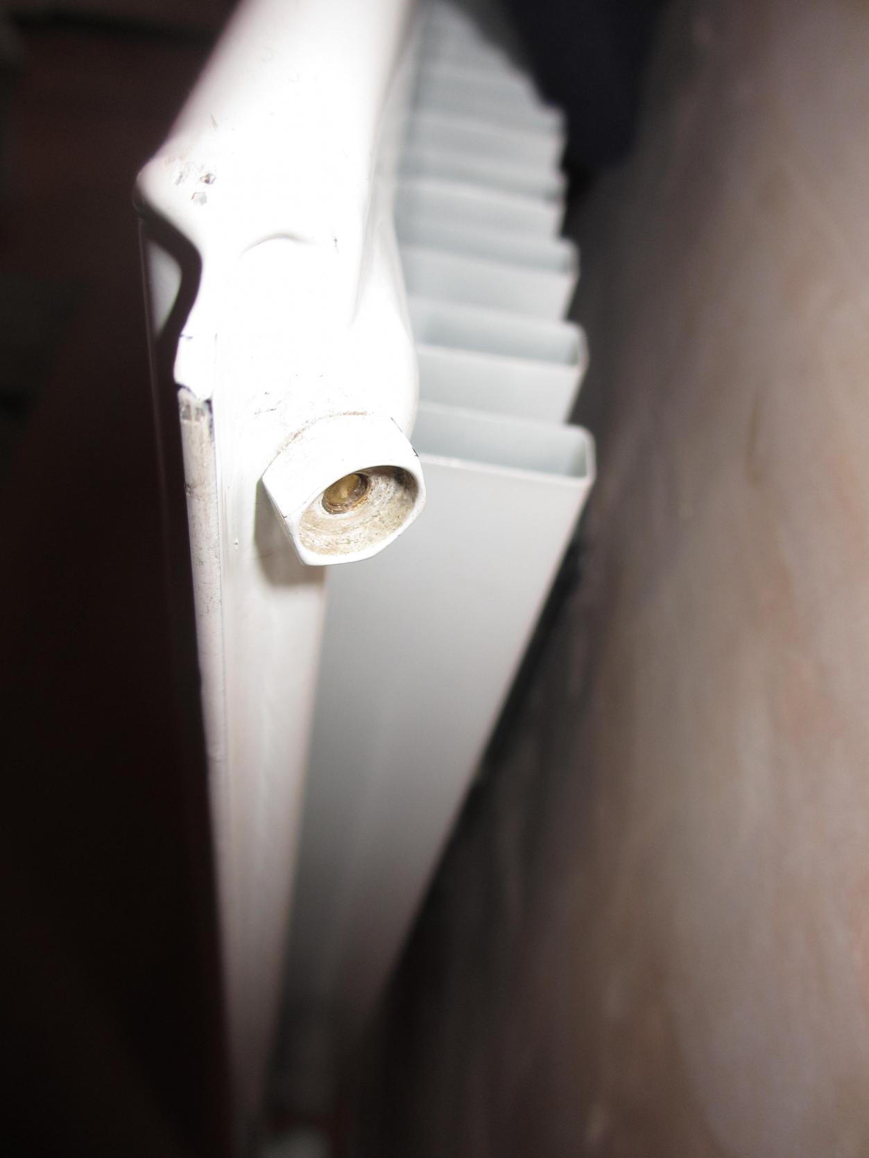

I have a radiator with a broken bleed screw, any ideas on a replacement bleed screw housing.
The radiator is approx 5 years old and came from a trade supplier, who I cannot recall.
3 photos are attached.

Not sure but think they are myson, ring them and send photo, they sent me some free ones, pretty sure it was myson.
My local merchants stock them. No problems getting hold of spares. Looks like Myson About £2 each.
Sure it is one of the newer Myson rads with a fully removable air screw & bushing.
The air screw is very thin & weak on those.
Myson supply them free. They come in chrome finish (painted white on new rad only)
