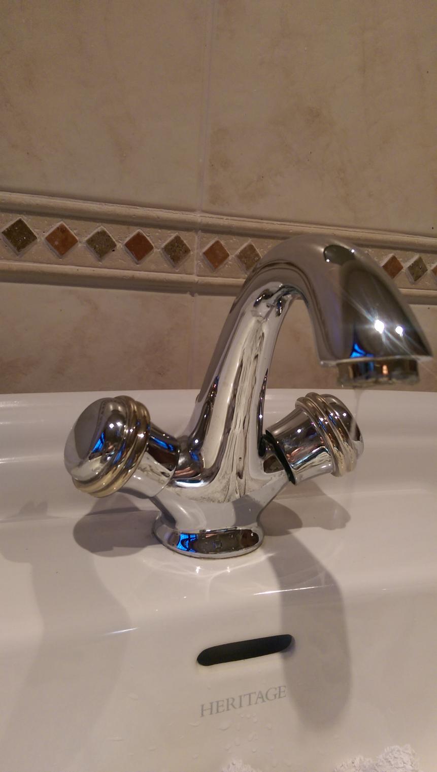

B Backboiler Plumbers Arms member Plumber Gas Engineer Dec 20, 2016 #1 Can anyone identify this basin tap please? It has a single letter "G" at the back. I really need to know how to get the thing dismantled so I can replace the cartridge. Any ideas?
P Phil Plumbers Arms member Plumber Dec 20, 2016 #2 Yes the top dome unscrews from above the stupid gold trim. I think they are Swirl or Watersmith from Screwfix.
B Backboiler Plumbers Arms member Plumber Gas Engineer Dec 20, 2016 #3 Thanks Phil. This site has a wealth of information. I'll give it a try tomorrow.
B Backboiler Plumbers Arms member Plumber Gas Engineer Dec 22, 2016 #4 Thanks again Phil. It was exactly as you said. Stripped down cartridge, lubed, refitted and working a treat.
