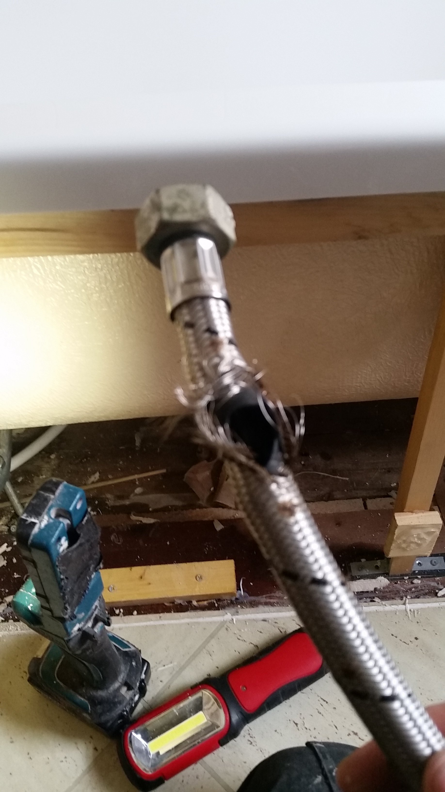

PVC tape maybe? 😉
Mains hot from a combi..
Don't waste your time to repair it. Despite repair it won't hold. And it is merely cost about £6.
Ha ha its my sense of humour, I meant it as tounge in cheek.
I replaced with copper as this is the second one to burst apparently and I'm hard piping most baths I do now anyway.
I was asked to do this bathroom 10 years ago but it needed to be done in 10 days while they were on holiday and must be completed when they return so I refused as I can't work with a gun to my head, in the end this guy took 4 weeks and its been a problem bathroom ever since, bath taps are a nightmare to get to due to the first 300mm of bath being in an alcove.
Only one place for that bud did it have wras stamped on it ? I have had a few call outs to replace burst flexes normally cheap rubbish or fitted incorrectly under strain or kinked. Kop
That's worth a fortune! it's vintage! Don't repair it, it'll ruin the patina.

Been out to so many of these which have split I won’t use them anymore.
Horrible things
I said that not long back, IMHO they're garbage. OK to get you out the Rubbish on a Friday afternoon but its a matter of time before they fail.
