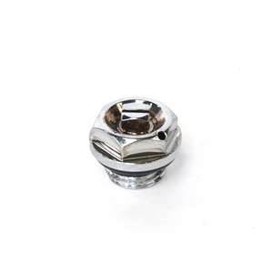

you dont take the nipple out, you take out the thing it goes into. if they are old rads then be carefull!!
this bit, the vent plug.....
