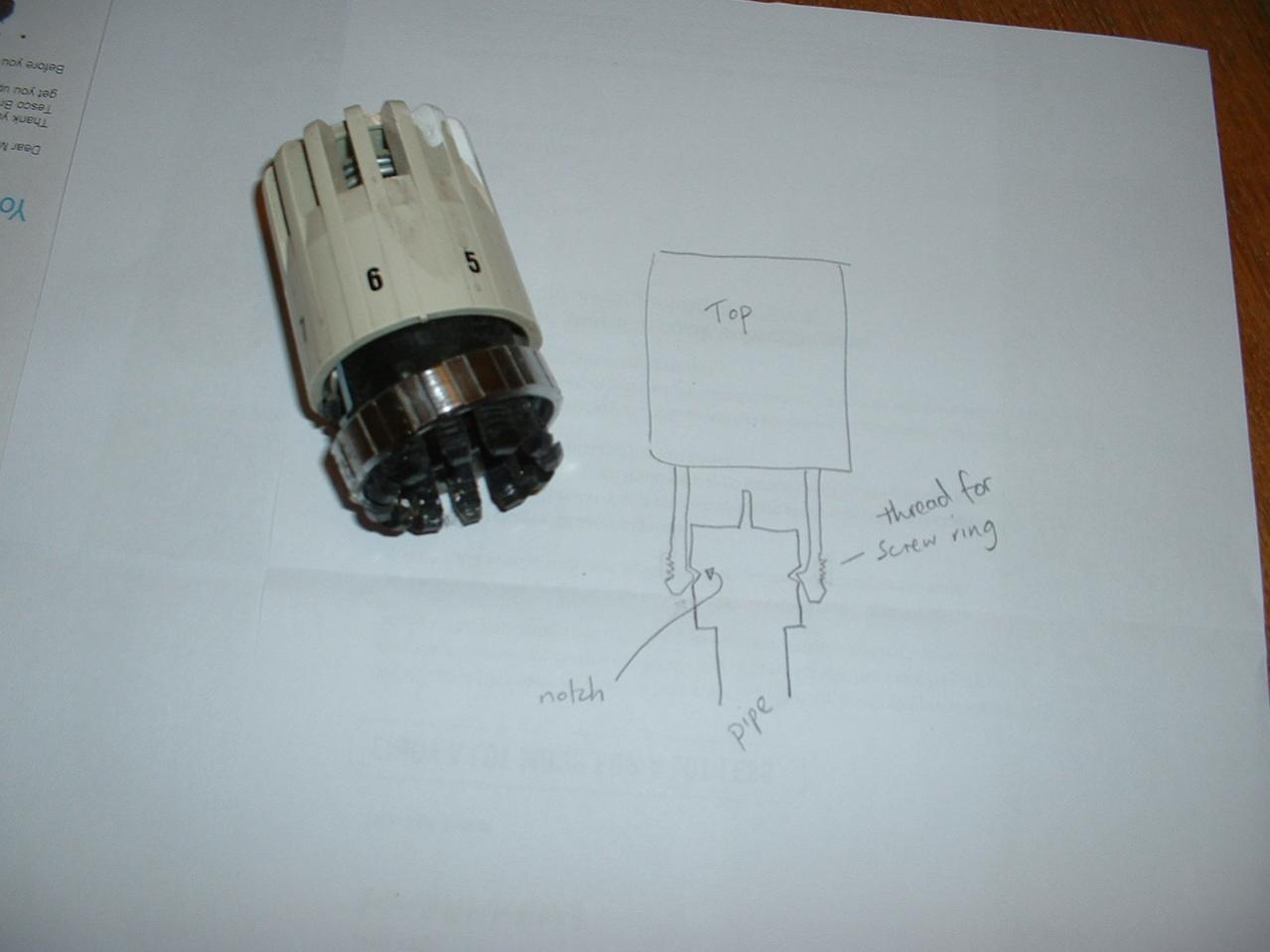

I've got one off. Not the one I wanted but one in the hall. You have to try to prise all the little claws out of the notch. Almost impossible. I only managed because I've got not-stubby finger nails, my husband wouldn't be able to do it! There must be some special tool to do it. They will NOT just PULL off. I've done a diagram for anyone interested. I've tried to get the cold rad one off now I know how but still can't manage it. It's still cold and all the other rads are now even hotter, even though the trvs have been down to min for over an hour.
