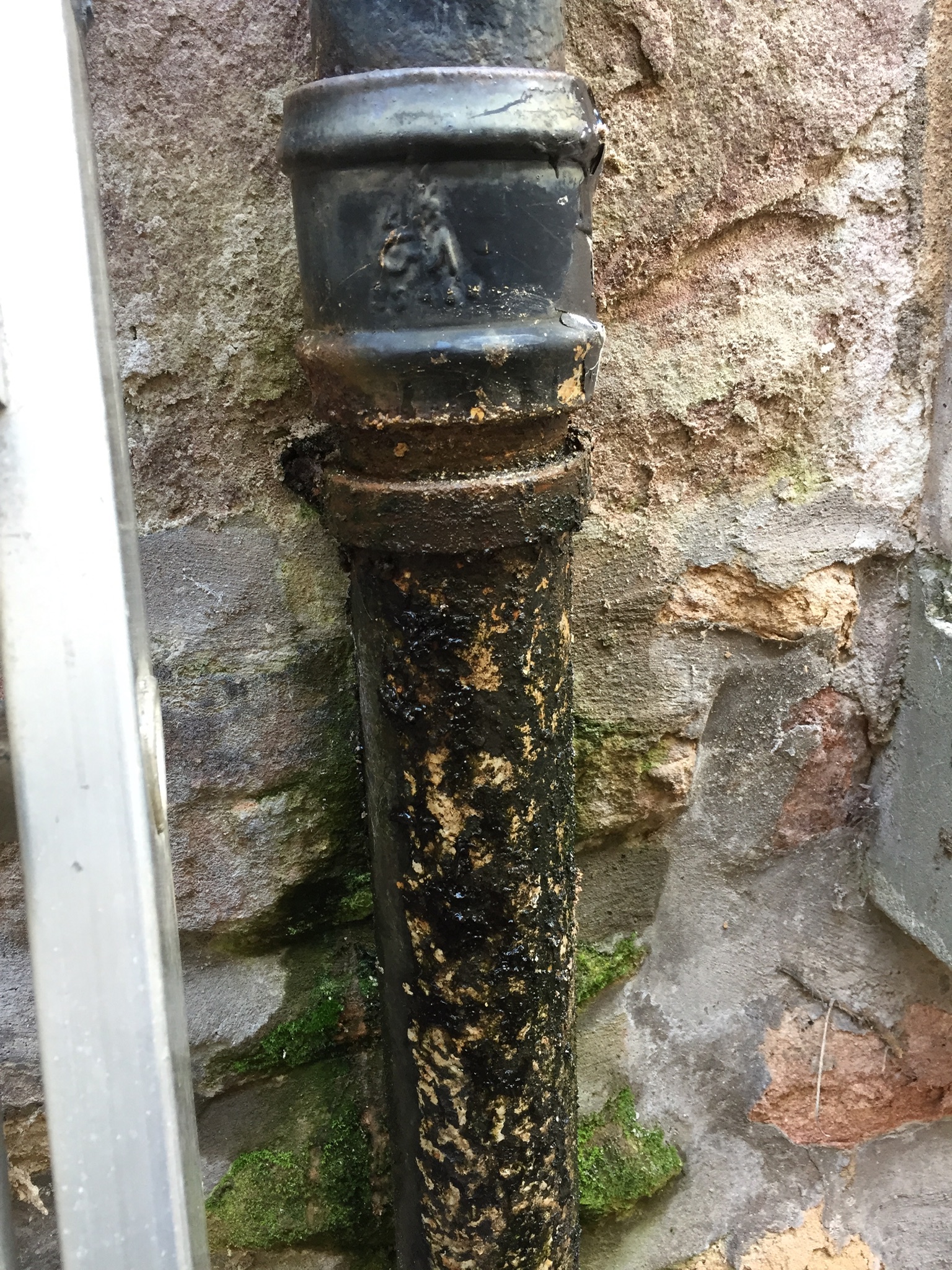

They are hold fast fixing rather than lugs as per attached pic. I was tempted to reside this section as it is ok just the socket is split on the end, can I cut it off and replace with a loose socket with spigot? Or am I aswell just replacing the length while I’ve got it all off!

Just looked at the photos again are they loose sockets or actually part of the pipe length ? it looks like the water is running out all the way round the socket suggesting its a loose socket if so it could just be the rubbers. I seem to remember that you also had to seal the gaps with a mastic & paint over on one of the systems, might just need that.

The socket is actually split and when I poked around it it is like a different part that is attached to a staight length, definitely not cast with the length anyway, a loos socket would fit inside the pipe, this is around it and the pipe goes up inside??? So two lengths have cracks around 4 feet long and one has this issue, builing renovated in 1995 and all was replaced then. So much for the 100year lifespan!

Pipes successfully installed, only took about an hour. The old pipes the sockets were separate to the length of pipe, water had got in and split the socket. The new stuff seemed to be cast as one.

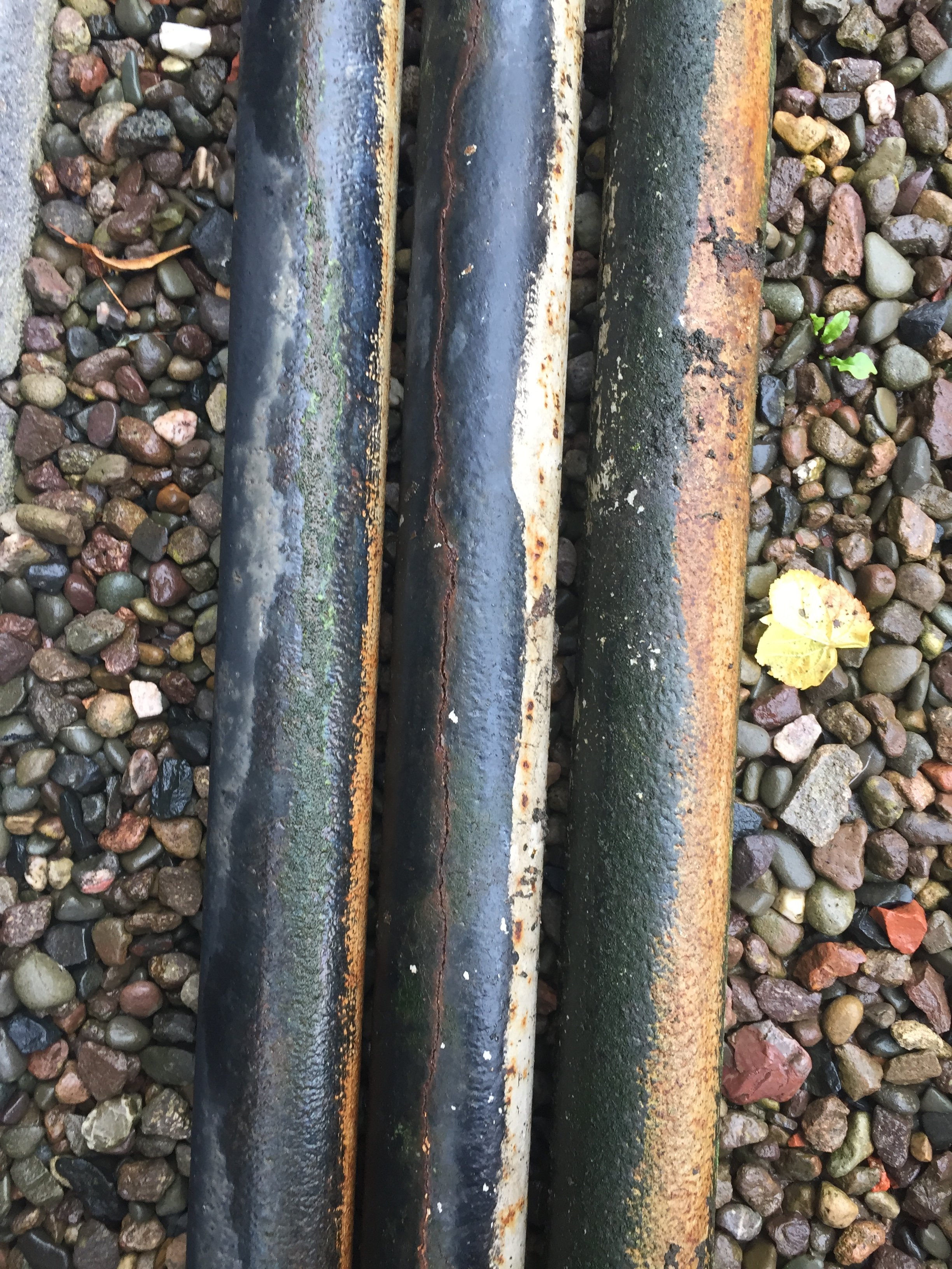

No blockages so unsure why 2 sections split right up the side.

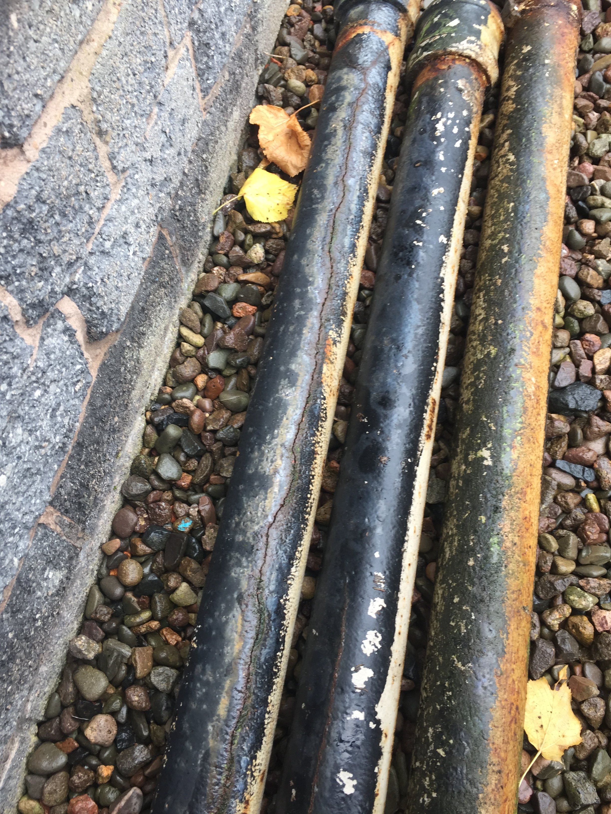

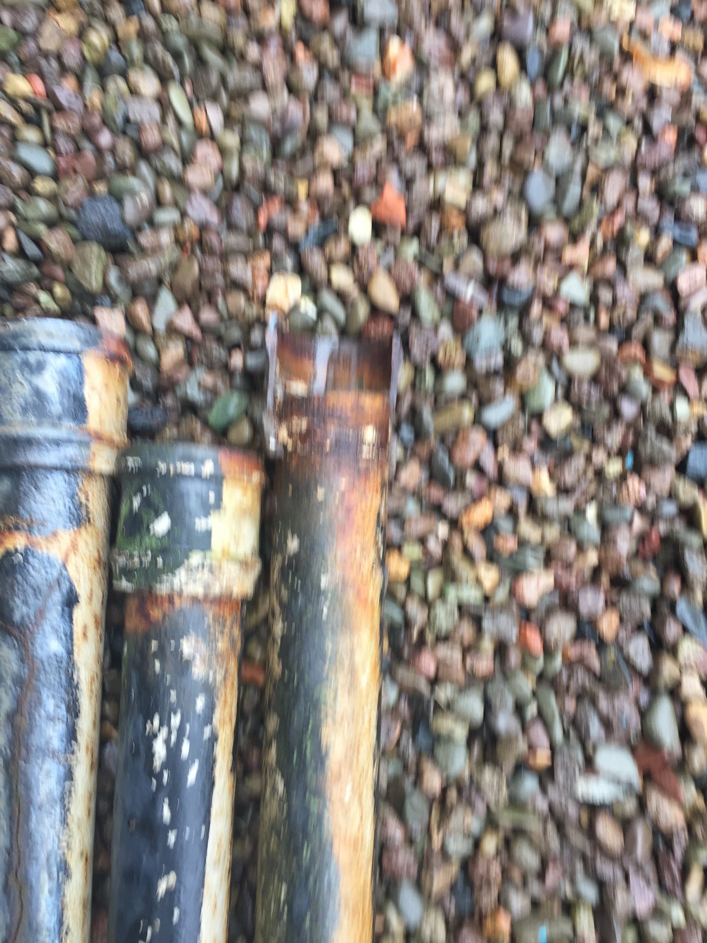

When I ordered the pipe I went for the ready finished black instead of primed only, I’m just wondering how long this factory coating will last. Manufacturer was hargreaves-foundry. Close ups of the cracked pipes
