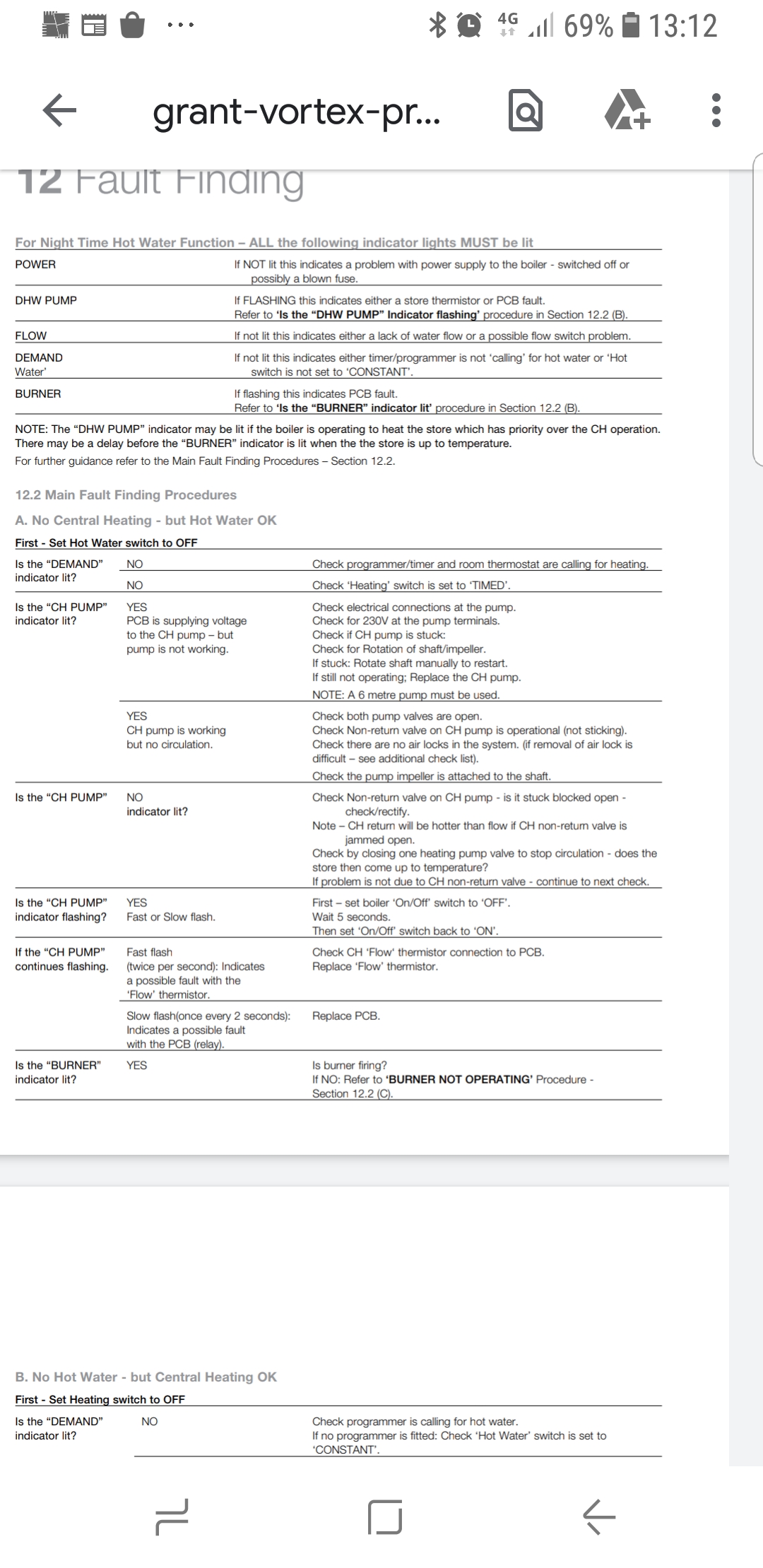

Getting the system to work by draining and refilling is irrelevant. You've changed the pump but is it actually working? Follow these steps in the fault finding which should give you a better understanding of what to look for.
