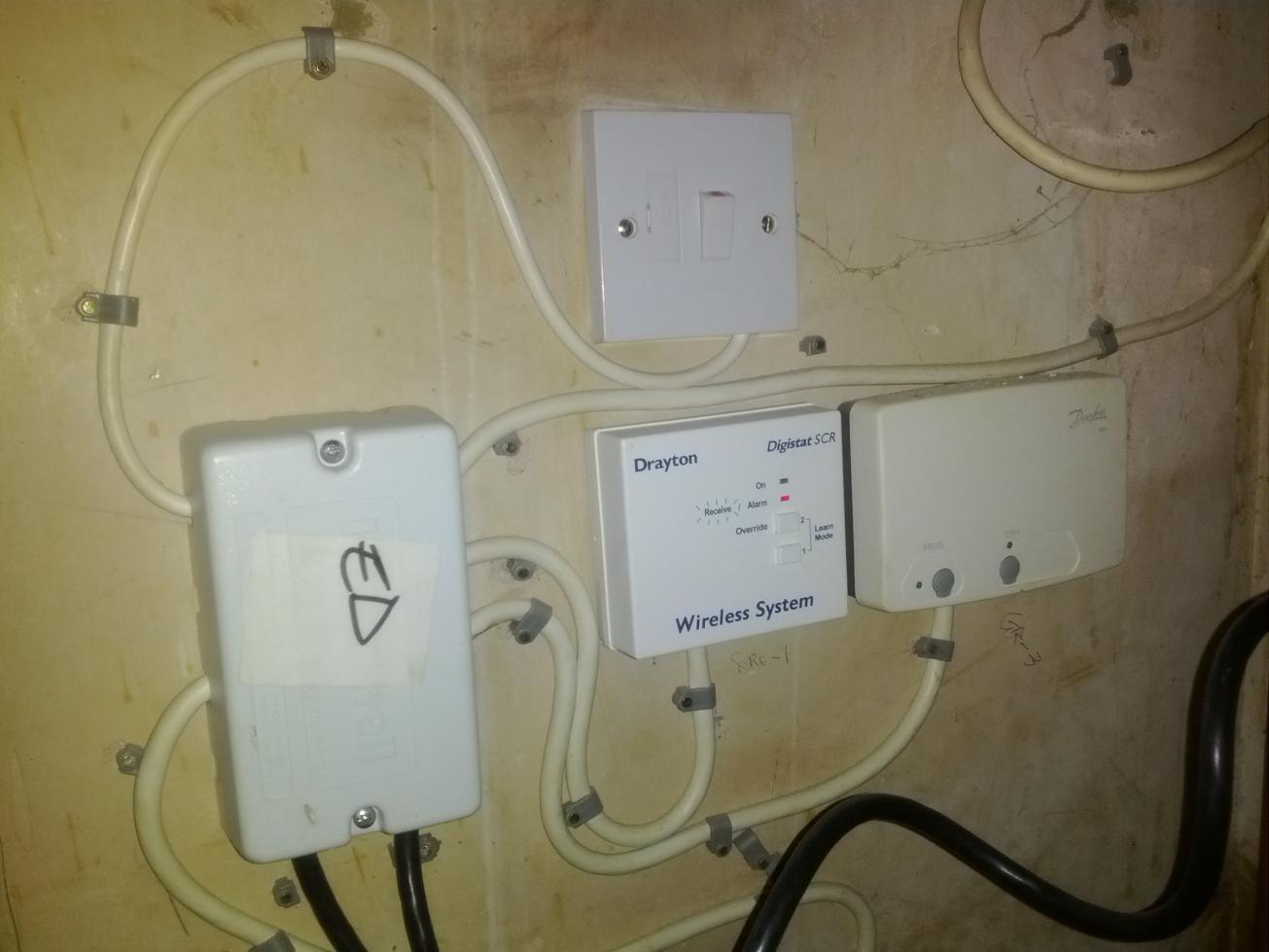

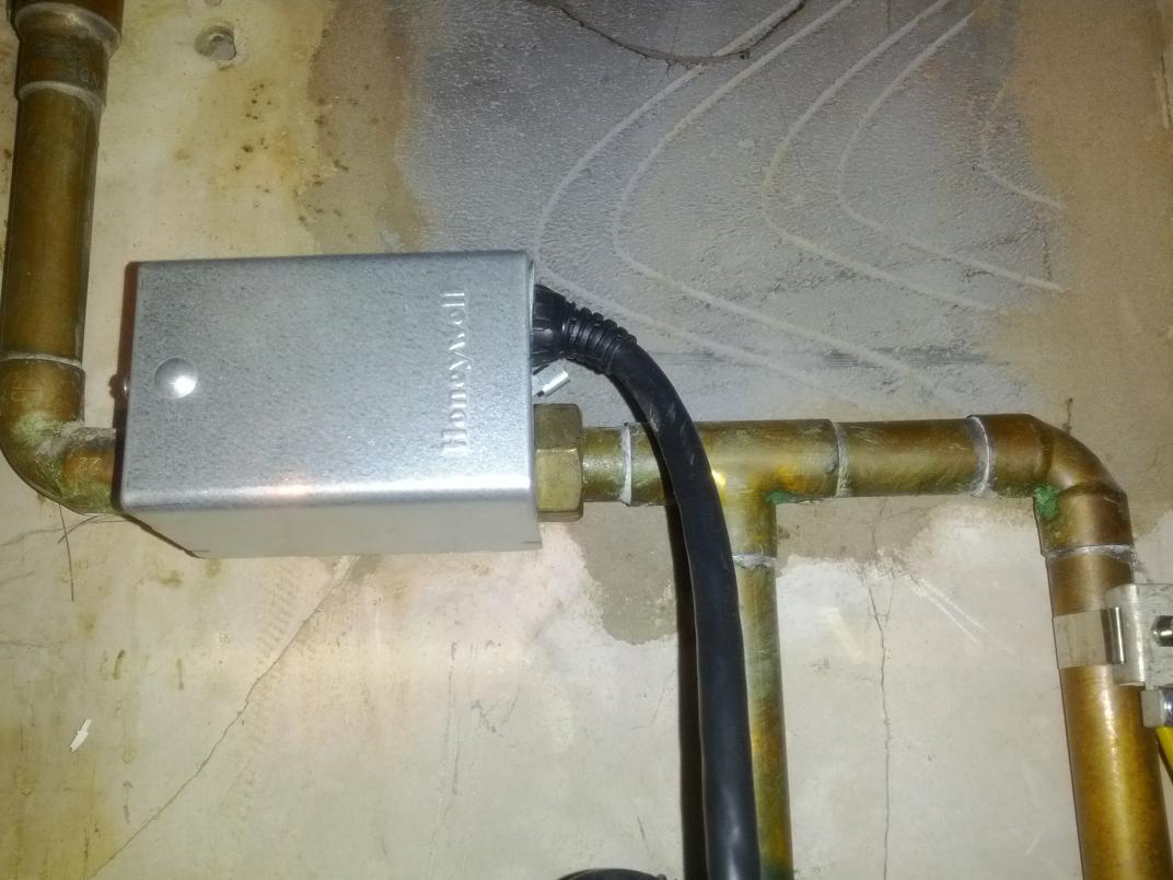

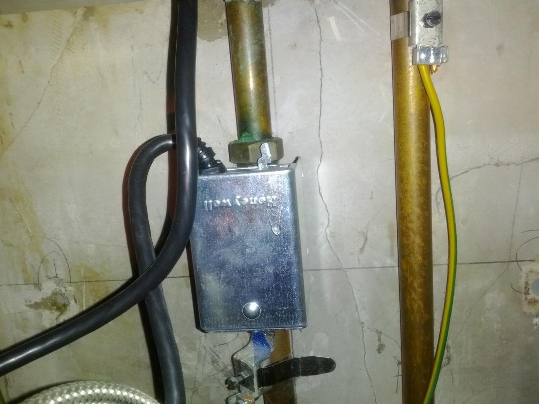

Hopefully these pictures may help in some way.

I have also just noticed a slow drip leak coming from the left bit of the valve that you can see in the last picture...:sick: ...if that would make any difference.

I would say if they only changed the heads of the valves that is proberbly the problem mr towers. I can't imagine its the programmer/ time clock?
Is it likely that they would just go again that quick after being replaced? Are you saying that they just need replacing again...or are you saying the whole valve needs doing? I am guessing they would have a warranty???
Hi see you have got a Drayton R/F unit, is this a timer and room stat all in one unit ? try replaceing the batterys in the transmiter, also if main power was switched off the unit will need resetting or else they will-not talk to each other, you will find this information in your user book for timer.
Hi jts,
I don't even know what you mean by room stat. Do you mean thermostat? In which case I think it is.
Unfortunately I am not very technical and only use it....:sick: press buttons when required etc etc
I would hope that what you suggest, the plumber has done himself. But I will try and check in the morning.
Thanks again...D_T
Hi again, yes i mean a thermostat, have you got a seperate time control ? or is it a all in the one unit ? they must have switched off power to change power heads , when this happens the radio link from transmiter (the part you use) and recever the part on wall with green & red lights is broken, then you need to get them to talk to eachother again, if you have got the user book it will tell what you need to do . Best of luck. JTS
in the white box in the middle where it says wireless stat , you have the red light on .
pls pres and hold 1 and two this will make wireless conection to your stat and will activeate the green light on the very same unit ,if not sure pls download manual for your programer
It does sound more like a time control or thermostat problem to me. It would be highly unlikely the actuators on the zone valves would fail after such a short time.
I don't think they are an all in one unit now actually. There is a separate thermostat in a different room.
in the white box in the middle where it says wireless stat , you have the red light on.
The green light is already on and the red "Alarm" light is flashing. Do you still think I should press and hold the two buttons even though the green light is already on.
Also now noticed that on the silver box (actuator?) the override switch has no resistance at all on it. Is this indicative of anything???
