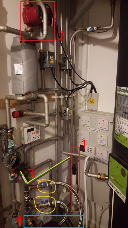

Hello,
I am a homeowner and new here. I have a mysterious (for me) issue related to my house plumbing system. Recently (a few months ago) I noticed that there is a constant stream of water in waste drain pipe of my plumbing system. The stream of water in the waste drain pipe only stops when I close the mains. In the last few months, my water bill has jumped up significantly. I am unable to understand why is there so much water running through the waste drain pipe when, no taps are being used in the house.
Below, I have attached a picture of my plumbing system highlighting a few points
1. The waste drain pipe which has a constant stream of water, regardless of usage in the house
2. Grundfos Selectric UPS2 15-50/60 130 pump. This used to be on, with a control switch. I have not seen it on for months now. Not sure if this is related to the issue in point 1
3. Pipe through which I can feel the water flow to the waste drain pipe
4. Water software in my plumbing system so all the water to the house flows through the water softener.
I would like to know why is this happening? I hope someone can point me into the right direction so that I know what to investigate.
Thank you for your help.
Andy

Following on from Frelon, my softener had a depth gauge measuring from the base of the tank. The guage was held in place in a plastic catch. It had become loose and had risen so that the fill level was above the waste out point.
Looks like you have a water softener. If so has someone turned off the power to it? If so it can stick in regeneration mode and constantly back wash. This will cause what you are hearing.
To confirm turn one of the isolating valves circled in the post above this .
Many water softeners do not need a power supply (twin tank models), so this is a red herring! You need to isolate the softener by doing what I suggested earlier. Of course this is assuming the brine from the regeneration process is passing through your problem waste pipe. We need to confirm that the softener is not stuck in regeneration.
Hello All
Thank you for the interest. No, I haven't found the solution yet. I was due to go on holiday when I posted here and didn't want to touch plumbing before leaving for holidays.
I have - however - ascertained that the water flows through even when running directly through mains - no water softener involved. (Just FYI - my water softener does require power supply) and yes, I was using quite a lot of salt because all water was just passing through the water softener and down the tundish.
Got back a couple of weeks ago and this weekend I tried to disconnect the lower Callefi valve pipe that runs through to the tundish, and turned mains on. And the water was rushing straight through the Callefi valve into the bucket.
So I believe it's the lower Callefi valve that's the problem? Is that the only problem or do you think there could be something else? Also I don't understand how it could just fail without any reason? Is there a way to 'reset' it?
