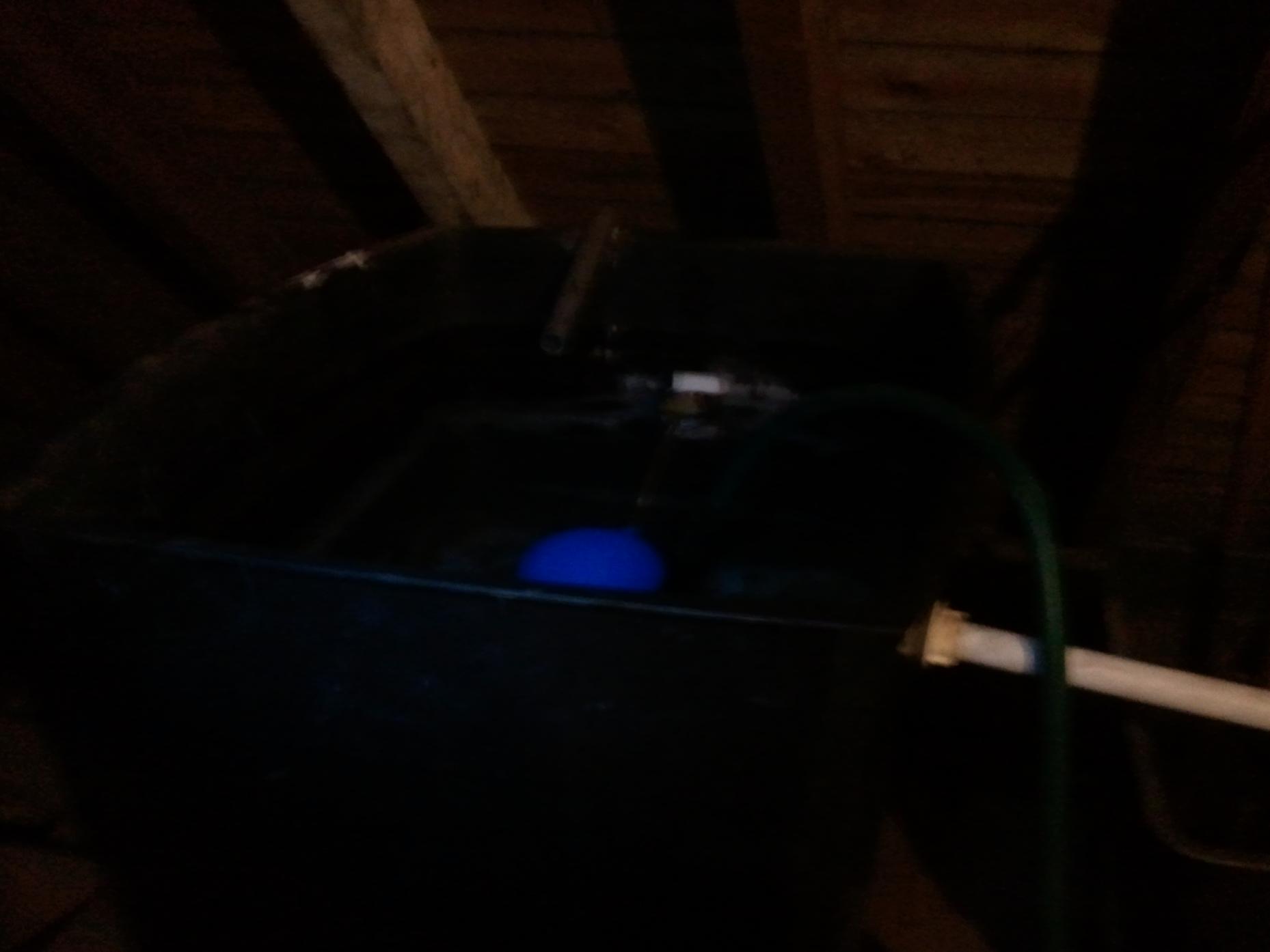

When you isolated the cold feed to the CWS tank, did you do this from the main incoming stop tap or is there a seperate one for the tank? Will be best to use the main incoming stop tap & leave an outside tap open! I'm clutching at straws but possible the stop tap is passing! Can you get some pics of the roof tanks!
If it was the coil, the water would be coming out of the CF&E tank overflow!!
I'm going back round tomorrow, I'll take some pics. I was going to fit an iso valve before the float valve in case the stop tap for the CWs is letting by
2011-03-21 15.53.15.jpg2011-03-21 15.53.20.jpg2011-03-21 15.53.38.jpg2011-03-21 15.53.49.jpg2011-03-21 15.53.28.jpgOK, I've been back round, overflowing again I am certain the new float valve is fine as is the stop tap, i have noticed however that the vent pipe is damp.....curious as the HW & CH is & has been switched off!? Apologies for the poor qualities of the pics,taken on my mobile as i forgot my camera

I was draining some water off. A friend of mine has suggested that the vent pipe is to low, so I shall be raising it up a few inches in the next few days.
