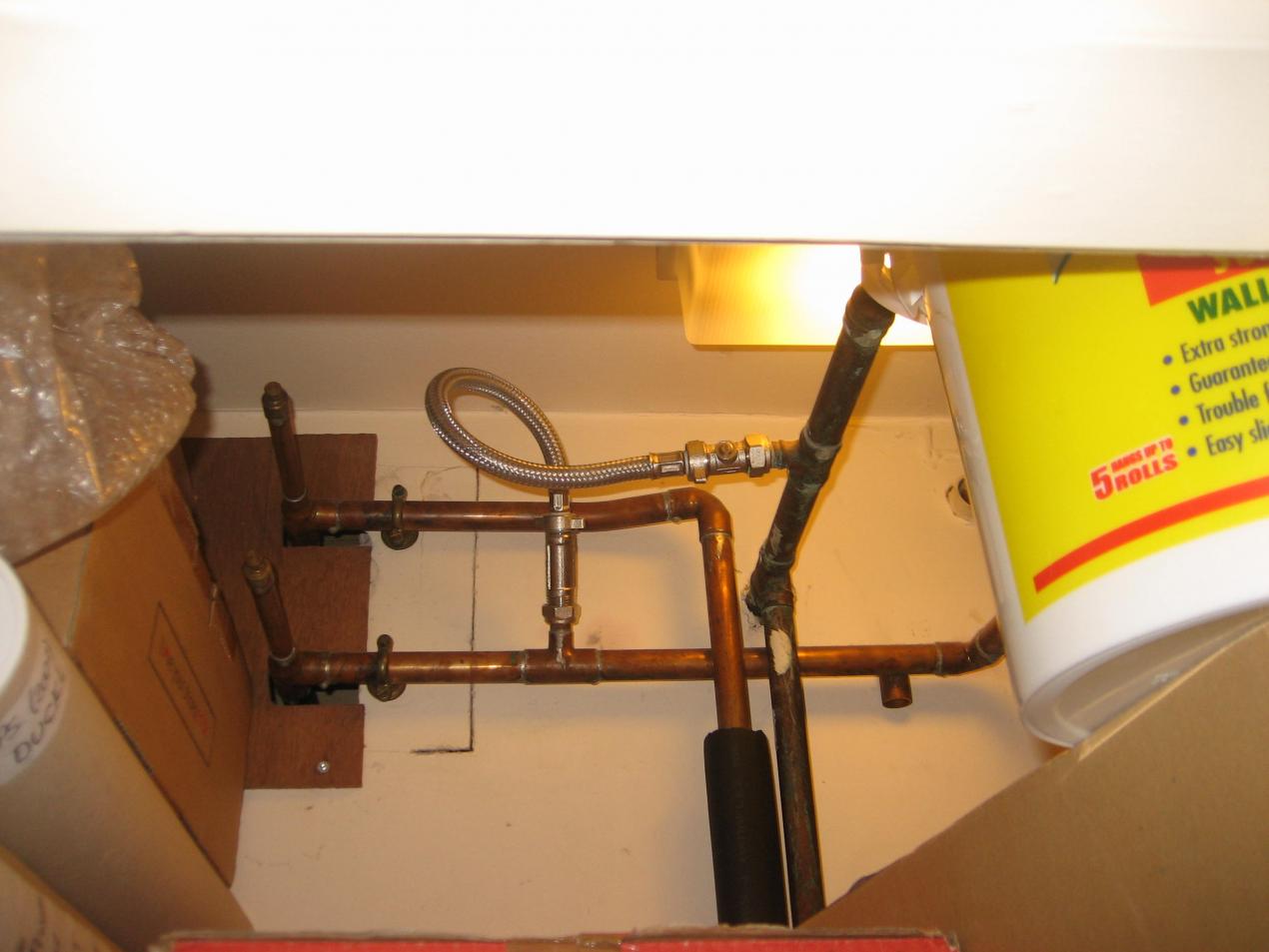

I have only found two examples of this hose in my flat. The first looks like it's piping the water to the taps in the kitchen sink. The second is in this picture and it is in a separate cupboard two doors away which houses the hot and cold water tanks. It doesn't have an easy to open/close valve like the one above.

That is it.
Get someone to watch the guage at the boiler as you top it up by turning the screw at the right side. Slot in line with the pipe is on and across the pipe off. You don't need to turn it full on, just a wee bit. Remember to turn it back off again.
This is the one. get someone to help you. You turn on valve slowly and yr mate shout stop when gauge gets to 1 bar

That is it.
