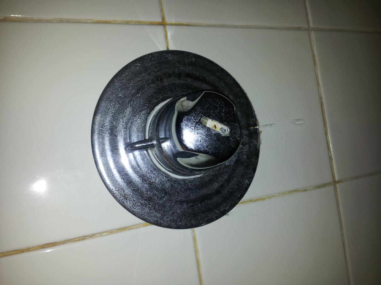

Hi chaps,
a mate of mine has asked me to fix the leak on his shower mixer controls. I don't recognise the model. No evidence of manufacturer or anything (the part which I assume used to feature the logo is missing)
Does anyone know who makes it?
I don't want to go taking it apart, making the leak worse and then finding I've no idea who to order the replacement seals etc from...
Thanks!
Looks similar to this. its a aqualisa aquavalve and the model of this one is 700-c
if you buy an aqua valve cartridge they fit all of the models old and new anyway

aqualisa aquavalve ,take the center screw out pull off the knob sometimes is a bit tight as on a oring. take note of the colour of the ring on cartridge prob grey buy replacement anywhere really.
