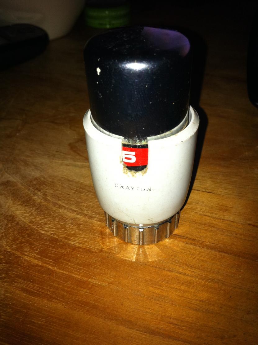

Hi, Could anyone tell me if there is a direct replacement for this Drayton radiator thermostat please? Just the head if poss. 2IMG_1245.jpg Thanks in advance.
Yes there is, its called the Drayton TRV4. you can buy just the head, but probably just as easy to buy the whole valve. They're widely available.
Are you sure its the head thats a problem? Valve seating sticking is quite regular. Tap the pin, it may spring back.
