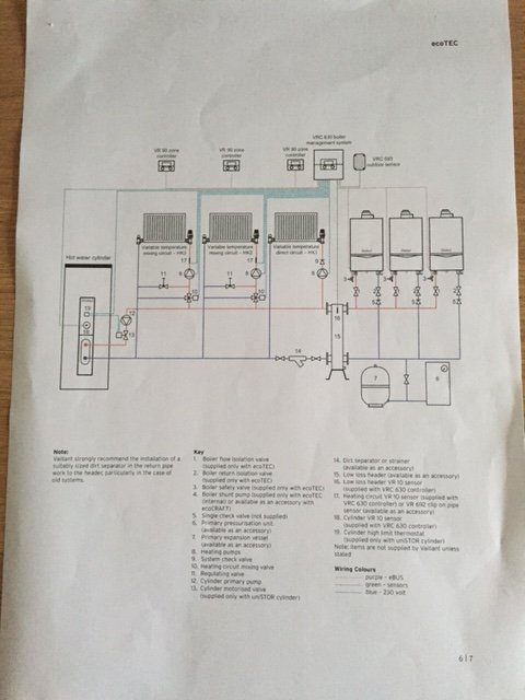

The boilers are linked before connecting to the low loss header and each boiler has a non-return valve on it's return as per MI's, see attached schematic from both Glow Worm & Vaillant.
should be separately and should be swing check valves
You cannot connect each boiler separately to a "Vaillant WH95" low loss header.
They are made with 2" BSP flow and return connections and are intended for multiple boilers to be linked via a common flow and return before connecting to them.
No I mean the swing checks should be separate not the connections to the llh
