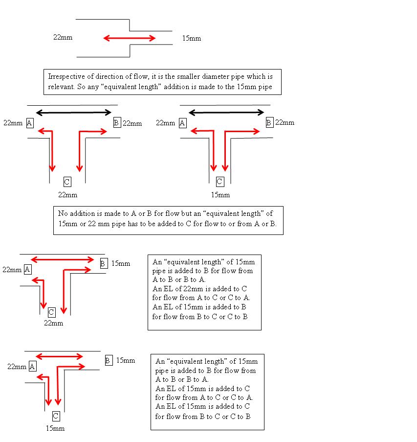

However the most elusive information of the equivalent pipe length method appears to be the unequal fittings (reductions and expansions) and how it is applied.
You may find [DLMURL]http://udel.edu/~inamdar/EGTE215/Minor_loss.pdf[/DLMURL] useful reading.
Lets assume a straight pipe of one meter with a diameter 22mm connecting to a one meter straight pipe with a diameter of 10mm with a reduction fitting. Now if we assume the fitting adds one meter of pipe.
However, which diameter? Or in other words, do you have 'two' meters of 22mm and one 10mm or one meter of 22mm and 'two' meters of 10mm?
My reading of the link above makes me think that the extra metre is always added to the smaller diameter.
This of course also applies to unequal Tee fittings. For example an unequal Tee fitting connects 22mm through the branch to another 22mm and through the run to a 15mm (all one meter long). Now assume one meter is added through the 22-22mm and 1.5 meter for the 22-15mm run.
I think what I said above will still apply. If you have 22mm on both "straight through" branches and 15mm on the side branch, then there is no addition for the 22mm straight through flow and the appropriate equivalent added for the 15mm branch.
But if the reduction is on the straight run, you have to allow for both the reduction (22mm to 15mm) and for the bend (22mm to 22mm).

Hi Doitmyself,
Thank you for your reply.
I'll have a look at the pdf file link and your attachment does seem to answer one of my main issues.
Can I ask where you where you found this?
Regards
The attachment is my own creation, based on the pdf link and on the fact that you only have to make allowances for flow "round the bend" on T pieces.
The only one I am not sure about is the flow between B and C in the last example. I can produce a good argument for adding the "equivalent length" to both, depending on which direction the flow is going!
